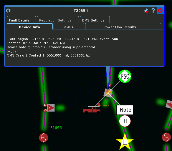

Displaying Device Details
Device Details provides information about devices selected in the Viewer. Device Details is enabled by clicking the Device Details button (Icon used to toggle the details balloon on and off.) in the Viewer's toolbar or by right-clicking a device and selecting Device Details... from the context menu.
Screen capture showing device details for a selected outaged transformer.
Note: The Viewer's Device Details button is highlighted when enabled.
When Device Details is enabled, selecting a device will automatically launch a balloon-style callout window attached to the device in the Viewer. Selecting a different device will close the first window and open a window for the newly selected device. To keep a window open, you may pin it by clicking the pin button (Icon of thumbtack that pins the details balloon open.). You may unpin the window by clicking the unpin button (Icon showing a thumbtack that will unpin the balloon.) or close it by clicking the close button (). Device Details windows may be dragged to a different location in the Viewer or resized.
The Device Details tabbed data views provide relevant information based on the object selected. Data is refreshed whenever you select a different tab, but you may manually refresh the data by clicking the refresh button (). Click the Help button () to display help for the active tab.
The Device Details tabs provide the following information:
