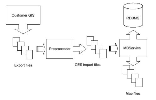

Model Build is a process of steps that will generate an operational topological representation of client’s existing GIS. A single segment of data (partition) passes through four stages during its incorporation into the Operations Model:
• Model Build (MB Service)
The following figure provides an overview of the model build process:
Extraction
The graphical representations of objects that will be modeled, along with the associated attributes, are grouped and exported into external files in a format that the preprocessor is capable of reading. It is at this stage that the partitioning of the model into geographic grids or schematic diagrams is typically determined. These partition file names must match the partition name, as identified within the file, with the requisite file extension.
Preprocessing
The preprocessor reads the files generated by the extraction process and constructs an Import file which models the extracted portion. The preprocessor tends to be a major development task, taking weeks or months to complete.
Model Build
The Model Build (or MB Service) parses the Import file, verifies basic model consistency, applies the contained changes to the Operations Model Database, and commits the changes as part of the final model.
Completed Operations Model
The completed model consists of new or updated partitions and new or revised entries within the core model database schema.

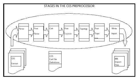

Model Preprocessor
The preprocessor reads (parses) the files generated by the extraction process and constructs an import file that accurately models the extracted portion. The end result of completing a preprocessor is a script that is capable of accepting customer source GIS data files and generating import files.
The Model Preprocessor can be broken into individual stages called: Parse, Post Parse, Cell Explosion, Post Explode, Topology Construction, Post Topology, and Model Build Import file generation.
The following figure illustrates the stages in the preprocessor:
Parse Stage
The Parser reads the client GIS model from external files created by the Extraction process into a data structure known as an Entity Set. After this phase is completed, the resulting Entity Set will be a ‘skeleton’ for the complete model. The activities completed in this stage are not client specific; it will be more specific to a standard data file format (e.g., AutoCAD’s DXF format, Intergraph’s ISFF format, etc.). Each individual graphical object (e.g., point, line, or text) will be represented in an output file.
• Post Parse: Client specific processing that is used to accommodate any modification of the data that may be required prior to Cell Explosion.
• Cell Explosion: Cell explosion is the central phase of preprocessing. It is here that the conversion of the raw graphical objects to model objects is accomplished. The graphical objects are mapped to objects, which will appear in client’s final model.
• Post Explode: Allows for client specific processing after Cell Explosion.
• Topology Construction: The inter-device connectivity for all electrical objects is constructed in this stage. The connectivity can either be explicit (i.e. ‘To’ and ‘From’ node identifiers) or based on proximity.
• Post Topology: The final opportunity for client specific processing.
• Model Build Import File Generation

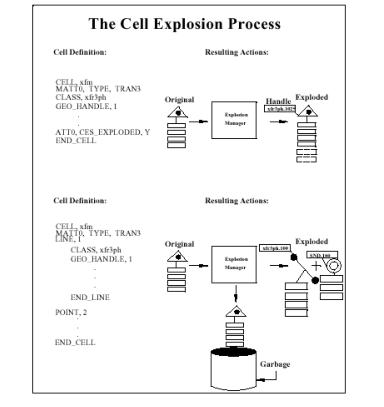

Cell Explosion
The central phase of preprocessing is the conversion of graphical objects into full-fledged model objects; this conversion from a graphical object to a model object can involve a wide range of operations. These operations are specified in a text file [client]_devices.cel, which is called the explosion definition file.
The operations that may be accomplished during this phase include the following:

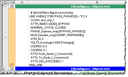

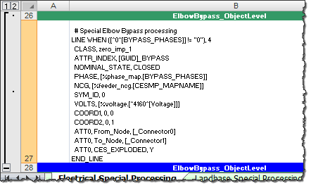

• Handle Assignment: This requires that a graphical entity be mapped to a particular class of model objects (for example, switch, transformer, device annotation, road, water boundary, etc.) and that an index number, unique within that class, be assigned to this object.
• Attribute Manipulation: Attributes can be added, removed or renamed. They can also be assigned new values based upon combinations of other attribute values or the result of mathematical calculations.
• Expansion/Replacement of One Object by Multiple Objects: For example a transformer in the mapping system could be exploded into a transformer with a switch and a network protector.
• Creation of Aggregate Objects: One object may be used to represent a group of objects. For example, a recloser object may in fact represent the recloser along with a by-pass switch, a load switch, and a source switch. All of these component objects may be created and bundled into a single aggregate object during this phase.
• Elimination of Un-Necessary Objects: Any object not explicitly ‘matched’ during this phase will be eliminated; thus, this stage acts as a filter.
• Assignment of Core Properties: For example, phase, nominal status, NCG, and symbology can be assigned as default values for all devices.
• Daughter Object Creation: Creating new entities based upon information taken from an existing object.
• Classification of Objects as Background: Sets the location of an object to a background partition.
• Diagnostic Messaging: Aids in debugging or as a method to configure customer specific error messages with customer defined attributes.
Model objects have handles (class and index), attributes and aliases, geometry, and optionally aggregate object specification, all of which are supported through the explosion preprocessor.
To understand the cell definitions, which specify how an object is recognized and processed during cell explosion, one should understand two fundamental ideas:
1. "Parent" and "daughter" objects
2. String expansion.
Parent and Daughter Objects
Those objects, which enter the cell explosion process from the parser (or the post-parse processing) and which are recognized (or matched) by a definition, are considered to be "parent" objects (or, at least, potential parents); any new graphic objects created by the cell definition which matched the parent are considered "daughter" objects.
There are 4 outcomes for an object after cell explosion:
1. The parent object may pass through and be modified by cell explosion without giving rise to daughter objects.
2. The parent object may pass through cell explosion while giving rise to one or more daughter objects.
3. The parent object may be eliminated by cell explosion yet give rise to daughter objects, which survive and proceed to the succeeding stages.
4. The parent object may be eliminated by cell explosion and not give rise to daughter objects.
Note: Any object that has an attribute named "CES_EXPLODED" with a value of "Y" will pass through this process; all other objects are eliminated.
Commonly, if the parent gives rise to daughter objects, the parent dies, but transfers some of its attributes to the resulting daughters through use of the ATT keyword.
The following illustration depicts outcomes 1 and 2 for an object:

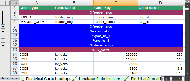

2. Codelist
These can be used to map or convert an input value into the corresponding output value.
• Basic Lookup Table:
To create the "lookup table", we use the CODE keyword. The format for the table is:
CODE, [listname] ,input value, outputvalue.
For example:
CODE, RANK_LIST, E, 1
CODE, RANK_LIST, R, 2
CODE, RANK_LIST, P, 4
Creates a lookup table with three entries or mappings.
(A default code, returned when the given input value is not in the table, can be defined for a list using the DEFAULT_CODE keyword; for example, DEFAULT_CODE, RANK_LIST, 1 means that any input value other than E, R or P results in the output of a "1".)
To actually look up or convert a value, we use the codelist form of string expansion, indicated by a "%".
[%RANK_LIST.[RANK_CODE]]
Will return "1" if the RANK_CODE attribute is "E"; "2" if the RANK_CODE is "R"; and "4" if the RANK_CODE is "P".
• Database Lookup:
This works the same as the basic lookup table but the entries are stored in a database table. There are 2 formats for database lookups:
• DBCODE
The table name (which also serves as the list name), the input column name, and the output column name are defined using the DBCODE keyword. The format for the DBCODE is:
DBCODE, [tablename], [input column], [output column]
For example:
DBCODE, feeder_ncg, feeder_name, ncg_id
Means that there exists a database table called "feeder_ncg" which has an input value column called "feeder_name" and an output value column "ncg_id".
• NAMED_DBCODE
NAMED_DBCODE is similar to DBCODE except it takes a list name that is different from the table name. It is used in cases where there is a need for 2 codelists based on the same database table but with different input and output columns. The format is:
NAMED_DBCODE, [listname], [tablename], [input column], [output column>]
A default code, returned when the given input value is not in the table, can be defined for a list using the DEFAULT_CODE keyword. For example, DEFAULT_CODE, feeder_ncg, 1 means that any input value other than what has been defined results in the output of a "1". Additionally, a special DEFAULT_CODE value can be assigned with the value specified as "--INTEGER_SEQUENTIAL--".
For example:
DEFAULT_CODE, feeder_ncg, --INTEGER_SEQUENTIAL--
Means if a lookup into the table named feeder_ncg does not have a match, the default action will be to select the maximum value of ncg_ids in the table, add one to the ncg_id, and create a new record with the given feeder name and the incremental maximum ncg_id.
Accessing the table is the same as the basic lookup table mentioned above.

• CODE - Defines an entry in a code conversion lookup table. See String Expansion Section.
• DBCODE - Defines an entry in a database table. See String Expansion Section.
• DEFAULT_CODE - Sets default values for codelist. See String Expansion Section.
• INCLUDE - Reads definitions from another file.
INCLUDE, <name of file to include>
INCLUDE, /users/xyz/data/xyz_devices.cel
• NAMED_DBCODE - Allows for definitions of more than one codelist from a single database table.
• TEMPLATE - Uses a template definition.

Format for the Explosion Definition File
Devices are recognized, or ‘matched’, and appropriate manipulations are made based upon the descriptions or definitions contained in an explosion definition text file.
The general format for a single cell definition is as follows:
CELL, [cell-name]
[match-criteria]
[ [parent-object-actions] ]
[ [daughter-object-actions] ]
END_CELL
Remember, any object that has an attribute named "CES_EXPLODED" with a value of "Y" will pass through the explosion process (ATTO, CES_EXPLODE, Y); all other objects are eliminated.

During the Parse phase of the preprocessor, the customer’s raw data files are converted into an internal data structure known as an Entity Set wherein each individual graphical object is represented by an Entity object. Each Entity object is read into the cell file and is processed separately. When creating a cell definition file, to decrease processing time:
1. Place filter cells at the top of the file. For example, cells with nothing but match criteria that will not be exploded.
2. Place cells with most abundant objects near the top of the file. For example, if a file contains 20 switches, 10,000 text objects and 500 transformers, place the text objects first, transformers next, and finally the switches.
3. Place most restrictive criteria cells for objects above general. Overhead transformers should be placed above generic transformers in the cell definition file.

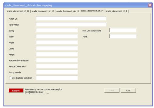

Text Mapping Window
The text-mapping window is to be used for text mapping when the text to be displayed is not included in the data as a separate object. This is true for most attribute based annotation GIS systems. The screen capture below is an example of how a text object can be created for a device class based on the value of an attribute.
Code Lookups
All code lookups to be used in the mapping of the workbook must be specified in their appropriate tab in the workbook. This information is to be entered by the NMS model engineer. Lookups can be database lookups by specifying them as db code lookups in the appropriate CELL file syntax.
Electrical Code Lookups
Contains lookups to be included in the Electrical Layer Objects Cell File.
Landbase Code Lookups
Contains lookups to be included in the Landbase Layer Objects Cell File.
Gas Code Lookups
Contains lookups to be included in the Gas Layer Objects Cell File.
Code Lookups Example
Special Processing Tabs
The Special Processing tabs are arranged according to the cell file they should be included in. A model engineer can use these tabs to add any special CELL file enhancement that cannot be fully generated by the workbook. This includes the addition of nodes such as FBD, FID, SRC, and SND nodes. There are two hooks for each CELL file block generated. One is at the device level, before the end of the first object’s END_LINE or END_POINT). The second is before the cellblock is over, before the END_CELL.
To specify that special processing is required, populate the Special Processing tab in the appropriate class-mapping tab with the display name of the class that requires special processing. The special processing to be used must be specified in a single cell at the appropriate level in the appropriate tab. The level at which this is added is indicated by the name of the special processing section. An example is provided below:
Electrical Special Processing
Special processing for all electrical objects found in sheets, "Devices", "Customer & Service", "Structures", "Annotation" and "Conductors".
Special processing for all land base classes found in sheet "Landbase".
Gas Special Processing
Special processing for all gas mapping sheets.
Special Processing Example

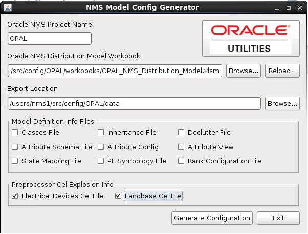

Using the NMS Model Config Generator Tool
The Model Config Generator tool is used to generate model configuration files from a populated Distribution Modeling workbook. The tool is a standalone application that is responsible for reading the modeling workbook, parsing the contents, and generating the desired configuration files.
Generating Model Config Files
1. Make the appropriate changes to the Distribution Modeling Workbook.
2. After the changes are made, open the Model Config Generator Tool by using one of the following methods:
a. On Unix, launch the generator using the following script:
$NMS_BASE/bin/model‑config‑generator
b. To run on a Microsoft Windows PC, your first need to zip the NMS_BASE/bin/ModelConfigGenerator directory by running the following command on a Unix terminal:
zip -ry ModelConfigGenerator.zip $NMS_BASE/bin/ModelConfigGenerator
Then move the zip file to the PC, unzip the file, and then navigate to the ModelConfigGenerator directory, and double-click the ModelConfigGenerator.jar file to launch it (assuming Java is installed).
3. Enter the project name, if it is not populated.
4. Browse to the location of the modified Distribution Model Workbook. The tool will read the workbook into memory. Once fully loaded, the Export Location Browse... button will become sensitized.
Note: If a workbook has previously been opened and the path can still be reached, the tool will automatically select this path and load the workbook to expedite the process.
5. Browse to a location where you want to save the configuration files. Once the path is selected, the check boxes for the configuration files will become sensitized.
Note: If an export path has previously been set, and the path can still be reached, the tool will automatically select this location to expedite the process.
6. Select the files you wish to generate.
7. Click the Generate Configuration button. The Model Config Generator Tool will generate the desired configuration files and create reports for any errors encountered.
8. If updates are made to the workbook, click the Reload... button to force a reload of the newly populated data.

Using the NMS Power Flow Data Generator Tool
The Power Flow Data Generator tool is a tool used to generate engineering data files from a populated Power Flow Engineering Data workbook. The tool is a standalone application that is responsible for reading the workbook, parsing the contents, and generating the desired configuration files.
Generating Data Files
1. Make the appropriate changes to the Power Flow Engineering Data workbook.
2. After the changes are made, open the Power Flow Data Generator Tool by using one of the following methods:
a. On Unix, launch the generator with the following script:
$NMS_BASE/bin/powerflow‑data‑generator
b. To run on a Microsoft Windows PC, your first need to zip the NMS_BASE/bin/PowerFlowDataGenerator directory by running the following command on a Unix terminal:
zip -ry PowerFlowDataGenerator.zip $NMS_BASE/bin/PowerFlowDataGenerator
Then move the zip file to the PC, unzip the file, and then navigate to the PowerFlowDataGenerator directory, and double-click the PowerFlowDataGenerator.jar file to launch it (assuming Java is installed).
4. Browse to the location of the modified Power Flow Engineering Data Workbook. The tool will read the workbook into memory. Once fully loaded, the Export Location field Browse... button will become sensitized.
5. Browse to a location where you want to save the configuration files. Once the path is selected, the configuration file check boxes will become sensitized.
Note: If an export path has previously been set, and the path can still be reached, the tool will automatically select this location to expedite the process..
7. Click the Generate Configuration button to generate the configuration files. The Power Flow Data Generator Tool will generate the desired configuration files and create reports for any errors encountered.
