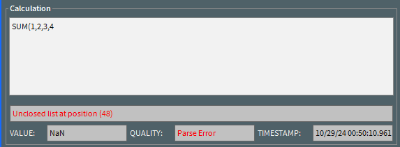

• An unclosed list, the SUM function must enclose its list in brackets SUM()

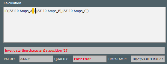

• An invalid character in the calculation definition, in this case £ is an unknown character.

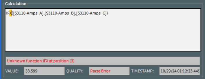

• An unknown function, IFX() is not a supported function in the calculation engine.

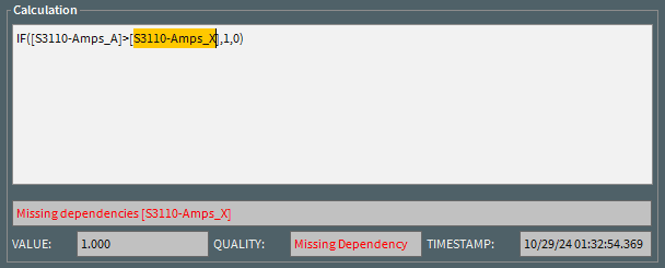

• The calculation containing a missing dependency, measurement S3111-Amps_X does not exist and is a typo for S3111-Amps_B
