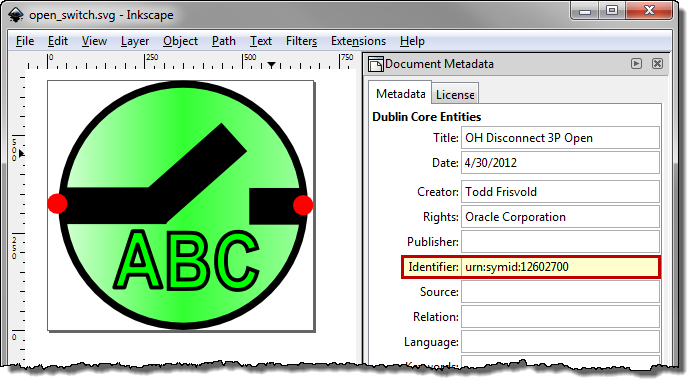

To use SVG symbols, add your .svg symbol files to your $NMS_CONFIG/jconfig/ops/viewer/images directory and add references to them to the $NMS_CONFIG/jconfig/ops/viewer/properties/SVGSymbols.properties file.
The SVGSymbols.properties file maps the SYMBOLOGY_STATE.symbology_id, CONDITION_RULES.symbol_num, ANALOG_RULES.symbol_num, or QUALITY_RULES.symbol_num database symbol numbers to a .svg symbol file. If you use a selection symbol, the symbol will define the complete visualization of the selected symbol and the viewer.selected_color value will have no impact on the selection symbol.

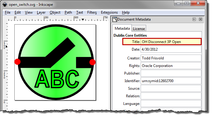

The SVG [title] element is used for hover text when the symbol is visualized in the Viewer.
In InkScape, the title is specified in the Document Metadata panel’s Title field:

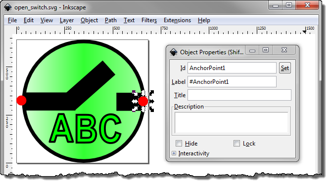

To specify Anchor Points in the .svg file, place a graphic object and use the Id attribute in the Object Properties. Give the anchor points an id value of AnchorPoint1 or AnchorPoint2:
Anchor points can be optionally hidden when drawn in the Viewer by using the Object Fill and Stroke panel and setting the Fill and Stroke Paint Opacity levels to zero. Do not set the Object Properties Hide check box since this will hide the anchor points from the Viewer, which will not know that the anchor points exist.

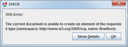

Natively, Inkscape’s text tool adds a non-standard SVG element that is not supported by the Viewer (or any standard SVG viewer). Therefore, when using Inkscape to create SVG symbols with text, you must convert the text with Inkscapes text conversion option.

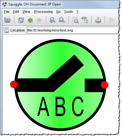

Note: With the non-standard text present, if you save and attempt to open the file with Squiggle, you will receive an error:
4. With the text selected, select Convert to Text from the Text menu.
5. Save the file.
6. Open the file in Squiggle to validate the SVG is a well-formed XML document.

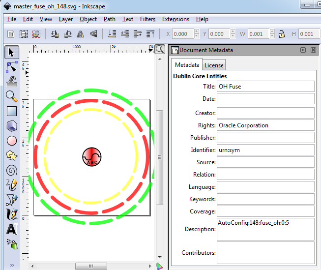

The master symbol .svg file requires the object IDs set as specified by the svg‑symbol‑generator -help information and an additional text string in the master .svg metadata description attribute with the following format:
AutoConfig:[classNumber]:[className]:[tensDigit][:[normalOpenTensDigit]]
These values are passed to the respective svg‑symbol‑generator command parameters (see svg‑symbol‑generator Script on page 8-131).
If the <normallyOpenTensDigit> is specified, autoSvgGenerator executes svg‑symbol‑generator a second time using the [normalOpenTensDigit] value rather than the -tens parameter and, optionally, the ‑normalopen parameter. This will use the inclusion of the symbols object with ObjectID = normal_open_indicator and mixed_status_indicator.
If the -normalopen parameter is not specified on the svg‑symbol‑generator, the ObjectID = normal_open_indicator and mixed_status_indicator will not be included in the resulting symbols.
For example, an overhead fuse (class name: fuse_oh/class number: 148) with a normally open tens digit of 5, would be defined as:
<dc:description>AutoConfig:148:fuse_oh:0:5</dc:description>
