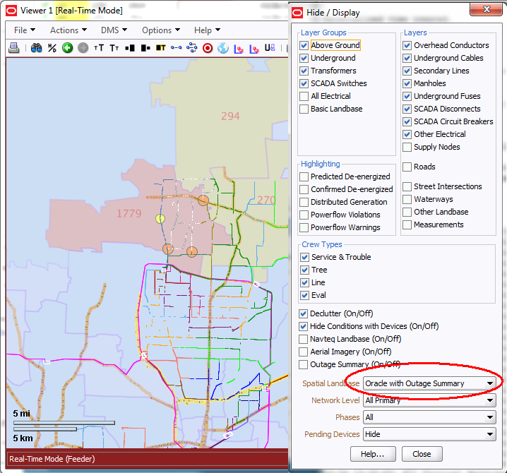

Adding Outage Summary Spatial Landbase to the NMS Viewer
The Viewer has the ability to display Oracle Spatial data behind the Viewer maps:
Prerequisites to supporting this functionality include:
1. Setting up the outage summary spatial tables in the NMS database. (See Preparing the NMS Model for Oracle Utilities Customer Self Service on page 8-168. for details) Oracle Utilities Customer Self (CSS) Service is not required to enable this outage summary in the NMS Viewer, however, the setup of the outage summary spatial table is required.
2. Create an Oracle Spatial MapBuilder Basemap containing and reference map themes (roads, water features, political boundaries) and include the spatial tables from the previous set in themes. In the CSS setup process, you create a GEOGRAPHIC_OUTAGES table for outage location points and GEOGRAPHIC_OUTAGE_AREAS for outage summary by locations (i.e., zip codes, cities, counties,…). You will want to make reference to one or both those tables in your map themes. In the image above, the viewer is showing outage locations as colored and sized dots and it is showing outage zip code areas as shaded polygons and annotating the number of customers out I the middle of the polygon.

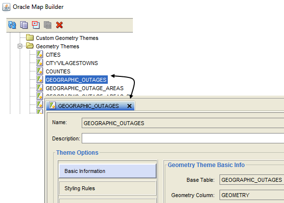

In Map Builder, here is the definition of the GEOGRAPHIC_OUTAGES theme:

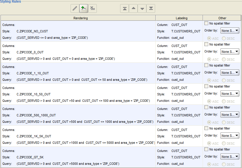

and the style rules to shade the polygons based on the cust_out and to label them with cust_out:

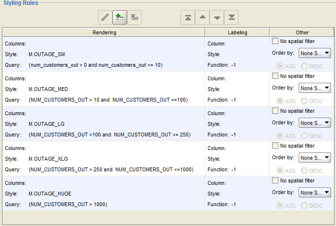

and here is the style rules for dots based on num_customers out:

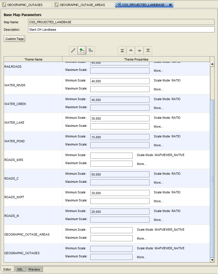

create a Basemap that incorporates one or both of the above themes:
3. Add your Oracle Spatial Basemap to the NMS Viewer Hide/Display configuration. This is described in the section "Oracle Spatial Server Connection - (Optional)" of the Oracle Utilities Network Management System Installation Guide.
