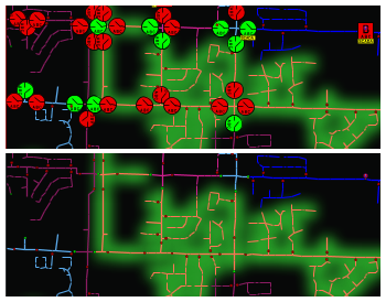

Big Symbols
Allows you to toggle the display of Big Symbols, which are enlarged versions of normal symbology that allow you to see certain device types and conditions when zoomed out. In the following image, Big Symbols are active in the top view and inactive in the bottom view.Two screen captures of the Viewer drawing area with large symbols on the top capture and small symbols on the bottom.
