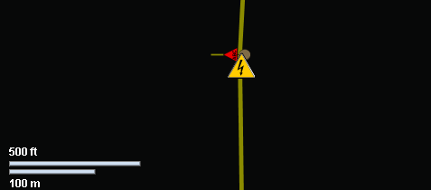

Screen capture of Viewer drawing area showing a fault location.

The Confirmed Fault changes from Diamond shaped symbol with orange X inside. to Diamond shaped symbol with red X inside. in the Viewer. The other Incorrect faults disappear from the Viewer.
