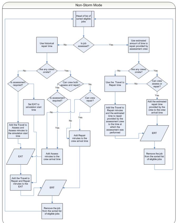

Non-Storm Mode Algorithm
For an event that resides in a control zone that is operating under non-storm mode, the calculation of its estimated assessment and estimated restoration times is as follows:
• Look up the historical average values that pertain to an event with its characteristics.
• Verify whether or not an assessment has already been made for the event (if JOBS.ACT_ASSESS_TIME is non-null).
If assessment has been made:
• The repair time assessment provided (JOBS.EST_REPAIR_MINUTES) will be used in the calculation rather than the historical Repair average.
• Verify whether or not a crew is currently onsite for this event.
• If a crew is onsite:
• Check the crew type to verify whether or not this type of crew is one that can repair this event.
• If crew can repair:
• It is assumed that the crew that's onsite is there to perform the repair. The historical Travel to Repair average will not be used in the calculation. The actual repair time assessment (JOBS.EST_REPAIR_MINUTES) is added to the time at which the crew arrived onsite to generate the estimated restoration time (ERT) for the event.
• If crew cannot repair:
• It is assumed that the onsite crew is there to perform the assessment, and another crew must be sent out to perform the repair. The historical Travel to Repair average and the actual repair time assessment are added to the time at which the repair time assessment was provided (JOBS.ACT_ASSESS_TIME) to generate the estimated restoration time (ERT) for the event.
• If a crew is not onsite:
• The historical Travel to Repair average and the actual repair time assessment are added to the time at which the repair time assessment was provided (JOBS.ACT_ASSESS_TIME) to generate the estimated restoration time (ERT) for the event.
If no assessment has yet been made:
• Check the crew type to verify whether or not this type of crew is one that can both assess and repair this event.
• If the crew type cannot perform both tasks:
• Verify if the crew type can repair this event.
• It is assumed that the crew that's onsite is there to perform the repair. The historical Travel to Repair average will not be used in the calculation. The historical Repair average is added to the time at which the crew arrived onsite to generate the estimated restoration time (ERT) for the event.
• It is assumed that the crew that's onsite is there to perform the assessment. The historical Assess average is added to the time at which the crew arrived onsite to generate the estimated Assessment time (EAT). The historical Travel to Repair and historical Repair averages are added to the estimated Assessment time to generate the estimated restoration time (ERT) for the event.
• If crew type can perform both tasks:
• Verify whether or not assessment is required for this event (if Travel to Assess and Assess averages are both 0, assessment is not required).
• If assessment is not required:
• If assessment is required:
• It is assumed that the crew that's onsite is there to perform the assessment. The historical Assess average is added to the time at which the crew arrived onsite to generate the estimated assessment time (EAT). The historical Travel to Repair and historical Repair averages are added to the estimated assessment time to generate the estimated restoration time (ERT) for the event.
• No estimated assessment time (EAT) needs to be calculated. This historical Travel to Repair and historical Repair averages are added to the simulation to generate the estimated restoration time (ERT) for the event.
• The historical Travel to Assess and historical Assess averages are added to the simulation to generate the estimated assessment time (EAT) for the event. The historical Travel to Repair and historical Repair averages are added to the estimated assessment time to generate the estimated restoration time (ERT) for the event.
Non-Storm Mode Algorithm Flow Chart
Flow chart showing the non-storm mode processes.
In summary, for an event that's in a control zone operating under non-storm mode:
• Estimated assessment time equals:
• The simulation iteration start time.
plus (+)
• The historical average number of minutes it takes an assessment crew to arrive onsite.
plus (+)
• The historical average number of minutes it takes a crew to perform assessment once onsite.
• Estimated restoration time equals:
• The estimated assessment time.
plus (+)+
• The historical average number of minutes it takes a repair crew to arrive onsite.
plus (+)
• The historical average number of minutes it takes a crew to repair once onsite.
Exceptions:
If a crew that can perform assessment is already onsite:
• The time at which the assessment crew arrived onsite
plus (+)
If an event has an actual assessment provided and no repair crew is yet onsite:
• The time at which the actual assessment was provided +
• the historical average number of minutes it takes a repair crew to arrive onsite +
• the actual number of minutes it will take to repair, per the assessment
If an event has an actual assessment provided and a repair crew is already onsite:
• The time at which the repair crew arrived onsite.
plus (+)
• The actual number of minutes it will take to repair, per the assessment.
If an event does not require assessment and no repair crew is yet onsite:
• The time the simulation iteration started.
plus (+)
plus (+)
Note: When the historical averages are applied to the calculation, the average that applies to the conditions at the time the particular step is projected to begin is used, not the average that applies to the conditions at the time the simulation iteration began. For example, Shift A has a particular average value for repair, and Shift B has a different average value for repair. The simulation iteration is in Shift A, but the calculated estimated assessment time falls in Shift B. When calculating the estimated restoration time, the historical average value for repair that pertains to Shift B will be used, not that of Shift A, because the repair isn't projected to begin until sometime during Shift B.

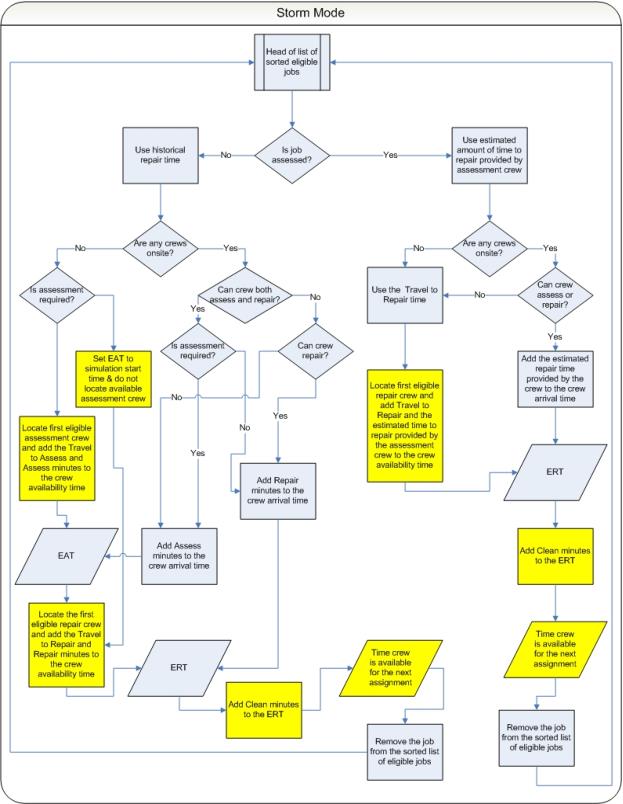

The algorithm for estimate calculation in storm mode is similar to that of non-storm mode, except that in storm mode the data entered into the Crew Information table on the Storm Management window is taken into consideration and used as the known crew resource allocation. At the start of each simulation, the algorithm assembles a crew availability list from the Crew Information table and uses that to keep track of when the next available crews are projected to be ready as the calculation progresses.
For an event that resides in a control zone that is operating under storm mode, the calculation of its estimated assessment and estimated restoration times is as follows:
• It is assumed that the onsite crew is there to perform the assessment, and another crew must be sent out to perform the repair. The historical Travel to Repair average and the actual repair time assessment are added to the time at which the first crew that is eligible to repair this event will become available to generate the estimated restoration time (ERT) for the event
• The historical Travel to Repair average and the actual repair time assessment are added to the time at which the first crew that is eligible to repair this event will become available to generate the estimated restoration time (ERT) for the event. The historical Clean average is added to the ERT and used as the time at which that eligible crew is available to be used for another event in the simulation.
• It is assumed that the crew that's onsite is there to perform the assessment. The historical Assess average is added to the time at which the crew arrived onsite to generate the estimated assessment time (EAT). The historical Travel to Repair and historical Repair averages are added to the time at which the first crew that is eligible to repair this event will become available to generate the estimated restoration time (ERT) for the event. The historical Clean average is added to the ERT and used as the time at which that eligible crew is available to be used for another event in the simulation.
• It is assumed that the crew that's onsite is there to perform the assessment. The historical Assess average is added to the time at which the crew arrived onsite to generate the estimated assessment time (EAT). The historical Travel to Repair and historical Repair averages are added to time at which the first crew that is eligible to repair this event will become available to generate the estimated restoration time (ERT) for the event
• No estimated assessment time (EAT) needs to be calculated. The historical Travel to Repair and historical Repair averages are added to the time at which the first crew that is eligible to repair this event will become available to generate the estimated restoration time (ERT) for the event. The historical Clean average is added to the ERT and used as the time at which that eligible crew is available to be used for another event in the simulation.
• The historical Travel to Assess and historical Assess averages are added to the time at which the first crew that is eligible to assess this event will become available to generate the estimated assessment time (EAT) for the event. The EAT is used as the time at which that eligible assessment crew is available to be used for another event in the simulation. The historical Travel to Repair and historical Repair averages are added to the time at which the first crew that is eligible to repair this event will become available to generate the estimated restoration time (ERT) for the event. The historical Clean average is added to the ERT and used as the time at which that eligible repair crew is available to be used for another event in the simulation.
The yellow boxes indicate where the storm mode algorithm differs from the non-storm mode algorithm.
Diagram showing the storm mode algorithm.
In summary, for an event that's in a control zone operating under storm mode:
• The time the first crew that is eligible to assess the event will become available.
plus (+)
plus (+)
• The time at which the first crew that's eligible to repair the event will become available after the estimated assessment time.
plus (+)
plus (+)
Exceptions:
• The time at which the assessment crew arrived onsite.
plus (+)
• The time at which the first crew that's eligible to repair the event will become available after the actual assessment time
plus (+)
plus (+)
If an event has an actual assessment provided and a repair crew is already onsite.
plus (+)
• The actual number of minutes it will take to repair, per the assessment .
• The time at which the first crew that's eligible to repair the event will become available after the time at which the simulation iteration started.
plus (+)
plus (+)
Notes:
• When the historical averages are applied to the calculation, the average that applies to the conditions at the time the particular step is projected to begin is used, not the average that applies to the conditions at the time the simulation iteration began. For example, Shift A has a particular average value for repair, and Shift B has a different average value for repair. The simulation iteration is in Shift A, but the calculated estimated assessment time falls in Shift B. When calculating the estimated restoration time, the historical average value for repair that pertains to Shift B will be used, not that of Shift A, because the repair isn't projected to begin until sometime during Shift B.
• If the algorithm finds that the calculated estimated assessment time or estimated restoration time would fall beyond the end of the shift of the first eligible crew by more than 60 minutes, it will go back and recalculate the estimate using a different crew other than the one that was originally chosen. The algorithm cannot split work for a single event between multiple shifts of the same crew or between multiple crews. As a consequence, if amount of work required for an event is more than the longest available shift of any crew capable of performing the work then the algorithm will not be able to provide a meaningful ERT for the event. At this point, the algorithm will use "default nominal crew" as a fall back mechanism in order to proceed. This is an artificial crew that can perform any work and not limited by shift restrictions. ERTs generated through use of "default nominal crew" are of no practical value and a warning is written into JMService log file each time this occurs.
