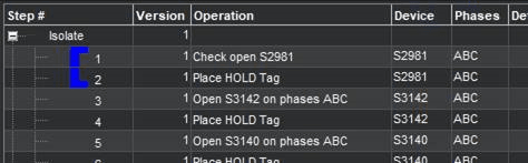

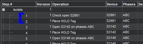

Group steps
Right-click and choose Group Steps from the context menu.
Groups the selected steps and draws a bracket around them in the Steps list. This allows steps to be completed in or out of order within the grouping depending on the switching sheet type. See Grouping Steps. This option is disabled if the sheet is in view only mode or the sheet state is Completed.
Ungroup steps
Right-click and choose Ungroup Steps from the context menu.
Ungroups the selected steps and revises or removes the group bracket. (If you ungroup the third of three steps, the first 2 remain grouped.) See Ungrouping Steps. This option is disabled if the sheet is in view only mode or the sheet state is Completed.

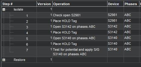

Switching Sheet Step States
Switching sheet steps go through stages or states, just like switching sheets. Step states are described below:
Note: The status of steps that are executed in Study mode is prefixed with a two-character text string. (The default prefix is "ST," but this is configurable during system implementation.) Thus, a step that was completed in real-time mode would display the status "Completed," while a step completed in Study mode would display "ST Completed."
• No state - No action is associated with the step.
• Instructed - The step was instructed.
• Uninstructed - The instructed step was uninstructed.
• Completed - The step was successfully completed.
• Partially Completed - This state applies only to parent aggregate steps and indicates that some but not all child steps were completed.
• Previously Completed - This state occurs when a step is completed, but the device was already in the desired state.
• SCADA Pending - This state applies only to actions that the system identifies as SCADA actions (that is, actions on telemetry-controlled devices). It indicates that a SCADA action was instructed.
Note: If the system detects that the device was operated as instructed, the step state is then changed from SCADA Pending to Completed. If an error or timeout occurs, the step remains in SCADA Pending state.
• Deleted - The step was deleted from the sheet.
• Aborted - The step was marked as aborted by the user. (A step transitions to this state when the user selects the Abort option on the Steps toolbar.)
• Failed - The step was marked as failed by the user. (A step transitions to this state when the user selects the Fail option on the Steps toolbar.) The step can also fall into this state if the step fails to execute during automatic execution of steps within a Optimization or FLISR sheet.
Note that a terminal action (Complete, Delete, Abort or Fail) must have been taken for each of the switching steps before a sheet can be completed.

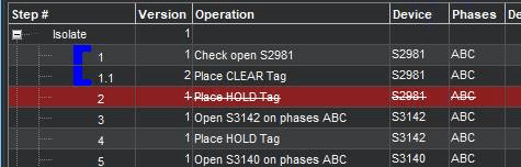

You can copy or cut steps and then paste them to another location within the step list or into another switching sheet. When you cut steps, they are marked as ‘cut' in the steps list and are copied into the clipboard. When you copy steps, they are copied to the clipboard, but the original steps are not marked or removed from the list.
The in-order step execution rules are not enforced when cutting and pasting steps. Switching steps that were previously completed can later be cut and pasted into any location within the step list. This also pertains to cutting and pasting steps from one sheet to another.
If you cut and paste steps from one sheet to another, the system determines which events have associations with these steps and automatically moves the corresponding event/sheet associations from the old sheet to the new sheet. If you attempt to move some but not all of the steps for an event, the system displays a confirmation dialog box indicating the affected events. If you confirm the action, then both the old sheet and the new sheet will have an association to the affected events. Any step moves that affect event associations are recorded in the audit log for tracking purposes.
Follow these steps to use the cut, copy, and paste functions:
1. Select the steps you want to cut or copy.
2. Click the Copy Steps or Cut Steps button (or right-click the selected steps and choose Copy or Cut from the context menu).
3. Select the step after which you want the steps inserted and click the Paste Steps button (or right-click the step and choose Paste from the context menu). Any cut steps are moved, and copied steps are duplicated.

Working with Blocks
Blocks are used to organize steps based on stages of execution. A block is a series of contiguous steps that can include both single (ungrouped) steps and groups of steps. The figure below shows one block that is expanded to display 7 steps and a second block that is collapsed to hide its steps.Screen capture of steps block.
Note the following when working with blocks:
• When you create a new sheet, the system creates an empty block named "Default." When you add steps, they are added to this block by default. You can delete this block and create a new top-level block if you wish.
• The system provides several pre-configured block headers (Isolate, Fault Location, Maintenance, Restore, and Construction); or you can create a custom header. The header is simply the block name that is displayed in the Steps list.
• To expand a block and display its steps, click the + symbol to the left of the block name.
To collapse a block and hide its steps, click the - symbol.
• All steps within a block must be completed before a step within another block can be completed, unless the block names are the same and the blocks are adjacent (not separated by any blocks of different names). See the Parallel Step Execution for more information about parallel execution of block steps.
Adding a New Block Header
To add a new block header to the steps list:
1. From the Steps tab, right-click the step after which you want to insert a block. An option menu appears.
2. Select Add New Block Header, then select a block header type: Isolate, Fault Location, Maintenance, Restore, Construction, or Custom.
Notes:
• If you choose Custom, you are prompted to enter the block header name.
• If the only step row in the steps list is the Default block header row and you add a new block header, then the Default block header row will be replaced with the newly added block header row. This is only the case if there are no other steps in the switching sheet.
A new block header row is added to the steps list.

Grouping and Ungrouping Steps
Step grouping allows a sheet type to enforce in or out of order step execution rules for the steps that are grouped. For Product configured switching sheets, grouped steps exhibit the opposite execution rules that non-grouped steps have. If non-grouped steps can be executed out of order, then the grouped steps have to be executed in order; the opposite is true as well. For more information on how these rules are configured for each sheet type, see Step Order Execution Rules.
The following rules apply when grouping and ungrouping steps:
• Step groupings cannot cross over Block boundaries.
• Step groupings can be removed and altered (ungrouping and regrouping) at any time. Note that this may impact which steps can be completed next based on step completion rules.
This section includes the following topics:
Grouping Steps
To group steps:
1. Select two or more contiguous steps. Remember that the grouping cannot cross Block boundaries.
2. Right-click and select Group Steps from the context menu. A blue bracket appears in the step number column to visually indicate the newly formed grouping, as shown in the following figure:
Screen capture of grouped steps.
Note: Groups cannot span more than one block. If you attempt to group steps that span two or more blocks, the system will create separate groups within each block.
Ungrouping Steps
You can ungroup some or all steps in a group. To ungroup steps:
1. Select one or more steps that are currently part of a group.
2. Click the right mouse button and select Ungroup Steps from the context menu.
The bracket is removed (if all steps were ungrouped) or redrawn to indicate the steps that remain grouped. If the selected steps were in the middle of a grouping, then two new groups are created, and the middle steps are no longer grouped.
Adding Steps to an Existing Group
You can add one or more steps to an existing group as follows:
1. Select the steps you want to add and include at least one step from the existing group.
2. Click the right mouse button and select Group Steps.
The selected steps that were previously ungrouped are added to the existing group.
Grouping Aggregate Steps
An aggregate step is an operation, such as Open and Tag, that comprises two or more sub-steps (numbered a through z). An aggregate step is treated as a single step when grouping and ungrouping steps:
• If you add any sub-step of an aggregate step to a group, then all sub-steps are added to the group.
• If you ungroup any sub-step, then all sub-steps are removed from the group.

Editing Existing Steps
You can rearrange, add, and delete switching steps using options found on the Steps toolbar or from the Steps context menu.
Notes on editing steps:
• You cannot edit steps while the switching sheet is in the Completed state. You will need to transition the switching sheet to the Rework state to edit the steps after the sheet has been completed.
• Some fields on the switching sheet are not editable after a plan has transitioned to a certain set of states. For example, the Instructed Date and Completed Date fields cannot be updated after the step has reached a terminal state (completed, aborted, or failed). Exceptions to this rule apply when the switching sheet is in the Rework state.
• Tabbing out of a cell can only be accomplished if the cell is not set up for word wrapping.
• The Operation, Details, and Comments columns are configured for word wrapping. Word wrapping means the cell height will grow if the text in the field is too long to be displayed within the confines of the cell width.
To edit switching steps, complete these steps:
1. Open the switching sheet and check the status bar to make sure that the switching sheet is in edit mode.
2. Click on the Steps tab.
3. Edit steps as follows:
• To edit the fields in a step, select the row and click in the Operation (for comment or non-operational steps only), Details, Planned Date, Instructed Date, Completed Date, Comments or Address field and change the text.
• To insert a blank step, place your cursor in the row after which you want to insert the step and select the right-click Insert Blank Step option.
• To insert a recorded step, select the right-click Place Step Insertion Indicator option and then perform the action in the Viewer. Steps are inserted after the step that currently has the indicator. To record steps at the end of the steps list, remove the step insertion indicator first.
• To delete a step, select the row for the step you want to delete and click the Delete button. Attempting to delete a step that is in a terminal state will produce an error dialog indicating that the step cannot be deleted.
• To rearrange steps, cut and paste the steps to the desired location.
• You can cut, copy and paste steps from one plan to another. The ability to cut, copy or paste is governed by the sensitivity of the edit options. (The options are disabled if the edit operation is not allowed.)
4. Save the switching sheet by selecting Save Sheet from the File menu.

Step Versioning
Steps also have version numbers. The step version number is the version number of the sheet when the step was added. A step's version number is displayed on the Steps tab to the right of the step number.
• If you add steps to a checked-in switching sheet, the sheet version is automatically incremented and the newly added steps are associated to this new sheet version number. This allows you to easily distinguish between steps that were previously issued to a crew and newly added steps.
• To see the differences between the current version and a previous version, open the version drop-down list on the status bar, then select the version to compare against.
When you select a version, the Step # column uses outline numbering (1.1, 1.2) to identify steps that were added since the previous version.
If you delete a step when the switching sheet version is checked-in or when an earlier version of the step exists, then the step is removed from the current version. If you view a previous version in which the step existed, the deleted step is indicated with strikethrough text and is shaded red. Screen capture of step versions with deleted step having strikethrough text.
