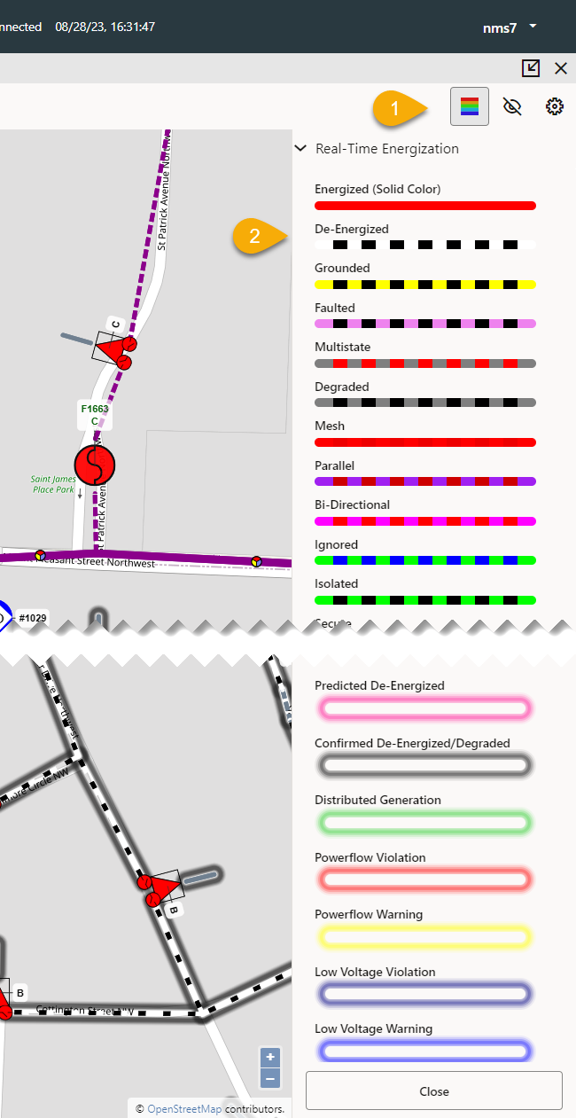

The Map provides visual cues and symbols to represent devices, events, and conditions. For example, the following screen capture depicts [1] an abnormally open switch with a real outage (RO symbol), [2] the resulting de-energized section of the network, [3] a highlighted segment with a Patrolling symbol, and [4] a device patrolled symbol.
You can view conductor and highlight coloring meanings by selecting the "Open the Legend Panel" option [1] on the Map toolbar. The legend slides out from the right side of the Viewer [2].
Screen capture of Map with callouts to sections of the network: yellow conductor signifies a patrolled section, pink signifies the probably/predicted extent of an outage, and gray signifies a de-energized section.

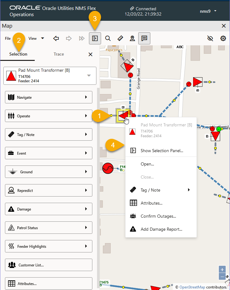

• Show Selection Panel when Item is Selected: When selected, displays the Selection panel for the device. (When deselected the panel is not shown by default, but can be shown by clicking on the Map toolbar or by selecting the same option from the selected device’s right click menu).

• Notes are used to annotate network assets, or can be placed on the Map background.
• Tags can be added and removed by suitably authorized Users.
• Damage Assessments and Patrolling Conditions can also be added and removed by suitably authorized users.

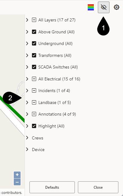

Map Hide/Display Options
The Hide/Display panel allows you to select what devices or map components to show or hide. Select the Hide/Display toolbar button [1] to open the panel [2]. See Hiding and Displaying Viewer Objects for more information.
Illustrated screen capture showing the Hide/Display button activated and the panel displayed.
You can also press Ctrl+Shift+F to open the panel.
The panel is broken down into a number of collapsible sections, with each section containing a number of check‑boxes or radio buttons that control which objects and conditions should be shown on the map. Most of the sections consist entirely of check‑boxes, and for these the entire section can be toggled on/off even when the section is collapsed, using the check‑box in the section's title bar.
The sections represent conceptual groupings of object types and so can have overlapping contents where the same item belongs to several groups, for example "Network Transformers" can be found under "All Layers", "Underground", "Transformers" and "All Electrical". This allows entire groups of related object types to be toggled on/off with a single action.
The settings in this panel can be restored to their configured default values at any time using the "Defaults" button at the bottom of the panel.
The standard product configuration provides the following sections:
• All Layers: This section contains all of the layer based filters.
• Landbase: Toggle the visibility of the landbase (if one is selected in the Settings panel).
• Overhead Conductors: Toggles the visibility of overhead conductors.
• Underground Cables: Toggles the visibility of underground cables.
• Underground Fuses: Toggles the visibility of underground fuses.
• Secondary: Toggles the visibility of the secondary network.
• SCADA Disconnects: Toggles the visibility of SCADA disconnects.
• SCADA Circuit Breakers: Toggles the visibility of SCADA circuit breakers.
• Other SCADA: Toggles the visibility of other SCADA map components which do not have a specific toggle.
• Overhead Transformers: Toggles the visibility of overhead transformers.
• Substation Transformers: Toggles the visibility of substation transformers.
• Network Transformers: Toggles the visibility of network transformers.
• Padmount Transformers: Toggles the visibility of padmount transformers.
• Elbows: Toggles the visibility of elbows.
• Other Electrical: Toggles the visibility of other electrical map components which do not have a specific toggle.
• Supply Nodes: Toggles the visibility of supply nodes.
• Structures: Toggles the visibility of structures such as poles.
• Manholes: Toggles the visibility of manholes.
• Roads: Toggles the visibility of roads modeled in NMS.
• Street Intersections: Toggles the visibility of street intersections modeled in NMS.
• Waterways: Toggles the visibility of waterways modeled in NMS.
• Other Landbase: Toggles the visibility of other landbase elements modeled in NMS that do not have a specific toggle.
• Measurements: Toggles the visibility of digital and analog SCADA measurements.
• Limits: Toggles the visibility of limit data if the Measurements option is selected.
• Show All Calls: Toggles the visibility of all customer calls.
• Show All AMI: Toggles the visibility of all AMI‑related conditions.
• Show FLA By Default: Toggles the visibility of all FLA‑related conditions.
• Show All Damage: Toggles the visibility of damage assessments on devices that are not the main asset of the damage assessment.
• Above Ground: A subset of the "All Layers" section.
• Underground: A subset of the "All Layers" section.
• Transformers: A subset of the "All Layers" section.
• SCADA Switches: A subset of the "All Layers" section.
• All Electrical: A subset of the "All Layers" section.
• Incidents: A subset of the "All Layers" section.
• Landbase: A subset of the "All Layers" section.
• Annotations: Controls the display of various annotations such as labels.
• Conductor Current Phase Markers: Toggles the visibility of the current phase markers on conductors. These indicate the current phase of the conductor using a colored indicator with the colors indicating the phases. Either a single dot for single phase, a circle with 2 colored halves for 2 phase conductors, or a circle broken into 3 colored sections for 3 phase conductors. These will be placed at intervals along the conductors so the phase can be easily determined.
• Condition Labels: Toggles the visibility of labels on certain types of condition, for example events or crews.
• Device Labels: Toggles the visibility of device labels.
• Device Nominal Phase Labels: Toggles the visibility of nominal phase labeling on devices - this indicates the nominal phases and their current energized state, with color highlighting when the phase is in an abnormal state.
• Conductor Nominal Phase Labels: Same as above for conductors.
• Conductor Feeder Labels: Toggles the visibility of labels on conductors which indicate their nominal feeder.
• Flow Direction: Toggles the visibility of electrical flow direction arrows on conductors. This will use power flow analysis if it is enabled on the system.
• Highlight: These options toggle the visibility of highlights on devices and conductors.
• Predicted De-energized: adds a glow around primary conductors that are predicted to be de-energized.
• Predicted Secondary De-energized: adds a glow around secondary conductors that are predicted to be de-energized.
• Confirmed De-energized: adds a glow around primary conductors that are confirmed to be de-energized.
• Confirmed Secondary De-energized: adds a glow around secondary conductors that are confirmed to be de-energized.
• Confirmed Degraded: adds a glow around primary conductors that are confirmed to be degraded.
• Confirmed Secondary Degraded: adds a glow around secondary conductors that are confirmed to be degraded.
• Distributed Generation: adds a glow around conductors fed (or partially fed) by distributed generation.
• Powerflow Violations: adds a glow around devices or conductors that have a power flow violation.
• Powerflow Warnings: adds a glow around devices or conductors that have a power flow warning.
• Voltage Angle Violations: adds a glow around devices or conductors that have a voltage angle violation.
• Assessed: adds a glow around conductors that have been marked as assessed.
• Crews: Controls the visibility of crew symbols.
• Assigned Crews: Controls the visibility of the assigned crews.
• Crew Types: Toggles the visibility of the different crew types configured in the system, for example "Tree Crew" or "Line".
• Device: Options related to device characteristics.
• Network Level: Allows the user to choose between "All Primary", "Backbone and Laterals", "Backbone Only", "SCADA Only" and "Primary and Secondary".
• Phases: Allows the user to choose between "All", "3-Phase Only" and "Multi-Phase".
• Pending Devices: Allows the user to choose to display construction pending, decommissioning conditions and inactive devices.
Note that the Roads, Street Intersections, Waterways, and Other Landbase options toggle visibility of these elements which have been modeled in NMS, not those provided as part of the geographic map landbase.

Selecting and Interacting with Map Objects using the Selection Panel
When you select a device or symbol, it will be highlighted or outlined in yellow [1]. The Selection Panel will be displayed [2] when the Selection Panel icon is toggled on [3]. Device operations are available through right-click context menus [4].
The Selection Panel is a combination tool providing actions and information that are found in multiple tools in the NMS operations client (for example, the Control Tool).
