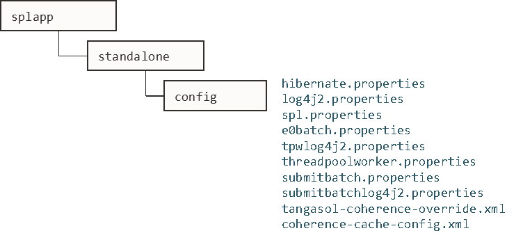

The batch component houses the configuration files differently to the online and web services component. The online and web services are housed within a JEE Web Application Server and therefore the configuration files are located according to the JEE standards.
In the batch component the configuration is housed in directories as the batch component is housed as a standalone process that is clustered using Oracle Coherence. Therefore, during the configuration process, the configuration files used by the batch component are built using templates using the initialSetup utility. This utility deposits the configuration files in the $SPLEBASE\splapp\standalone\config directory. See initialSetup – Maintain Configuration Settings for details.
The figure below summarizes the directory structure and the relevant configuration files:Figure that shows the structure of the batch configuration files.
The following configuration files (along with their templates) are listed below:

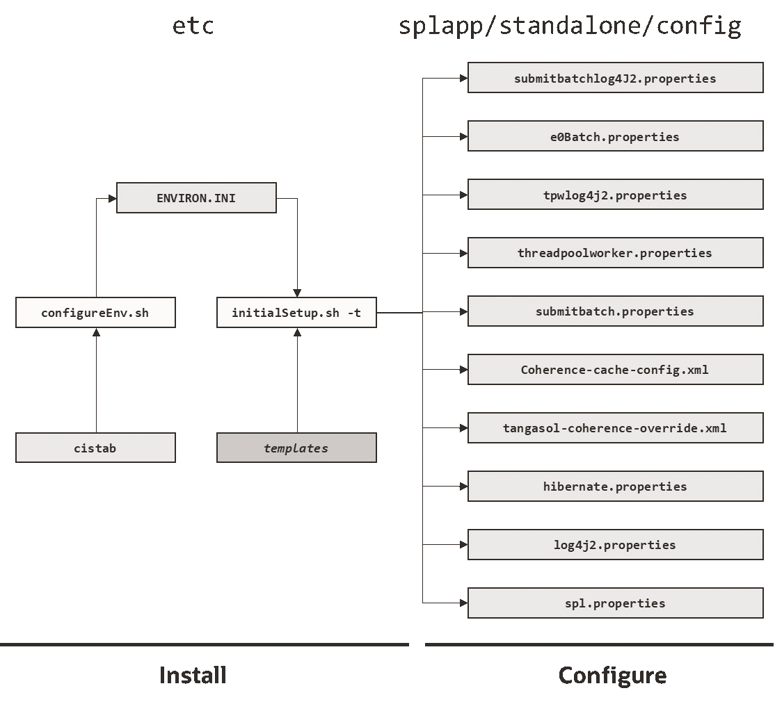

General Configuration Process
To configure the batch component during the installation process and post-installation then the following process should be used:Figure that shows the structure of the batch configuration process.
• The configureEnv utility is used during installation time and can be used post installation to set parameters in the ENVIRON.INI. See configureEnv – Set up Environment Settings for details.
Note: The configureEnv utility should be used to make any changes to the ENVIRON.INI. Manual changes to this configuration file are not recommended.
• After the ENVIRON.INI has been set or altered, the settings must be reflected in the relevant configuration files used by the batch component using the initialSetup utility. The initialSetup utility takes the relevant templates, builds the configuration files and deposits them in the $SPLEBASE\splapp\standalone\config directory. See initialSetup – Maintain Configuration Settings for details.
The configuration files are now ready to be used for the batch component. Additional configuration can be performed using bedit. See Configuring Batch Using Bedit for details.

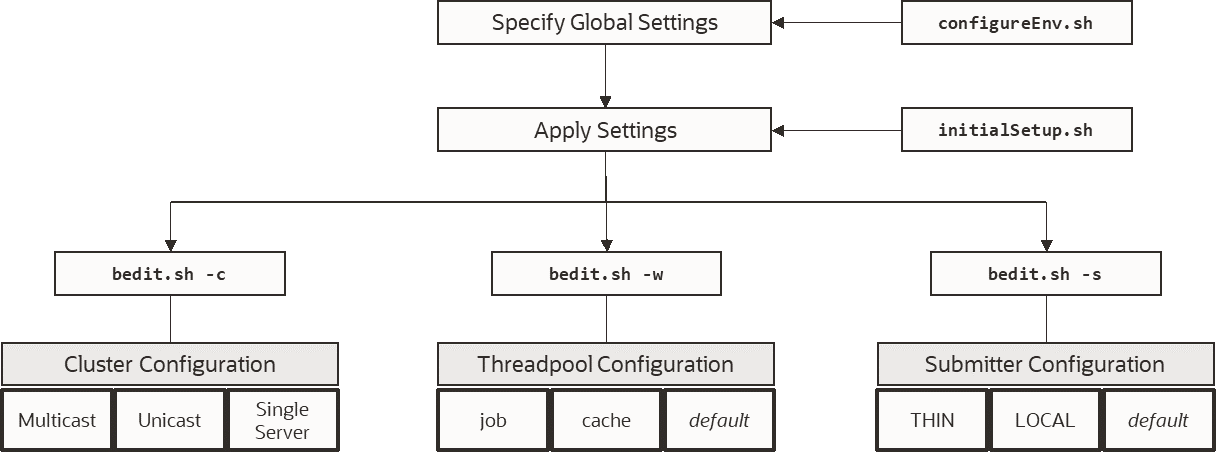

Batch Configuration Overview Using Bedit
The bedit utility allows for a set of configuration files to be built on top of the global configuration setting managed using the Batch Configuration Guidelines. The following process should be used:
• Global Settings - Specify global batch settings using the configureEnv utility to set the defaults in the ENVIRON.INI. See configureEnv – Set up Environment Settings for details.
• Apply Settings - Apply any configuration settings to the global templates and default configuration files using the initialSetup utility. See initialSetup – Maintain Configuration Settings for details.
Note: Use the -t option to allow templates to be rebuilt only. Using other options may affect online.
• Perform Cluster Configuration - Configure the desired cluster configuration using bedit utility. Clusters are set up once per environment in either using multicast, unicast or single server optimized configurations. See Cluster Configuration using bedit for details.
• Perform Threadpoolworker Configuration - Configure the desired threadpoolworker configuration using bedit. Threadpoolworkers can be created on an individual basis with unique configurations or labelled to share configurations. See Threadpoolworker Configuration Using Bedit for details.
• Perform Submitter Configuration - Configure the desired submitter configuration using bedit. Submitters can be set up for specific development execution modes (THIN or LOCAL), generic configuration or project specific jobs. See Submitter Configuration using bedit for details.
The process is shown below:Figure that shows the structure for the bedit configuration process.

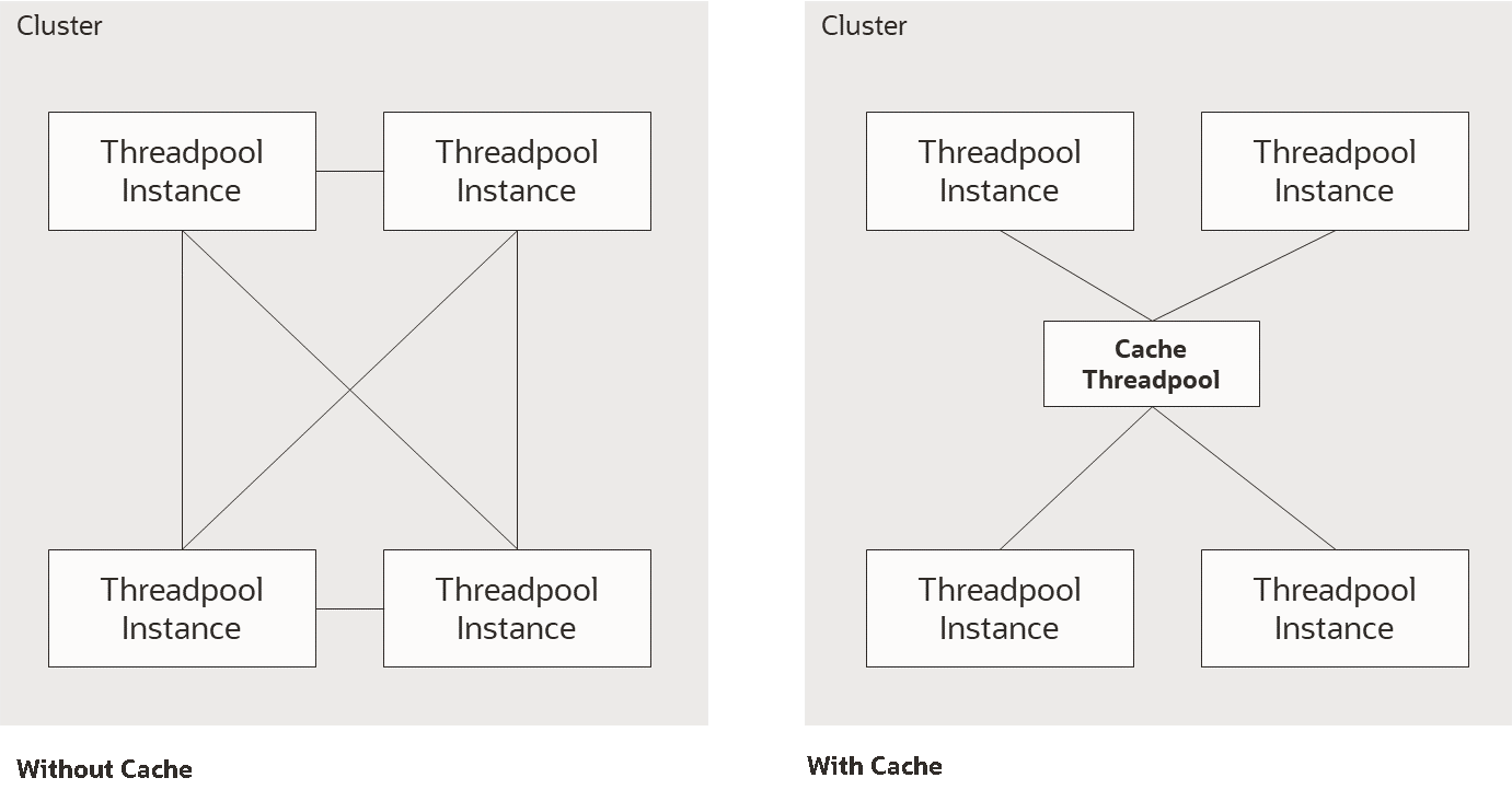

Cache Threadpools
One of the new facilities in the batch architecture is the ability to define cache or storage nodes in your architecture. By default a batch cluster communicates across the cluster elements such as threadpools the state of other elements in the cluster. While this has benefits, as any element in the cluster can be queried, through JMX, to find out the global status of all active processes in that cluster, it can generate a large amounts of network traffic and cause instability as the cluster is performing a large amount of maintenance operations. To address this, in Oracle Utilities Operational Device Management it is now possible to create cache or storage threadpools. These act as conduits with the architecture and greatly reduce the network traffic and overheads in managing the cluster. This translates to more stable clusters.
The communications between elements are shown below:Figure that shows the architecture of the Cache.
The performance advantages of the cache increases with the number of elements the cluster must manage and cache threadpools have the following implementation recommendations:
• Cache threadpools do not execute any threads of any jobs within them. They are exclusively used for administration, a storage node for the cluster state and a conduit for cluster management.
• Cache threadpools act as Coherence local storage nodes to maintain the integrity of the cluster and allow cluster management.
• Cache threadpools are ideally suited to allow JMX connections to monitor the performance of the cluster using the Batch JMX Reference interface.
At least one cache threadpool per cluster per host is recommended. Multiple cache threadpools can be implemented where high availability is required or there are a lrge number of submitters, threads and/or threadpools to manage.
If a cache threadpool, is shut down and no cache threadpools are active at any time, the cluster will not revert to individual elements communicating across other elements.
To create cache clusters, use the bedit.sh -l cache command. A prebuilt template is created for the cache where storage is enabled, distthds, invocthds and the number of threads is set to 0 (to prevent jobs from running in the cache). See bedit - Batch Edit for details.

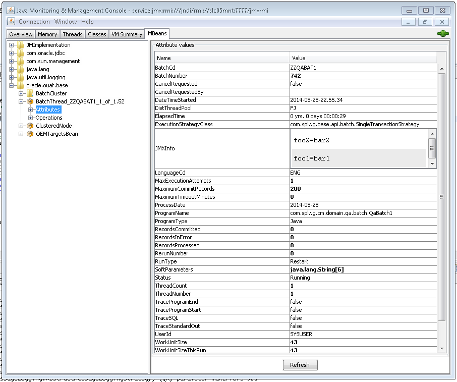

Adding custom JMX Information to jobs
The Batch JMX Reference interface can be extended for additional tags using a new parameter f1.jmxInfo for filtering purposes or additional documentation. For example:Screen capture that shows the JMXInfo in the jconsole.
The submitbatch.properties file for the particular job should have the following additional parameter:
com.splwg.batch.submitter.softParameter.f1.jmxInfo.<tag>=<value>
where:
<tag>
Additional JMX information identifier
<value>
Value for parameter
Multiple parameters of this type are supported within a single configuration file.
For example:
com.splwg.batch.submitter.softParameter.f1.jmxInfo.foo=bar
When using bedit the command sequence to use this facility is:
• Add a soft parameter section for each desaired tag/value pair using the command (a section soft.<sequence> is created where <sequence> is a generated sequence number):
add soft
• Specify the parm property as f1.jmxInfo.<tag> where <tag> is the desired tag using the command:
set soft.<sequence> parm f1.jmxInfo.<tag>
• Specify the value property as the desired value for the tag using the command:
set soft.<sequence> value <value>
It is possible to specify this setting on the submitjob.sh command using the -x option (see submitjob.sh - Submit Batch Threads). For example:
submit.sh … -x f1.jmxInfo.foo=bar
