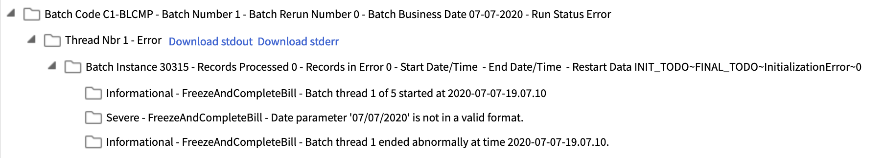

First step is review the Batch Run Tree. The Batch Run Tree shows the details for the Run, Instance(s) and Threads, and is where you can access batch logs (stdout and stderr).
Review the status of the threads by expanding the tree fully. In some cases the thread details will show the error message that was thrown and that may be enough to understand the problem.
Example 1:
In the example above, the run is in error, the thread is in error, and the error message is shown clearly under the instance. In this case the problem was with a batch date parameter.
To get more details, download the log files by clicking on the links and search for terms such as 'error ' or 'ORA-' (for database error code).

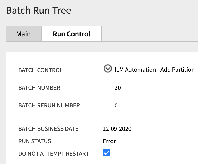

Q2) After a batch results in error and after re-submission, why does the batch run tree shows the same batch number and batch run tree showing multiple batch instances?
By default, a re-submission of an errored job will cause the previously errored run to re-start. Sometimes that is not what you would like to have happen, so to prevent a restart and actually create a new batch run, you need to go to the Run Control tab page of last Batch Run Tree, and check the 'Do Not Attempt Re-Start' box (example below).
Above is an example where the 'Do Not Attempt Restart' has been checked - this will ensure the next job submission will create a new Batch Number.

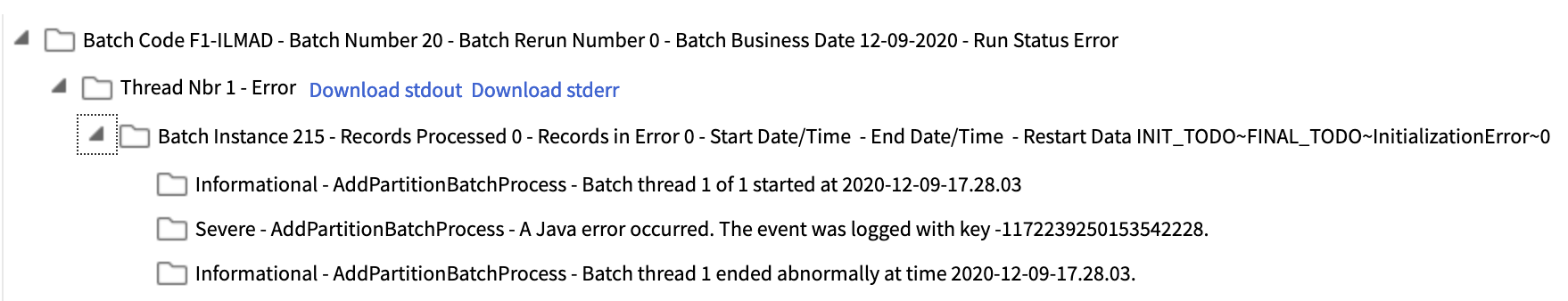

Q3) The batch run tree shows that there was a 'severe Java error' - how can I get further details?
In this case, even the Batch logs may not provide the detail - most often the underlying case is a data problem, such as a bad or missing foreign key that the job is trying to access, causing a null pointer exception. If so, you will need to log an SR and Dev Ops will need to review technical logs to find the underlying error.
Above is a sample Batch Run Tree with a Java error, please follow the 'Important TIPS' for troubleshooting shown under Q1.

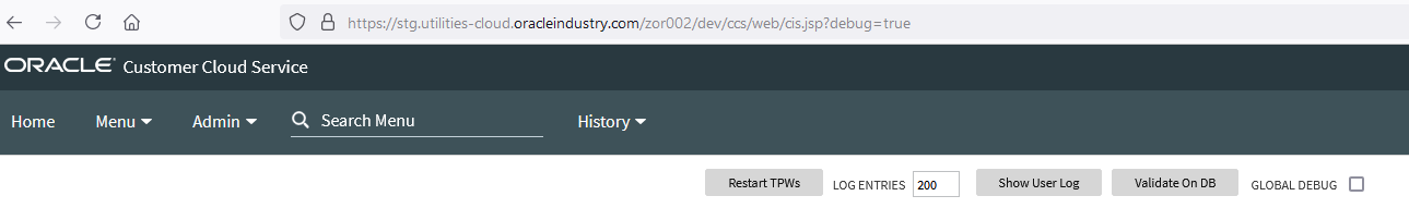

• All available threads in the TPW are currently busy with another job. To check for this, go to the Batch Queues page and verify if any running jobs.
• The TPW may have been (or need to be) restarted because of a previous problem. If already Restarted, your job should start within minutes. Note that the Restart action takes a bit of time because it may need to interrupt running jobs, cleanly shut the batch server pods down, then start them up again. In order to restart, please run the application in debug mode where TPW restart option is available (as seen below)

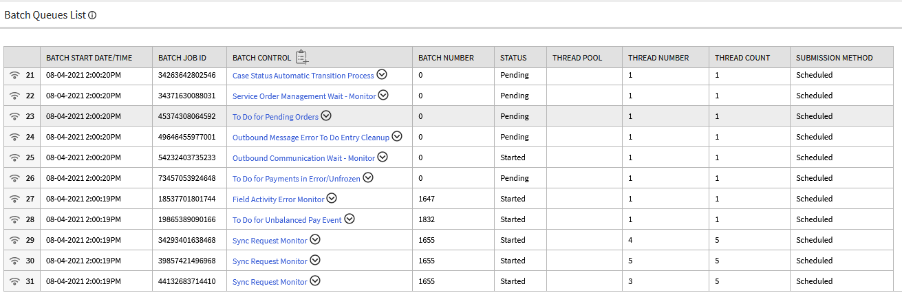

Q6) I want to submit a batch, but I don't know what batches are currently running?
To check this, go to the Admin → B → Batch Queue Portal page and verify if any running jobs. If you see batch jobs already showing in pending status that means you have consumed all the available threads allocated and no capacity available to submit any more batches.

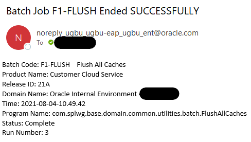

Q9) I am getting batch completion emails from multiple environments, Can i get environment name inside the email contents?

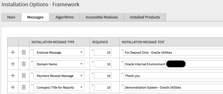

Yes, from 21A onward, implementations can add a "Domain Name" Installation Message type (on the Messages tab of the Installation Options-Framework portal) and provide the description that identifies the environment. That description will be part of the email received as part of batch completion as well as on the application interface.
Above is the Installation Options - Framework list of Messages - add a unique value for "Domain Name" in each environment where batch is running.
Above is a sample batch notification email showing the Domain Name ("Oracle Internal Environment").

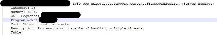

Q10) Can I run any job with many threads?
No, not all jobs support multi-threading. Most Batch Controls will indicate if they support it or not. If the work to be done can be cleanly divided, then multi-threading is available. There are some jobs that take a 'set-based' approach which need to run with a single thread.
If the batch control does not support multi-thread and related to upload / download and you submit the batch with more than one thread, only one thread will process, rest of the threads will start and complete immediately without process any record.
If the batch control does not support multi-thread and not related upload / download, you may see the following error in the log:
