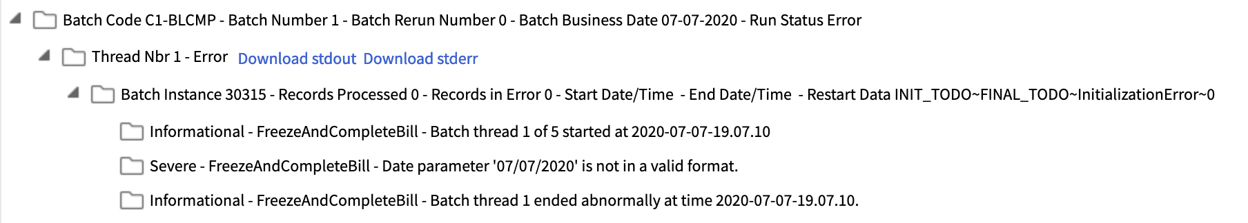

First step is review the Batch Run portal. The Batch Run portal shows the details for the Run, Instance(s) and Threads, and is where you can access batch logs (stdout and stderr).
Review the status of the threads by looking at the thread step on the Batch Run portal. In some cases the thread details will show the error message that was thrown and that may be enough to understand the problem.
To get more details, download the log files by clicking on the links and search for terms such as 'error ' or 'ORA-' (for database error code).
Example 1:
Above is an example of an error in a batch log - in this case a problem during a CMA job. Note that here the key for a Migration Object is given, and is likely a good place to look for something anomalous.
To get more details, download the log files.

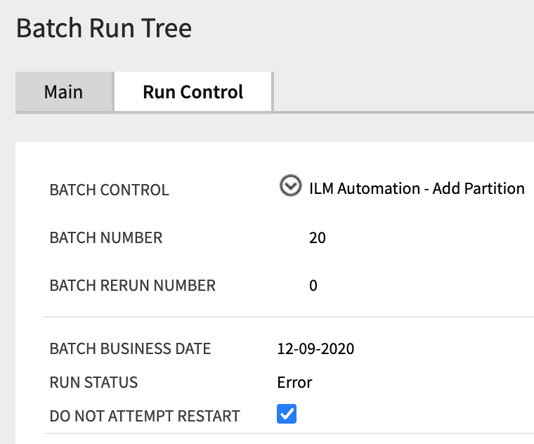

• Make sure the past runs of the batch are marked as DO NOT ATTEMPT RESTART.

Q2) After a batch results in error and after re-submission, why does the Batch Run portal shows the same batch number and Batch Run portal showing multiple batch instances?
By default, a re-submission of an errored job will cause the previously errored run to re-start. Sometimes that is not what you would like to have happen, so to prevent a restart and actually create a new batch run, you need to go to the Run Control tab page of last Batch Run portal, and click Do Not Attempt Restart.

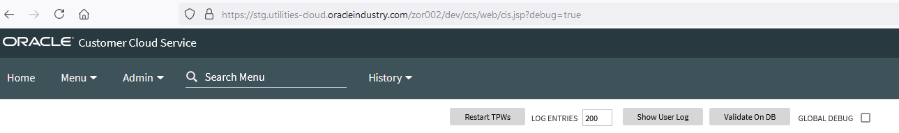

• All available threads in the TPW are currently busy with another job. To check for this, go to the Batch Queues page and verify if any running jobs.
• The TPW may have been (or need to be) restarted because of a previous problem. If already Restarted, your job should start within minutes. Note that the Restart action takes a bit of time because it may need to interrupt running jobs, cleanly shut the batch server pods down, then start them up again. In order to restart, please run the application in debug mode where TPW restart option is available (as seen below)

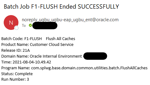

Q9) I am getting batch completion emails from multiple environments, Can i get environment name inside the email contents?
Yes, implementations can add a "Domain Name" Installation Message type (on the Messages tab of the Installation Options-Framework portal) and provide the description that identifies the environment. That description will be part of the email received as part of batch completion as well as on the application interface.
Above is the Installation Options - Framework list of Messages - add a unique value for "Domain Name" in each environment where batch is running.
Above is a sample batch notification email showing the Domain Name ("Oracle Internal Environment").
