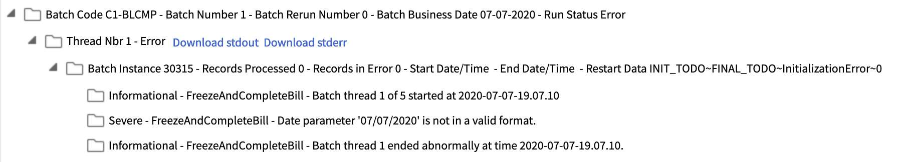

Example 1:
In the example above, the run is in error, the thread is in error, and the error message is shown clearly under the instance. In this case the problem was with a batch date parameter.
To get more details, download the log files by clicking on the links and search for terms such as 'error ' or 'ORA-' (for database error code).

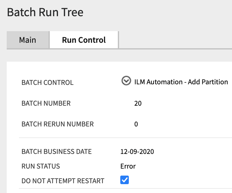

Q2) After a batch results in error and after re-submission, why does the batch run tree shows the same batch number and batch run tree showing multiple batch instances?
By default, a re-submission of an errored job will cause the previously errored run to re-start. Sometimes that is not what you would like to have happen, so to prevent a restart and actually create a new batch run, you need to go to the Run Control tab page of last Batch Run Tree, and check the 'Do Not Attempt Re-Start' box (example below).
Above is an example where the 'Do Not Attempt Restart' has been checked - this will ensure the next job submission will create a new Batch Number.

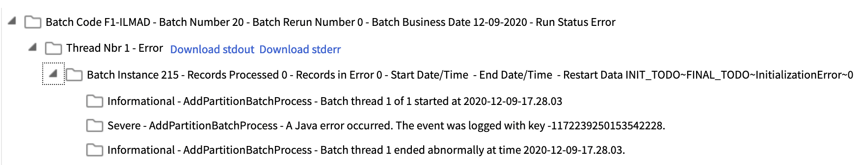

Q3) The batch run tree shows that there was a 'severe Java error' - how can I get further details?
In this case, even the Batch logs may not provide the detail - most often the underlying case is a data problem, such as a bad or missing foreign key that the job is trying to access, causing a null pointer exception. If so, you will need to log an SR and Dev Ops will need to review technical logs to find the underlying error.
Above is a sample Batch Run Tree with a Java error, please follow the 'Important TIPS' for troubleshooting shown under Q1.

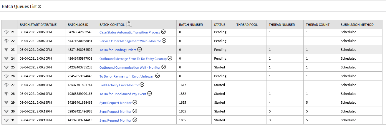

Q6) I want to submit a batch, but I don't know what batches are currently running?
To check this, go to the Admin → B → Batch Queue Portal page and verify if any running jobs. If you see batch jobs already showing in pending status that means you have consumed all the available threads allocated and no capacity available to submit any more batches.

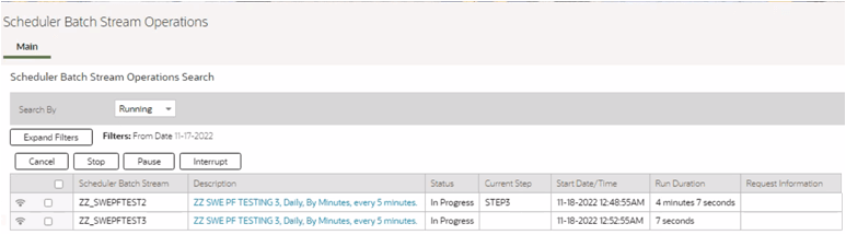

Q7) How do I cancel jobs submitted by SaaS Batch Scheduler?
A Scheduler Batch Stream executes the batch controls in defined chronological order, and it creates batch job submissions with the submission method "Scheduled". Batch job submission with this status can not be canceled through the cancel option on batch job submission page. In order to cancel the Scheduler Batch Stream, you have to go to Scheduler Batch Stream Operations portal page, then select the running stream and perform cancel operation. This will result in canceling the overall stream including current running batches.

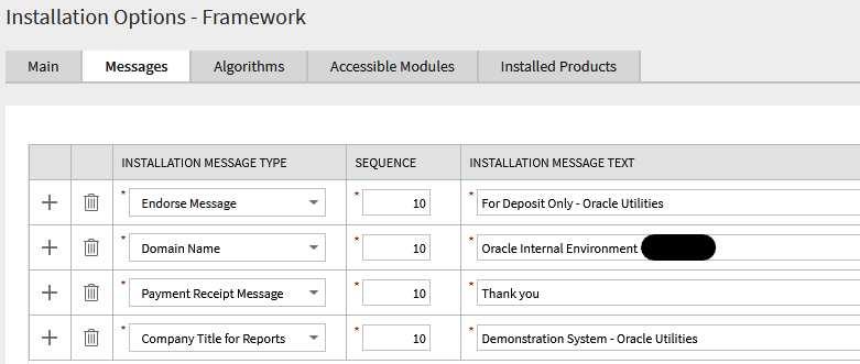

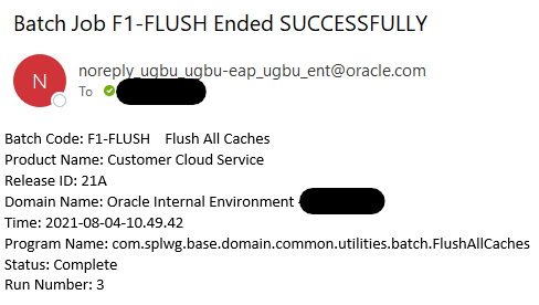

Q9) I am getting batch completion emails from multiple environments, Can i get environment name inside the email contents?
Yes, from 21A onward, implementations can add a "Domain Name" Installation Message type (on the Messages tab of the Installation Options-Framework portal) and provide the description that identifies the environment. That description will be part of the email received as part of batch completion as well as on the application interface.
Above is the Installation Options - Framework list of Messages - add a unique value for "Domain Name" in each environment where batch is running.
Above is a sample batch notification email showing the Domain Name ("Oracle Internal Environment").

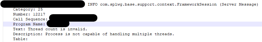

Q10) Can I run any job with many threads?
No, not all jobs support multi-threading. Most Batch Controls will indicate if they support it or not. If the work to be done can be cleanly divided, then multi-threading is available. There are some jobs that take a 'set-based' approach which need to run with a single thread.
If the batch control does not support multi-thread and related to upload / download and you submit the batch with more than one thread, only one thread will process, rest of the threads will start and complete immediately without process any record.
If the batch control does not support multi-thread and not related upload / download, you may see the following error in the log:

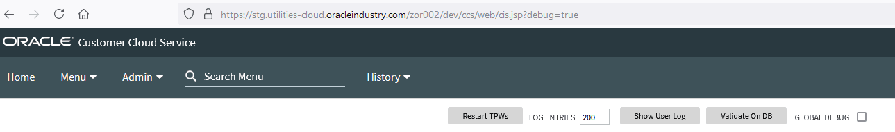

Q17) While running plug-in driven batch for DML operations on Admin tables, i am getting "Illegal attempt to modify read-only entity" error. How to address it?
Run the batch in "NOCACHE" TPW and it will resolve the issue.
In general terms, ‘DEFAULT’ TPW caches a whole lot of ‘Admin’ data including meta-data. This makes jobs like billing run a lot faster, because you can safely assume that the Admin data won’t be changed during the run, and you can just access what’s in the cache and therefore, If your job does try to make changes to Admin data, you will get errors when running it in "DEFAULT" TPW.
The situation is different when running CMA batch jobs which actually try to add / update / delete Admin data which need "NOCACHE" (with L2 cache off) that will enable CMA batch to make changes to Admin data while running the batches.
The timeout of NOCACHE has been lifted to cater for longer-running processes (like indexing and partitioning). DEFAULT has a shorter timeout, because in normal jobs it’s a bad sign if particular operations are taking 15 minutes (or whatever the timeout is set to).
In the meantime, you can of course make changes to Admin data – but sometimes you have to do the ‘flush’ to empty and rebuild certain caches so that the new/changed values are accessible to everyone.
