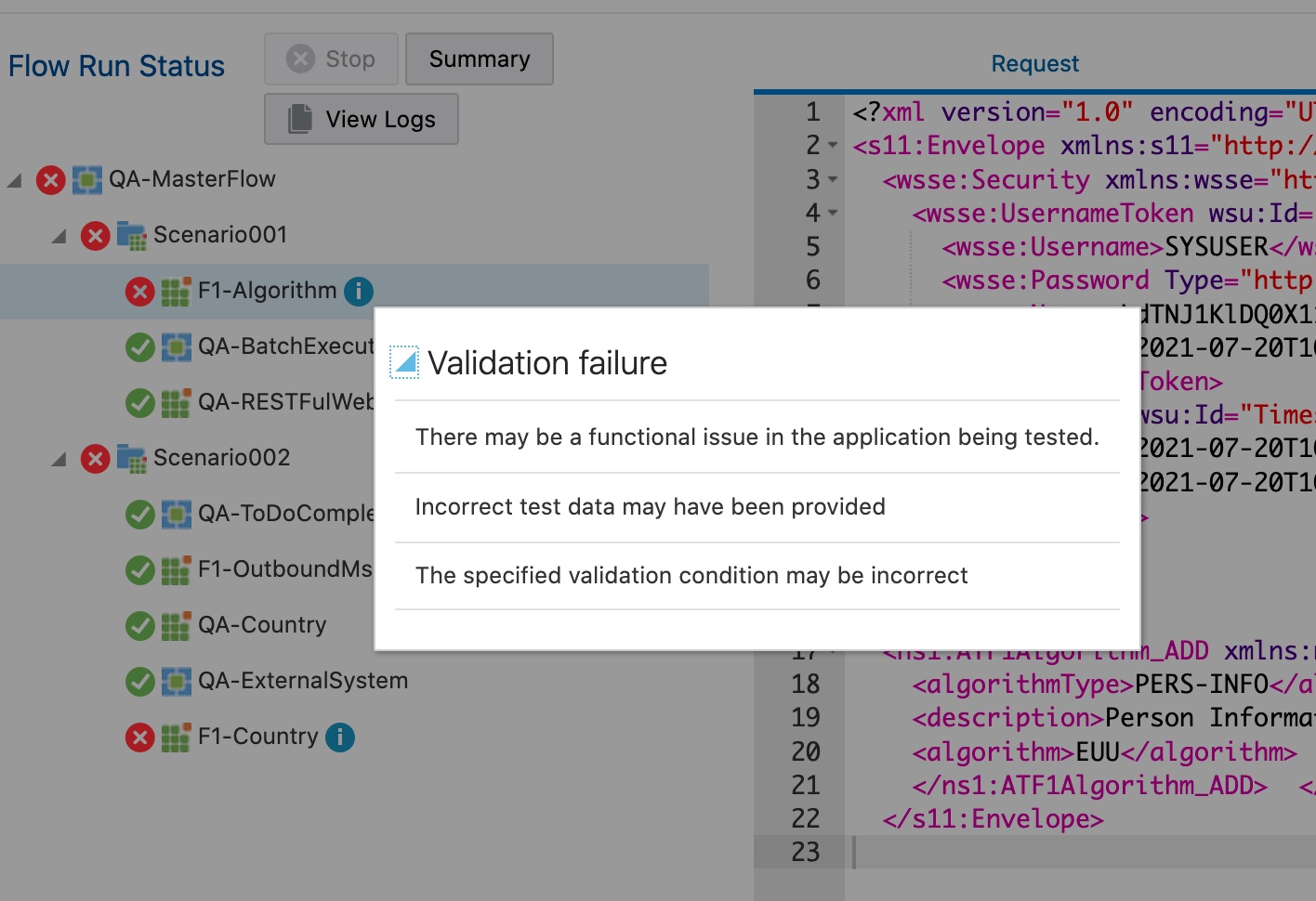

4. Click the flow run entries to view the respective details of that run. The flow run tree for the corresponding flow is displayed.
5. Click the info icon next to the failed component step in the flow run. The appropriate error is displayed along with a list of possible reasons leading to the error.
Viewing Flow Run Failure Details
If a flow run fails, the possible reasons for failure can be viewed. Click the Info icon next to the failed component step in the Flow Run Status tree structure.
5. Click the Info icon next to the failed component step in the flow run. The error is displayed along with a list of possible reasons leading to the error.
