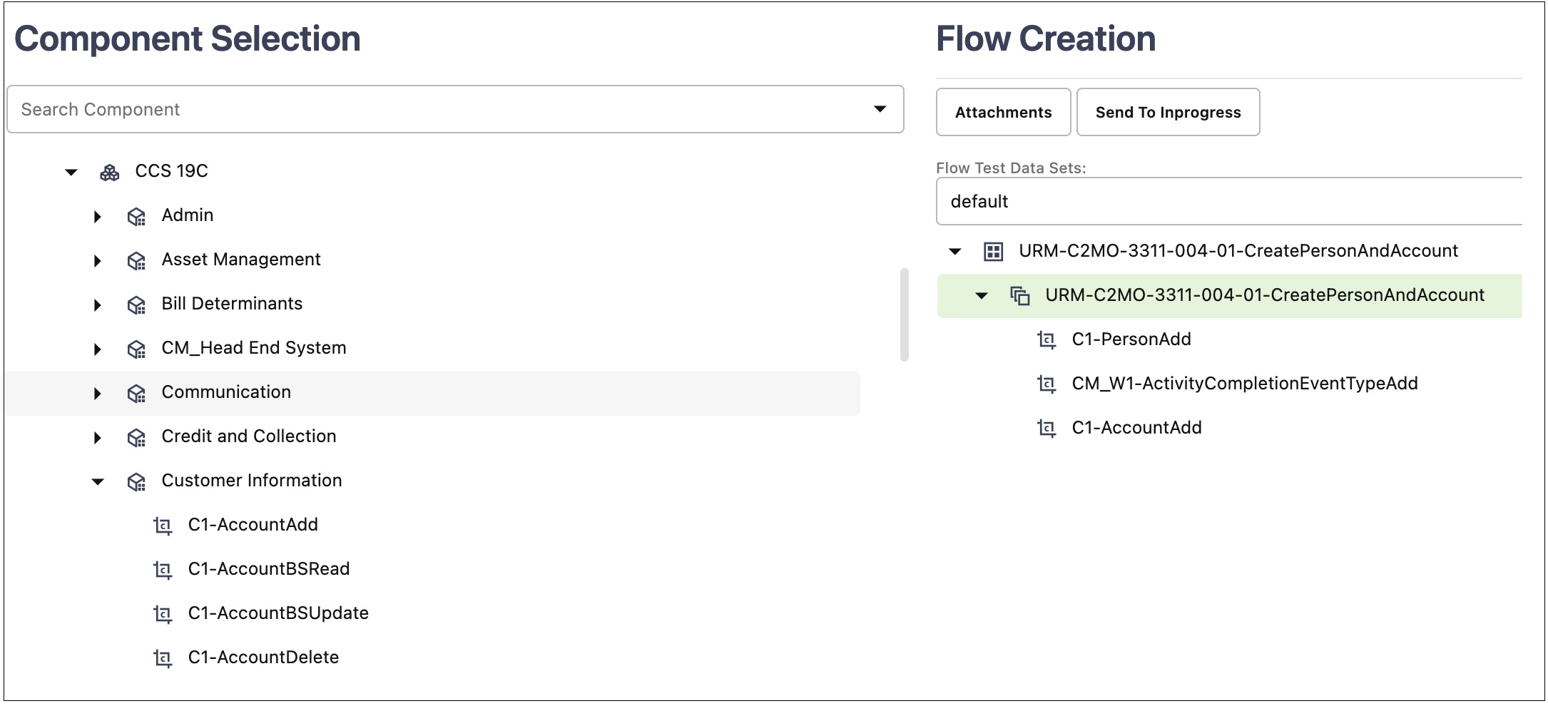

1. Navigate to the product/module in the flow tree to create the flow.
2. Right-click the product/module and select Create Flow.
3. In the Create Flow pane, enter the Flow Name, Flow Type, Tags, and Description.
4. Save in either of the following ways:
• Save: Saves the flow and redirects to the Search Flow page.
• Create Structure: Creates the flow with a default scenario and redirects to the Flow Structure page.

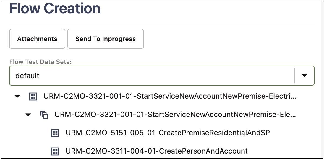

5. Expand the flow tree. The flow contains a default scenario with the same name as the flow name.
6. In the sequence defined by the business scenario being tested, drag and drop the components from the
Approved Components pane to the flow scenario or components within the flow structure. The component moved will be added below the scenario/component to which it was moved.

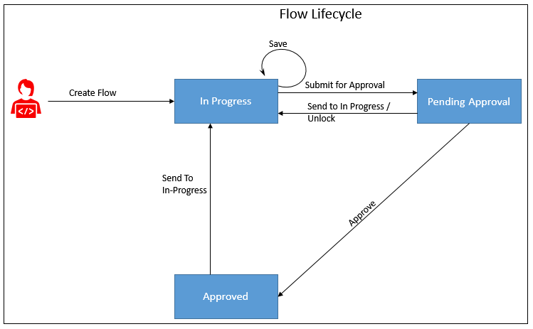

Note: Flow definition can be modified (components added or removed) only if the flow is in “In Progress” state.

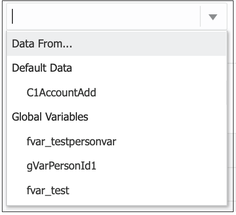

• Data From..: This option allows the test data to be set from the web service response of any preceding component in the flow. It allows test data to be passed between components, without the use of global variables.
• Default Data: This section allows test data to be set from the default data specified in the component definition. For most of the UTA components, the default data is set only for the web service name and the transaction type fields. If the default data is not specified in the component definition for a given field, this option will not be displayed in the test data field drop down.
• Global Variables: This section allows test data to be set using the global variables defined in the preceding components in the same flow. The list of available global variables are displayed under this section. A global variable can be set as test data input for a given field, in which case, during the course of test flow run, the value populated into the global variable in the preceding component steps will be used as the test data.

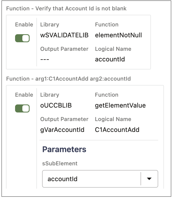

• The bottom part of the Test Data GUI shows the functions defined in the component. Enable or disable the validations/functions defined in the component by appropriately switching
Enable in the first cell. If the switch is not enabled, during the course of the test run, the function/validation will not be triggered. The switch only appears for rows to which this feature is applicable.

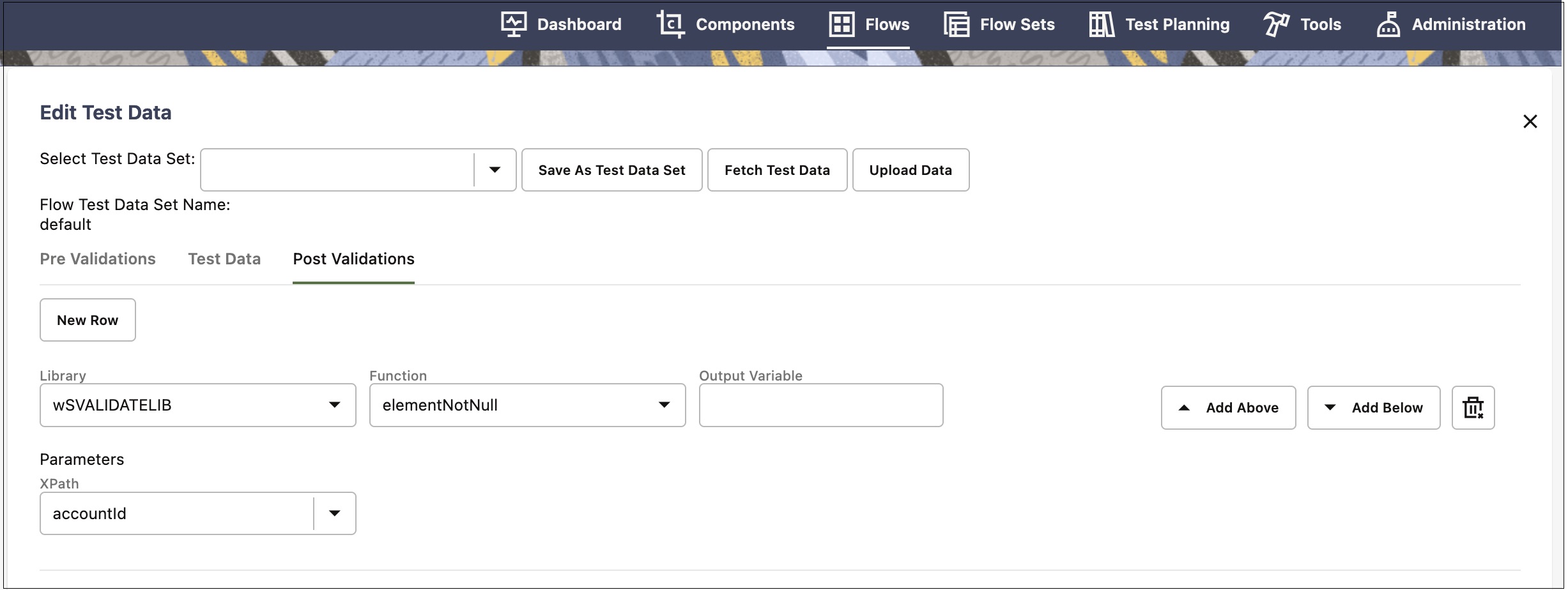

c. Post Validations
The Post Validations section is used to add verification functions post the base validations. Each of the component comes with a base set of validations and these can be disabled or enabled in the Test Data GUI using the switch corresponding to the validation line in the test data UI for the component. And, if any new or more of these verifications are to be added based on the flow specific requirements or if a specific set of values have to be retrieved from the response of the component run, the Post Validations section can be used.
The post validations section allows users to add any number of functions/validations to the component step in a flow. These will be specific to the component's instance in that flow. These will not apply to the component when used in other flows. Specification of functions in the Post Validations section follows the same pattern as the one specified in the Pre-validations section.
Only function calls can be added in the
Post Validations section.

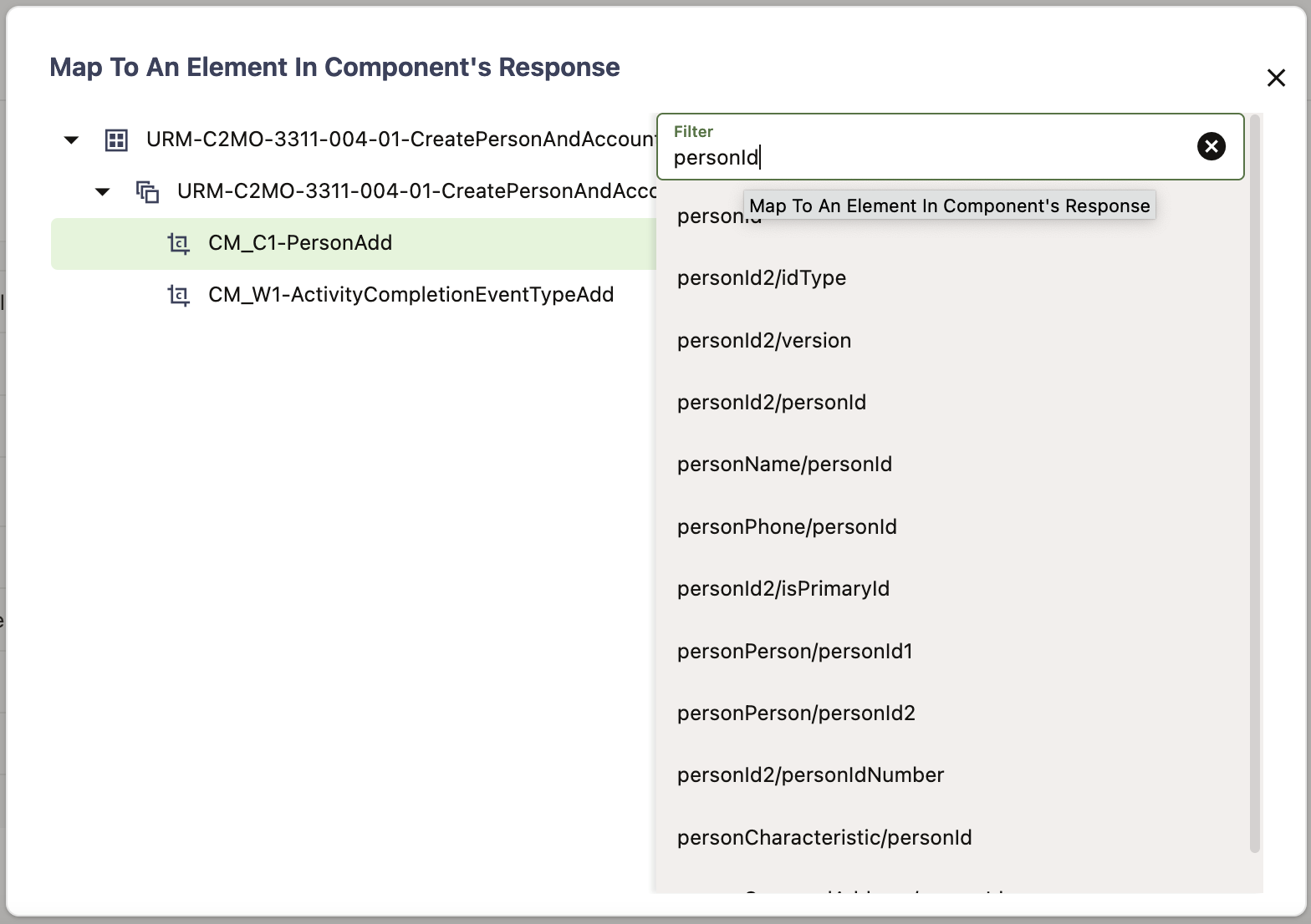

To map to non-list elements in a response:
1. Navigate to the Create/Update Flow Structure for the test flow.
2. Navigate to the Flow Test Data page of the component into which test data should be linked to. Click the downward arrow corresponding to the test data field to show the drop-down list.
3. From the list, select Data From...
In the example, the test data page corresponds to C1-AccountAdd component in the flow, which has C1-PersonAdd component preceding the C1-AccountAdd component.
The flow tree structure up to the preceding component of the current component is displayed.
4. Click the component from whose response the value should to be mapped. The corresponding elements in the component is displayed.
5. Select the element from the component’s response whose value needs to be mapped to this field in the current component. The filter at the top of the xpath attributes can be used to quickly find the xpath that is needed.
In the case of the example, select the personId field from the C1-PersonAdd component.
The test data field is populated with the selected element. “-->” is prefixed to the selected element name to differentiate it from the global variables and static test data.
The following figure shows the selected personId field mapped between the components.

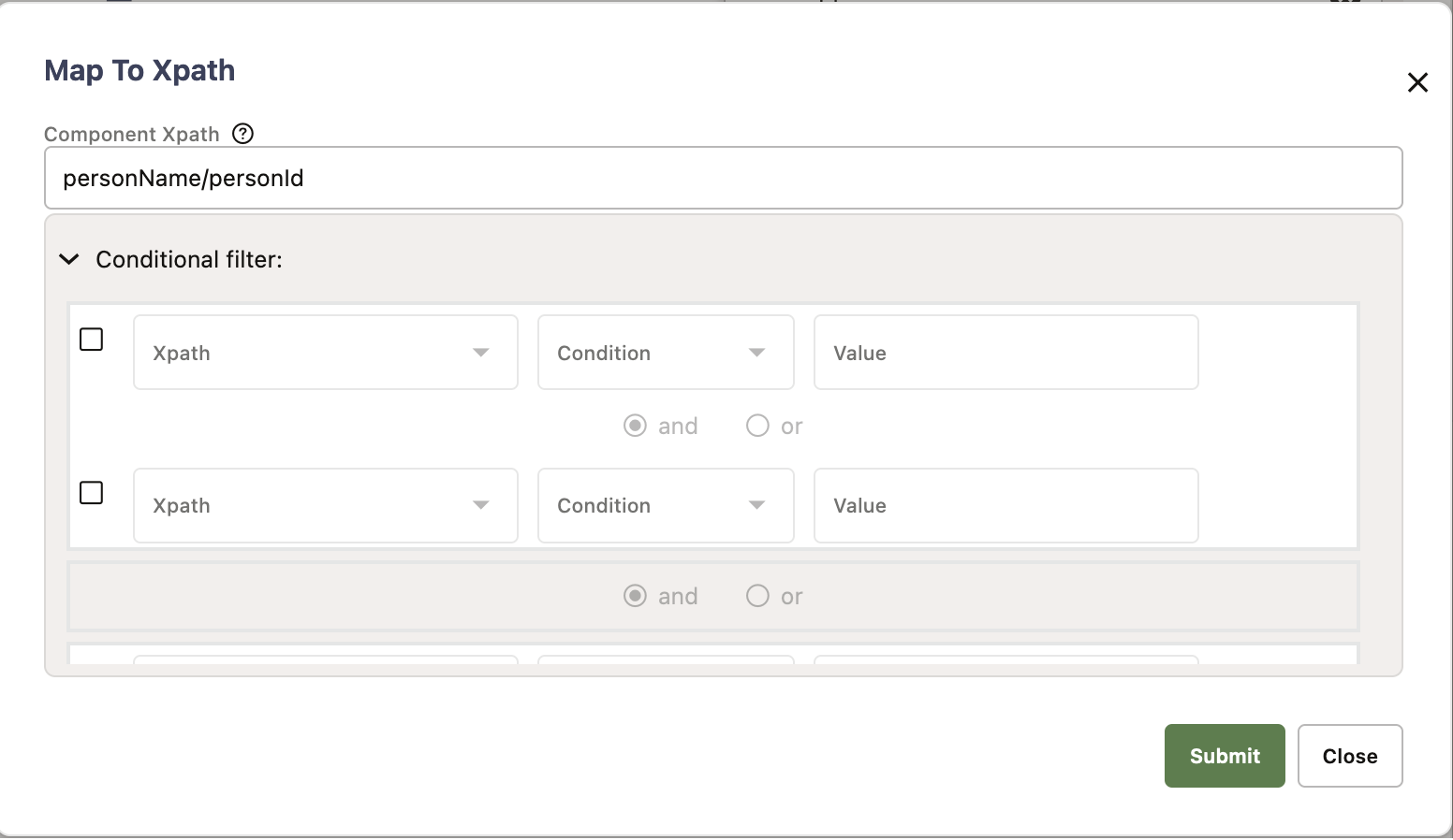

To map to list elements in a response:
The following figure shows the option to map to a specific occurrence of the list element:
6. If a specific occurrence of the list element is already known, the xpath value can be updated to point to that specific occurrence of that list.
Example: personName[2]/personId will map the personId from second occurrence of the personName list

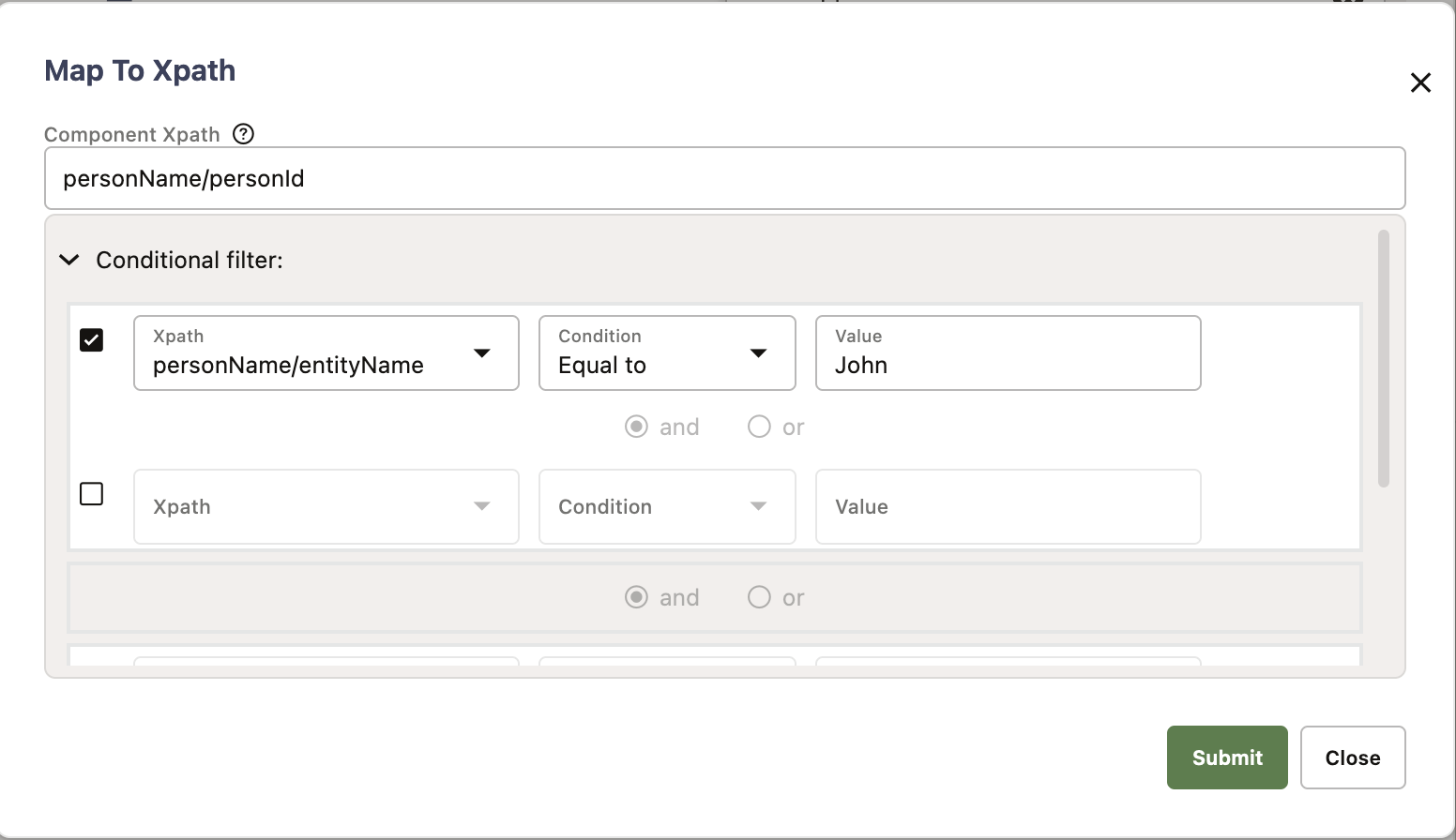

7. If the specific occurrence is not known, conditions may be applied on one or more of the list elements to find the required value from the list.
In the above example: To find the personId corresponding to the person with the name “John”, the first condition can be enabled and the condition can be specified in the condition filter.
The list element on which the condition needs to be specified should be selected in the xpath field and a condition type can selected from the condition drop down. Based on the condition type, the value can be provided.
The supported conditions are:
• “Less than”, “Less than or equal to”, “Greater than”, “Greater than or equal to”: These are applicable only to value type Number.
• “Equal to”, “Not equal to”, “contains”: These are applicable to value type String.
• “Equal to” and “Not equal to” condition types as applicable to value type Number as well.
• “Starts with” and “Ends with” condition types are applicable to value type String.
• “Not null” and “Is null” is used to check if the value exists or not, in the response. In case Not null or Is null option is selected, the Value field should be left blank.
If more than one condition needs to be specified, the appropriate conditions may be added by enabling succeeding condition filters. The corresponding join type also needs to be selected for multiple filters. The support join types are “And” and “Or”.
8. After specifying all conditions, click Submit to save the conditions for mapping.
9. To review or update the conditions, click the Test Data drop-down list corresponding to this field and then select Data From option. The Map to Xpath window is displayed with the current conditions.

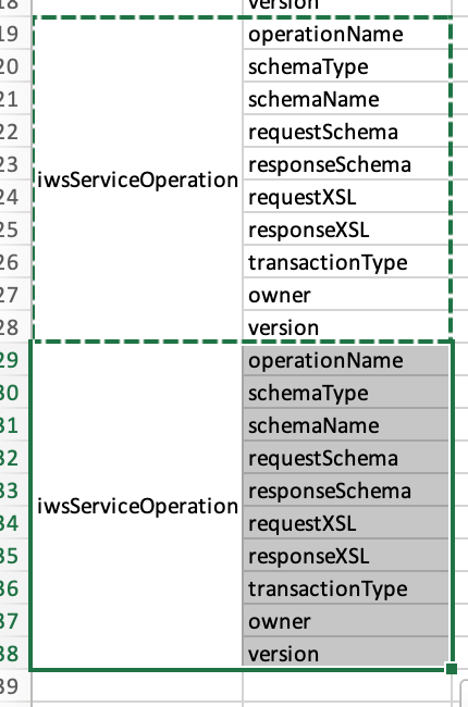

Managing Flow Test Data Using Spreadsheets
In addition to using the Oracle Utilities Testing Accelerator's workbench GUI for adding/updating test data in a flow, spreadsheets can also be used to add/update test data in the flows. The supported spreadsheet format is xlsx, which provides versatile formatting for easier input of test data. Each flow has a download spreadsheet option that allows you to download a template corresponding to the flow definition. Each worksheet in the xlsx spreadsheet holds the test data pertaining to an individual component in the flow. Test data can also be added/updated for test data sets in the flow. You can even create new test data sets in the spreadsheet. Once the spreadsheet is updated with appropriate test data, you can import the spreadsheet to update the test data in the flow from which it was downloaded.
To manage test data using spreadsheets:
2. Click Test Data Spreadsheet in the flow creation frame.
3. In the Manage Test Data Through Spreadsheet popup, click Download.
4. Download and save the spreadsheet to your laptop/desktop.
5. Open the spreadsheet and edit the test data:
• The spreadsheet has multiple worksheets where each worksheet maps to a component in the flow definition.
• The Documentation worksheet holds the high-level list of all the worksheets.
• The worksheets are named based on the scenario number and the components sequence in the flow.
Example: The prefix SC1_SEQ1 is used to denote scenario 1 and component sequence 1.
• Test data corresponding to a component in a flow is held in each individual worksheet. The columns marked as element name, hold the names of each individual element in the component and the columns marked with the header test data sets holds the flow test data corresponding to the flow test data set.
• Multiple values under group/list elements in the component definition can be added in the spreadsheet by duplicating the corresponding rows.
• The test data for elements in the component definition can be set against each of the rows, under the appropriate flow test data sets.
• New flow test data sets can be added in the spreadsheet. Deletion of flow test data sets through the spreadsheet is not allowed.
• After the test data is updated, the spreadsheet can be uploaded into the flow definition through the popup window displayed under step 3 in this process.
Please note the following:
• The sequence of the worksheets in the spreadsheet should not be altered.
• The flow variables defined in the flow are marked in the spreadsheet as “Global Variable”, in the test data. Similarly, the pointers used for mapping test data between components in Oracle Utilities Testing Accelerator GUI are also marked.
• Test data pertaining to subroutine flow calls cannot be managed through the spreadsheet. If the flow has a subroutine flow as a flow step, then the spreadsheet will not have test data or worksheet pertaining to the subroutine flow call step.

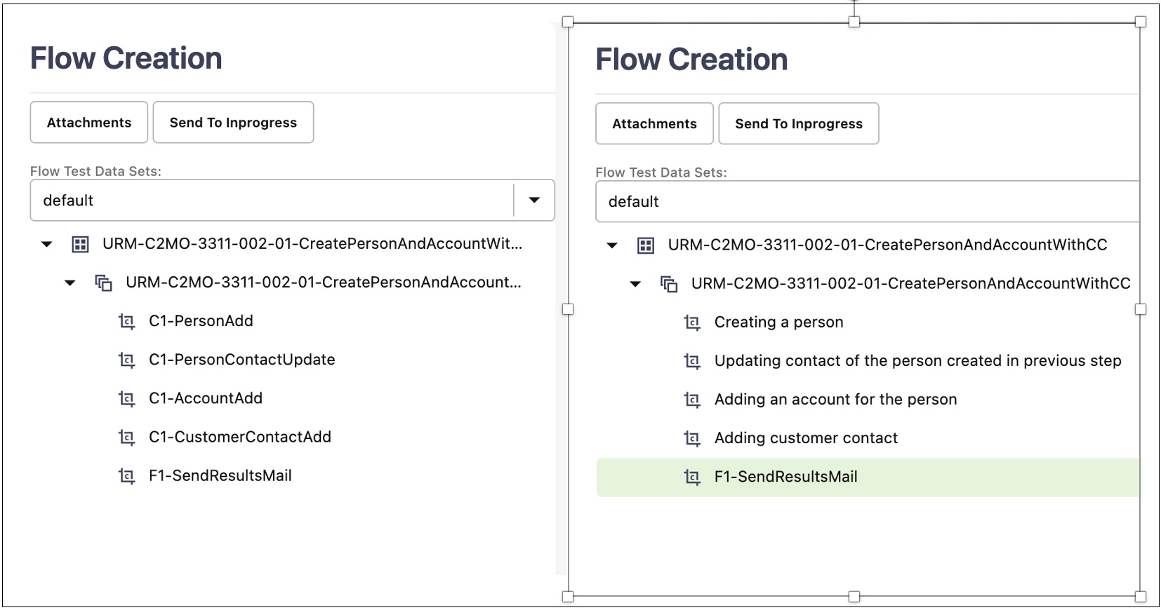

Annotating Components in a Flow
Annotations can be added for each component step to describe the purpose of each of the steps in an Oracle Utility Testing Accelerator test flow. This helps in understanding the functional aspects of the flow just by looking at the flow tree structure.
To add an annotation right-click a component step in the flow definition. Select Update Component Description and enter the description. The description replaces the default display of the component name in the flow step. The annotation can be removed or updated through the same process. Clearing the component description in the flow removes the annotation and displays the component name.
The following figure shows a flow without and with annotations:

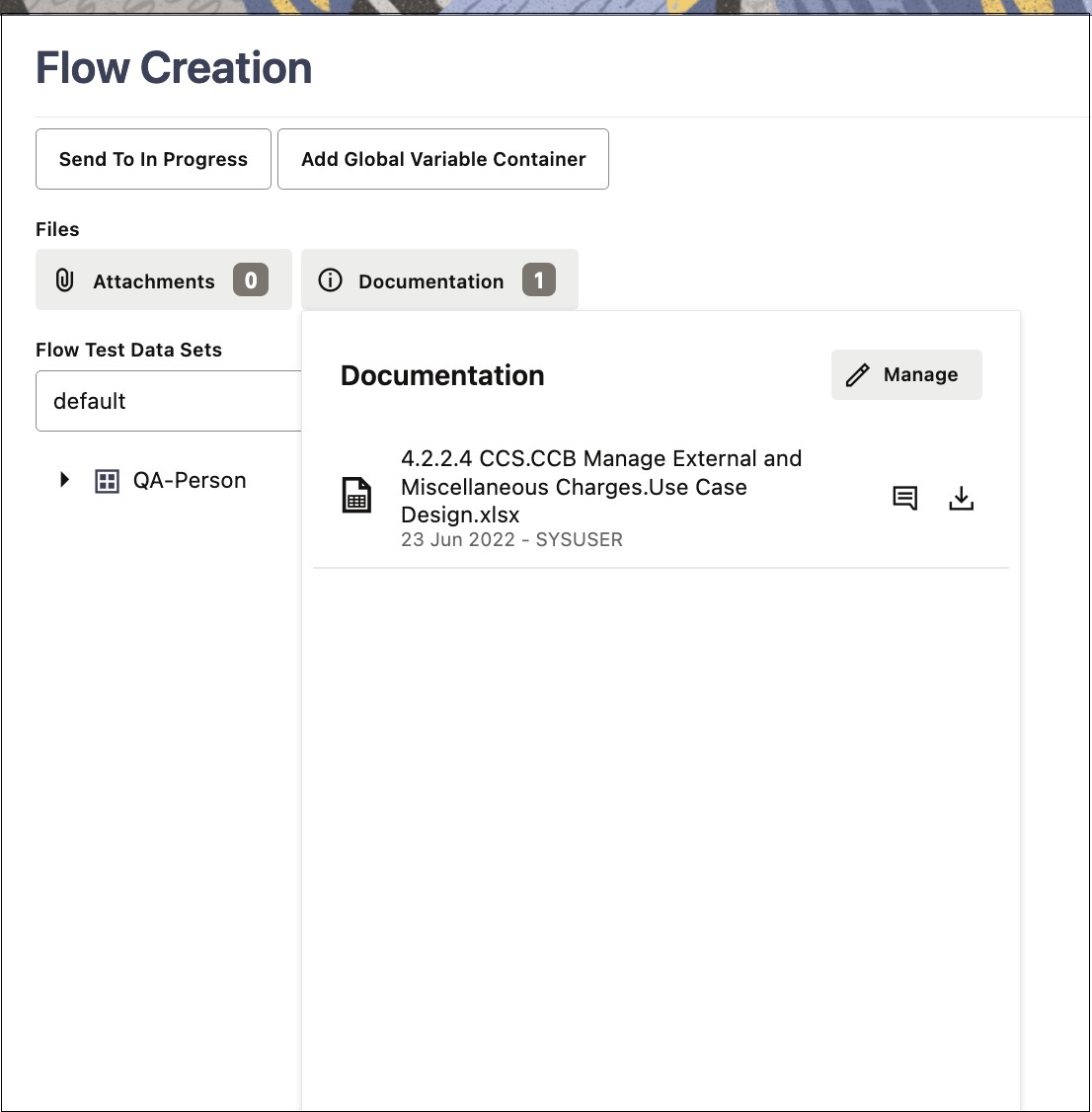

Adding Documentation to a Flow
Documentation is crucial to any technical artifact as it helps in preserving and sharing information/knowledge pertaining to that artifact. Oracle Utilities Testing Accelerator supports the ability to embed documentation pertaining to a flow within the flow definition.
This feature supports several popular documentation formats. The documentation of the flow is saved as a new type of attachment to the flow, allowing you to upload and download the documentation directly through the Flow Definition page.
The following document types are supported: .csv, .doc, .docx, .jpeg, .jpg, .pdf, .png, .txt, .xls, and .xlsx
This section focuses on the following:

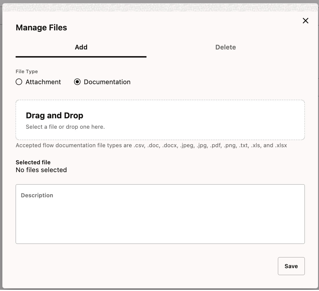

Adding Documents to a Flow
To add a document to a flow:
1. Select and right-click the flow name in the Oracle Utilities Testing Accelerator flows tree structure.
2. Click Create/Update Flow Structure.
3. In the Flow Creation zone, click Documentation.
4. Click Manage.
5. Drag and drop the documentation file. Alternatively, click the field to add the file using file explorer. Make sure the Documentation File Type option is selected.
6. Add the file description in the
Description field.
7. Click Save.

Downloading Documents from a Flow
To download a document from a flow:
4. Click the Description icon next to the documentation file name to view the description of the file.
5. Click the
Download icon next to the file to be downloaded.

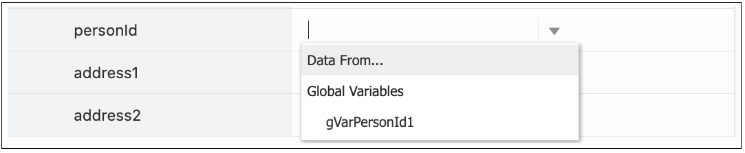

To add component references to a dependent component (C1-CustomerContactAdd):

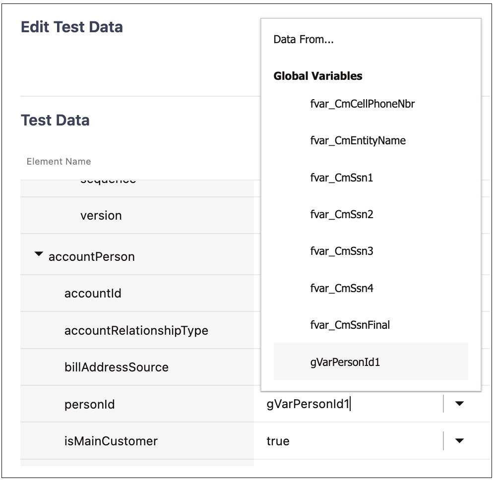

1. In the Edit Test Data GUI of the C1-CustomerContactAdd component, find the component line that requires the personId as input.
2. Against the personId row, click the downward arrow to open the Test Data drop-down list. All variables exposed by the preceding components are diaplayed in the Global Variables section.
In this case, personId exposed by the C1- PersonAdd component.
3. Select the personId variable from the drop down list and set it as test data against this element.
Each of the base components expose one or more global variables that hold the output of the component during execution. These global variables can be used to set the output of one component as the input of another component.
Additionally, global variables are also created to hold output of functions used in pre-validations or post-validations sections. These global variables are defined in the Output Variable field and are to be set against only functions that return an output value. These function based global variables are automatically pre-fixed with “fVar_” and these can be used as input in the test data of subsequent steps in the flow.
All the global variables are automatically suffixed with their occurrence number. If the C1-PersonAdd component is used twice in the flow, there will be two variables (gVarPersonId1, gVarPersonId2) one for each occurrence of the component, suffixed with it's occurrence number. Custom global variables can be defined and exposed by the components through the Pre-Validations and Post Validations sections. These variables are automatically prefixed with “fvar_”, to differentiate them from the component's base global variables. These variables are also suffixed with their occurrence number in the flow, similar to the global variables specified in the component definition.

Adding Flow Variable Container to a Flow
To add a flow variable container to a flow:
3. Click Add Global Variable Container.
4. Right-click the variable container in the flow tree structure and select Edit Test Data.
5. Define a flow variable name in the Output Variable Name field.
6. Define the variable value in the Value field.
7. Add more rows and enter the variables.
8. Click Save to save the updates.
These variables can be used as test data in the subsequent components in the flow.

Flow Lifecycle
The flow lifecycle begins once a flow is created in Oracle Utilities Testing Accelerator. It can exist in one of the several possible lifecycle states as shown in the following diagram.
The state of a flow determines the actions that can be performed on the component. The following table summarizes the component states, and the possible actions and roles that can take the actions.
Locking/Unlocking Flows
A flow is/can be locked in the following scenarios:
• To prevent any other users from editing the flow until the flow is complete.
• By default when the flow is submitted for approval.
• If the flow is unlocked while in the ‘Pending Approval’ state, its state is changed back to ‘In Progress’. However, if it is moved to ‘In Progress’ state from ‘Pending Approval’ state, it stays locked until the user unlocks it.
Click the
icon to lock/unlock a flow in Oracle Utilities Testing Accelerator.
Note that scripts can be generated only when the flow is in an “Approved” state.

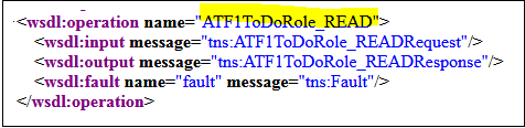

5. On the
Fetch Test Data page, enter in the web service name from which the test data has to be retrieved, operation (typically READ operation) to invoke and necessary credentials and any required info (for example: to retrieve data related to ToDoRole).
6. Enter the WSDL name and operation name. Select the user and flow configuration set. Click Populate Form to populate the form with all fields that the web service supports.
Alternatively, use the URL and user credentials from the Flow/User Configuration properties file. Click Use Configuration Properties and select the appropriate flow/user configuration from the respective drop-down menus.

A flow subroutine is a flow that can be included/used in other flows. It improves reuse of a flow. For example: Many test cases expect a ‘V’ setup to be available before being able to verify some business test cases. In this case, create a flow for ‘V’ setup and all other test case flows can reuse this ‘V’ setup flow as a subroutine in their respective flows. Specify any variables/parameters that the subroutine expects from the parent flow and also expose any variables/parameters that are created in the subroutine. Right-click Edit Test Data on the flow subroutine component in the flow.
• For a given flow test data set pertaining to the flow calling the subroutines, the test data set of the subroutine can be selected in the subroutine's test data GUI. Right-click the subroutine and select Edit Test Data.
• Only the variables defined in the default test data set of a subroutine flow can be used as input or output of the subroutine. This is to ensure standardized API for the subroutine.
Adding Subroutines to a Flow
To add an existing flow as a subroutine in a flow:
1. Right-click the scenario/component in the flow.
2. Select Add SubRoutine.
3. Specify the Release, Product Family, and Product to filter the flows.
4. From the Flows drop-down list (search-able), select the flow to be included.
5. Click Add to add it to the current flow as a subroutine.
• A flow cannot be added to itself as a subroutine. Make sure that nested subroutines do not create a cyclic dependency.

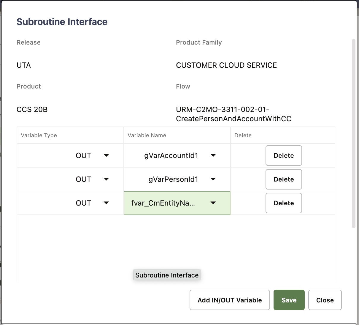

Defining Input-Output Parameters of a Subroutine
To define input and output parameters for a subroutine:
1. Navigate to the Flows tab.
2. Right-click the flow name in the product and navigate to module > flow tree structure in the left pane. Select Define Subroutine Interface.
3. Specify the parameters the subroutine expects from the calling flow and the parameters the subroutine exposes to the calling flow.
Example: If the subroutine creates an Account, it expects a personId value to be provided for it to create an Account. After an account is created, it returns the accountId. The subroutine should be defined with one input variable “personId” and another output variable “accountId”.
4. Add additional input/output variable.
a. Click Add IN/OUT Variable.
b. Enter the name and parameter type.
c. Click
Save.
This figure shows a subroutine interface definition for a flow that creates both a person and account and exposes personId and accountId as outputs, so they can be used by the calling flow.

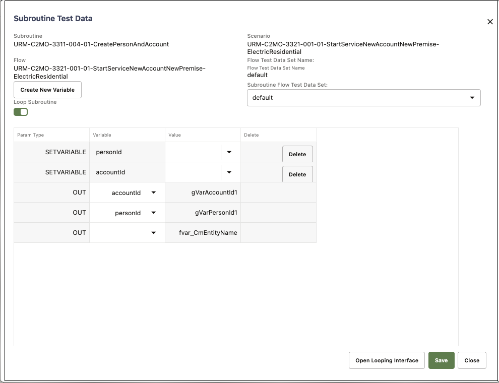

5. After a subroutine is added to a flow calling a subroutine, map the input or output variable(s) of the subroutine.
a. Right-click the subroutine in the flow tree structure of the calling flow and select Edit Test Data.
b. Map the input/output variable of the subroutine to a variable in the calling flow.
Example: The subroutine might be exposing accountId as the variable. To use the exposed variable in the calling flow, create a new variable in the calling flow using Create New Variable. Map the output accountId variable from the subroutine flow to the newly created variable in the calling flow. This new variable can be used in the test data GUI of any component that succeeds the subroutine in the calling flow.
This figure shows the Edit Test Data screen for a subroutine that outputs a personId and accountId. New variables, personId and accountId are created and the outputs of the subroutine are mapped to the variables (gVarAccountId1 and gVarPersonId1).
Running Subroutine in a Loop
To achieve the capability to loop one or more components within a flow, create the component(s) as a subroutine flow. A subroutine flow can be run in a loop either a fixed number of times or until an exit condition is satisfied.
Example: If the subroutine creates a meter read, the user can loop the subroutine 24 times to create a meter read for every hour of a particular day.
Note: This feature only works with simple subroutines and not intended for nested subroutines. The flow re-run (from the point of failure) feature will not work if the flow has a subroutine loop defined.

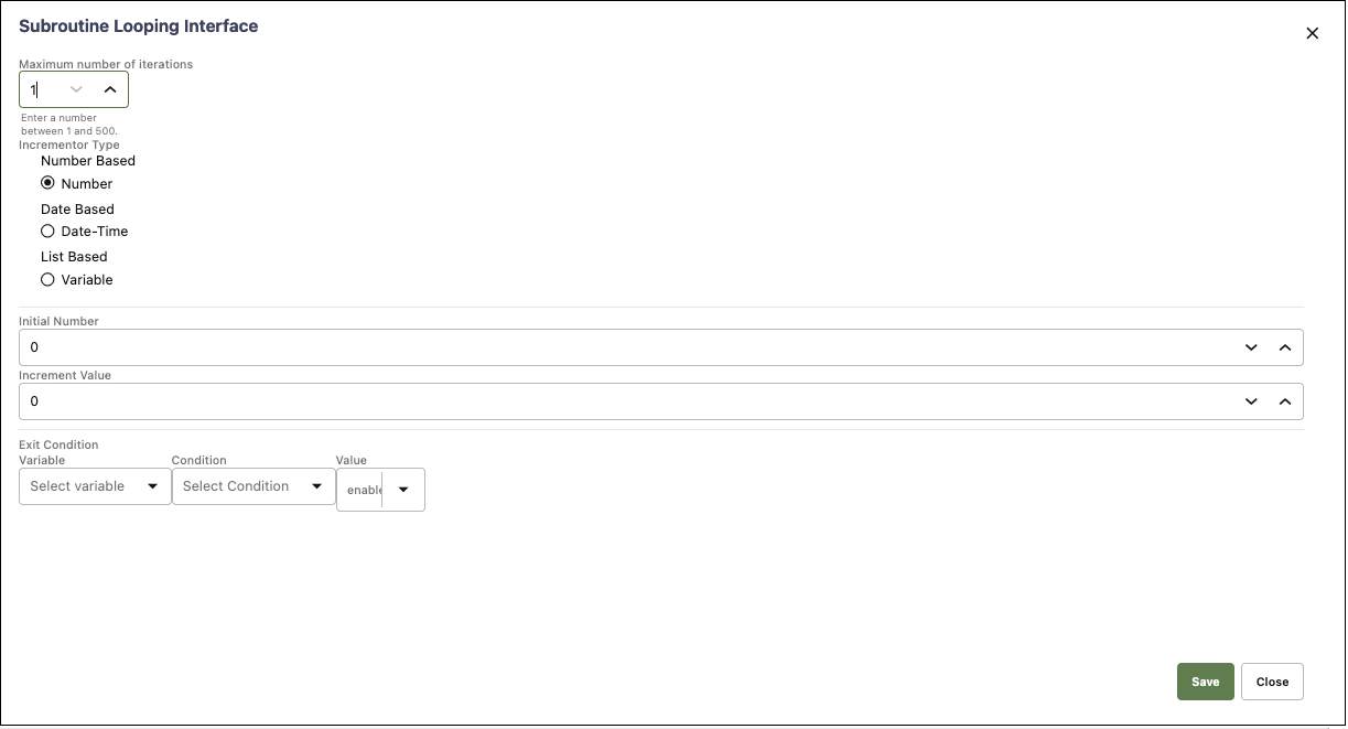

To define subroutine looping, add the sub-routine flow to the parent flow. To specify the loop criteria and other details for the subroutine, open the Test Data page of the subroutine within the parent flow. Right-click the subroutine flow and select Edit Test Data. Enable the Loop subroutine switch and click Open Looping Interface to provide the criteria for executing the subroutine in a loop.
Open Looping Interface.
Open Looping Interface provides the following options:
• Maximum Number of Iterations: Represents the maximum number of iterations that the subroutine will be run for, irrespective of the exit criteria specified. This is useful in scenarios where the subroutine can wait but not run indefinitely (either due to wrong test data/unexpected application behavior). Use this option to run the subroutine a fixed number of times.
Example: If the subroutine creates a person entity in the application, specify the value 10 to run the subroutine 10 times resulting in creation of 10 person entities in Oracle Utilities Customer Cloud Service.
• Incrementor Type: Indicates if the loop incrementor would be a number or a date-time or list variable based, user can choose date as incrementor in case the subroutine creates meter reads for a meter and user wants to run the subroutine to create meter reads in a certain date range. The value of this incrementor sis available for usage in the subroutine flow, through the use of “incrementor” variable.
• Initial Number/Initial Date-Time: Based on the Incrementor Type selected, specify the starting number or the starting date-time to be used. This is not applicable for list variable based looping.
• Increment Value: Based on the Incrementor Type selected, specify the value by which the initial number/date should be incremented by (either a number or in days, hours, minutes and seconds). This is not applicable for list variable based looping.
The following figure shows a subroutine looping interface with the incrementor type selected as number.
• Exit Condition: The exit condition controls when the subroutine loop would end before the Maximum Number of Iterations. This is not applicable for list variable based looping. Specify the exit condition as follows:
• Variable: Can be either based on a value of the incrementor variable or any OUT variable of the subroutine. An OUT variable of a subroutine can be used if the subroutine loop should be terminated after a particular value is available in the selected variable.
Example: We may expect that the subroutine loop should terminate if a specific value is returned in the response element of the subroutine flow. This value can be stored in an OUT variable of the subroutine flow and can be used here.
• Condition: Specifies if the value of variable should be less than, greater than, equal to etc. of the value that is specified for the Exit Condition.
• Value: The value that the variable is compared with using the condition specified above, to check if the loop needs to be terminated or continued.
Example: Assuming that the Incrementer Type was number and Initial value was 1 and Increment Value was 1 then the below values for the Exit Condition means that the subroutine is looped until the Incrementer value is equal to 5.
Variable: “Incrementer” Condition: “equals to” Value: “5”
The incrementer is a global variable that can used for setting incrementing test data in the flow.
Note: To specify the exit condition value when using a date, the date format to be specified is the same as the initial date format. To use the incrementer date as an input to a test data field, the date format may be converted to suite the test data needs, using the delivered functions in the COREDATETIMELIB or if necessary, a custom function may be created.

Flow Test Data Sets
Flow Test Data Sets allow users to create and manage multiple test data sets for the same flow. These test data sets can be used for selective or iterative run of the flow. This feature is aimed at creating multiple sets of test data per flow and swap between these test data sets before running a flow.
The Flow Test Data sets store the data specified against all the components within the flow, as a single data set. Users can copy the data set to create a new test data set and update it to reflect any changes. This feature has been provided to enhance reusability where test cases which do not differ in the flow structure, but only in the test data that is used, can be automated without having to recreate a test automation flow.
For more information, see the
Iterative Flow Run section.
Creating Flow Test Data Sets
To create a flow test data set:
1. Login to Oracle Utilities Testing Accelerator.
2. On the Flows menu, navigate to the flow for which the test data set should be created.
3. Right-click and select Create/Update Flow Structure.
4. On the Flow Definition page, click Add under Flow Test Data Sets.
5. Specify the data set name and click Add.
6. Click Save As to save the test data of the flow.
7. Specify the name of the test data set and click OK.
Note: If a test data set with the same name already exists, the application asks for confirmation to overwrite the test data.
8. If the flow definition includes a subroutine, select the test data set for the subroutine. Right-click the subroutine and select Edit Test Data. Select the test data set from the Subroutine Flow Test Data Set drop-down list.
9. To edit or add test data against a flow test data set, the corresponding flow test data set has to be selected on the flow structure definition pane.
10. Navigate to the
Edit Test Data page of each component in the flow and update/add the test data.
This figure shows flow test data sets option for the selected flow.

To populate the test data from a given test data set:
2. On the Flows menu, navigate to the flow in which the component is used.
3. Right-click the flow and select Create/Update Flow Structure.
4. On the Flow Definition page, select the test data set to be populated in the flow from the Flow Test Data Sets drop-down list.
To edit or add test data against a flow test data set, the corresponding flow test data set has to be selected on the flow structure definition pane. Navigate to the Edit Test Data page of each component in the flow and update/add the test data.
5. If the flow definition includes a subroutine, select the test data set for the subroutine. Right-click the subroutine and select Edit Test Data. Select the test data set from the Subroutine Flow Test Data Set drop-down list.
