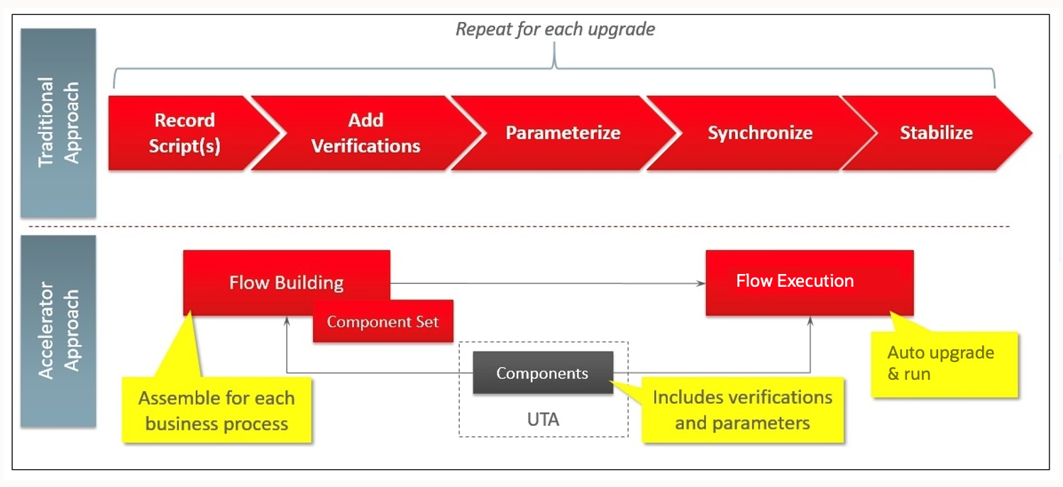

Typically, automation development is a time consuming exercise and teams have challenges in knowing and implementing the industry best practices and automation tools that work best for their product technology stack, helping them be successful in their efforts. Few of such challenges are:
• Selecting an automation tool
• Creating the automation framework
• Identifying the automation development methodology
• Ensuring the automated tests are updated for new releases
• Ensuring the coverage levels are up to date
• Configuration management of automated test programs
The metadata-driven automation development methodology provides solutions to such challenges.
For the Oracle Utilities applications built on Oracle Utilities Application Framework, web service based automated testing is proven to be more robust, maintainable, and faster to develop and execute. Oracle Utilities Testing Accelerator comprises web services and UI based components that enable creation and running of test flows.
The following sections provide the test automation development phases in which an automated test flow is created.
