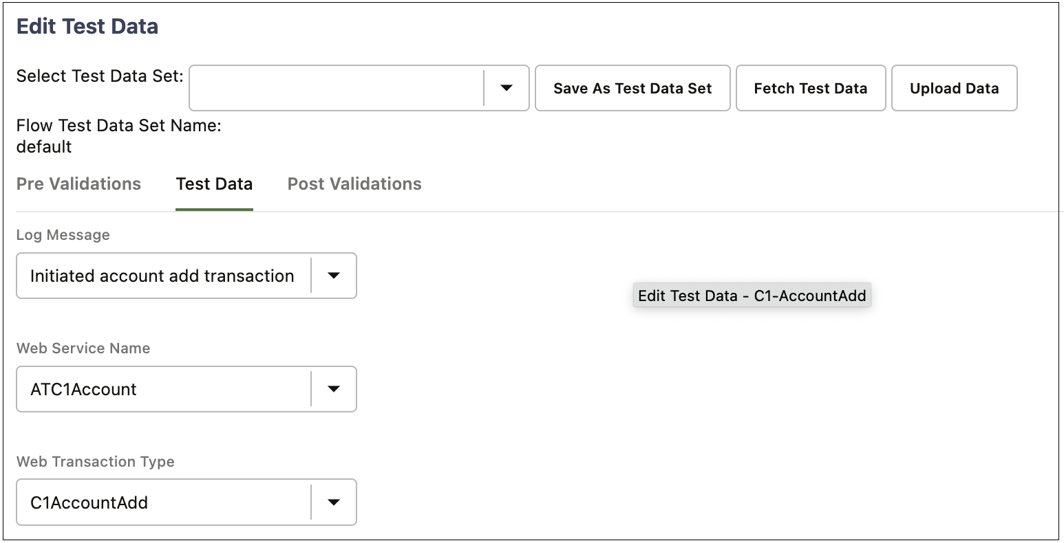

1. In the flow tree structure, click Edit Test Data icon next to the component. Alternatively, you can right-click the component and select Edit Test Data.
2. Enter the test data in the Test Data page. The Webservice Test Data page has 3 sections.

b. Test Data
The test data corresponding to each of the elements in the component can be specified in the Test Data GUI.
• The Web Service Name and Web Transaction Type fields help define the web service end point to which the request needs to be posted to during the test execution. Most of the components have the web service name and transaction type specified as the default data in the component definition. You can select the corresponding values by clicking on the test data drop down corresponding to the web service name/transaction type fields and selecting the value under the Default Data section in the list of values.

• The
Log Message field appears for most of the components that have this option enabled. This is free text field and any value entered in this field will be added to the flow run summary report. This helps to identify what a component step does in a flow, by looking at the summary report.

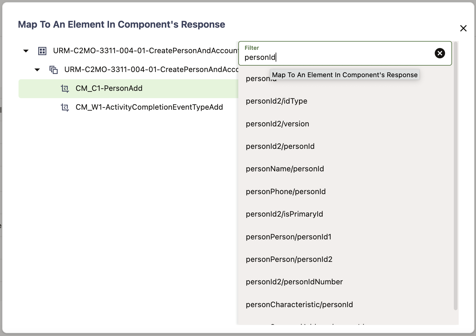

Moving Data Between Components without Using Global Variables
Test data can be linked/moved from the response of one component to the input test data field of a subsequent or a later component without using global variables. You can directly select and map the component data fields so the corresponding values are mapped.
To invoke the GUI that supports this mapping feature, click the Search icon next to the input test data fields in the Flow Test Data page.

3. From the list, select Data From...
In the example, the test data page corresponds to C1-AccountAdd component in the flow, which has C1-PersonAdd component preceding the C1-AccountAdd component.
The flow tree structure up to the preceding component of the current component is displayed.
4. Click the component from whose response the value should to be mapped. The corresponding elements in the component is displayed.
5. Select the element from the component’s response whose value needs to be mapped to this field in the current component. The filter at the top of the xpath attributes can be used to quickly find the xpath that is needed.
In the case of the example, select the personId field from the C1-PersonAdd component.
The test data field is populated with the selected element. “-->” is prefixed to the selected element name to differentiate it from the global variables and static test data.
This section explains the usage of global variables to pass data across components.
In a simple test flow, add a new person in Oracle Utilities Customer Care and Billing and add a customer contact for that person. The C1-CustomerContactAdd component is a dependent component and during runtime needs the ID of the person, created using C1-PersonAdd component within the same flow.
To add component references to a dependent component (C1-CustomerContactAdd):
1. In the Edit Test Data GUI of the C1-CustomerContactAdd component, find the component line that requires the personId as input.
2. Against the personId row, click the downward arrow to open the Test Data drop-down list. All variables exposed by the preceding components are diaplayed in the Global Variables section.
In this case, personId exposed by the C1- PersonAdd component.
3. Select the personId variable from the drop down list and set it as test data against this element.
Each of the base components expose one or more global variables that hold the output of the component during execution. These global variables can be used to set the output of one component as the input of another component.
Additionally, global variables are also created to hold output of functions used in pre-validations or post-validations sections. These global variables are defined in the Output Variable field and are to be set against only functions that return an output value. These function based global variables are automatically pre-fixed with “fVar_” and these can be used as input in the test data of subsequent steps in the flow.
All the global variables are automatically suffixed with their occurrence number. If the C1-PersonAdd component is used twice in the flow, there will be two variables (gVarPersonId1, gVarPersonId2) one for each occurrence of the component, suffixed with it's occurrence number. Custom global variables can be defined and exposed by the components through the Pre-Validations and Post Validations sections. These variables are automatically prefixed with “fvar_”, to differentiate them from the component's base global variables. These variables are also suffixed with their occurrence number in the flow, similar to the global variables specified in the component definition.

Instead of manually entering the test data for a component, you can fetch the test data from a Utilities application (such as Customer Care and Billing, Meter Data Management, etc.). Select the User, Flow configuration and provide the web service name and the transaction/operation name to access the WSDL and then provide values against required fields that are mandatory for the specified operation. Oracle Utilities Testing Accelerator calls the WSDL with provided details and fetches the response from web service and populates in the test data of the component.
To fetch the test data:
1. Navigate to the Flows tab.
2. Select and right-click the flow and then click Create/Update Flow Structure.
3. On the Flow Definition page, navigate to the component. Right-click and select Edit Test Data.
4. On the Edit Test Data page, click Fetch Test Data.
5. On the
Fetch Test Data page, enter in the web service name from which the test data has to be retrieved, operation (typically READ operation) to invoke and necessary credentials and any required info (for example: to retrieve data related to ToDoRole).
6. Enter the WSDL name and operation name. Select the user and flow configuration set. Click Populate Form to populate the form with all fields that the web service supports.
Alternatively, use the URL and user credentials from the Flow/User Configuration properties file. Click Use Configuration Properties and select the appropriate flow/user configuration from the respective drop-down menus.

As part of the flow development, test data needs to be provided for a component in a flow. After the test data is added, a component may have to be unit tested to make sure that the provided test data gets the flow working as expected.
To unit test a component that is part of a flow:
2. Select and right-click the flow. Click Create/Update Flow Structure.
4. On the Edit Test Data page, provide the web service name in the component's test data. Also, provide the operation name/transaction type in the appropriate component's test data field. Fill up all the test data for the component as necessary.
5. Save the test data and click Close.
6. On the Flow Definition page, click the Test Component icon next to the component name. Alternatively, you can right-click the component and select Test Component.
This will open up the conversational test data entry screen for the component.
7. Select the flow and user configuration needed to test the component. Click OK.
8. Click Send to post the request to the application being tested. Clicking Send does not save the data into the test data of the component being tested.
9. After receiving the response, validate it (for errors) to see if the test data provided is appropriate. Else, adjust the test data and click Send to send a new request to the application being tested.
10. Repeat step 9 till the expected response is obtained.
11. Once the appropriate test data is set and the response is as expected, click Save to save the updated test data into the component's test data in the flow.
Note: Clicking Save will only replace any static values provided in the component's test data for a given element. If the Test Data field for a component line contains a global variable, the variable in the field will not be replaced by the static data in the request being saved.

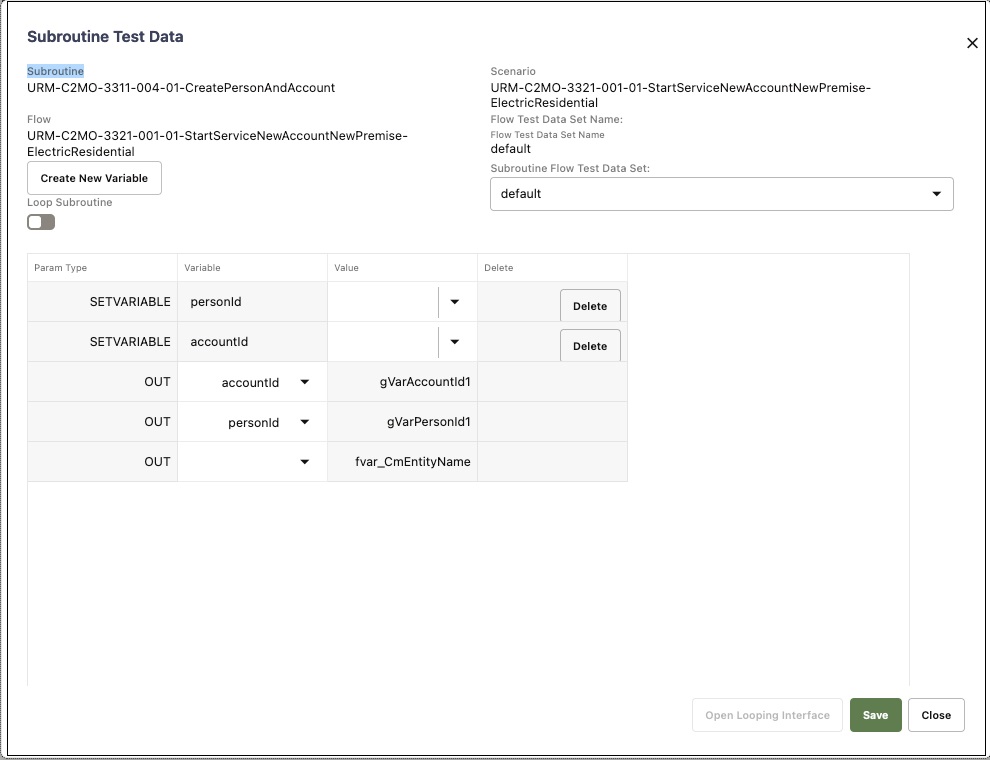

Flow Subroutines
A flow subroutine is a flow that can be included/used in other flows. It improves reuse of a flow. For example: Many test cases expect a ‘V’ setup to be available before being able to verify some business test cases. In this case, create a flow for ‘V’ setup and all other test case flows can reuse this ‘V’ setup flow as a subroutine in their respective flows. Specify any variables/parameters that the subroutine expects from the parent flow and also expose any variables/parameters that are created in the subroutine. Right-click Edit Test Data on the flow subroutine component in the flow.
• For a given flow test data set pertaining to the flow calling the subroutines, the test data set of the subroutine can be selected in the subroutine's test data GUI. Right-click the subroutine and select Edit Test Data.
• Only the variables defined in the default test data set of a subroutine flow can be used as input or output of the subroutine. This is to ensure standardized API for the subroutine.
Adding Subroutines to a Flow
To add an existing flow as a subroutine in a flow:
1. Right-click the scenario/component in the flow.
2. Select Add SubRoutine.
3. Specify the Release, Product Family, and Product to filter the flows.
4. From the Flows drop-down list (search-able), select the flow to be included.
5. Click Add to add it to the current flow as a subroutine.
• A flow cannot be added to itself as a subroutine. Make sure that nested subroutines do not create a cyclic dependency.

5. After a subroutine is added to a flow calling a subroutine, map the input or output variable(s) of the subroutine.
a. Right-click the subroutine in the flow tree structure of the calling flow and select Edit Test Data.
b. Map the input/output variable of the subroutine to a variable in the calling flow.
Example: The subroutine might be exposing accountId as the variable. To use the exposed variable in the calling flow, create a new variable in the calling flow using Create New Variable. Map the output accountId variable from the subroutine flow to the newly created variable in the calling flow. This new variable can be used in the test data GUI of any component that succeeds the subroutine in the calling flow.
This figure shows the Edit Test Data screen for a subroutine that outputs a personId and accountId. New variables, personId and accountId are created and the outputs of the subroutine are mapped to the variables (gVarAccountId1 and gVarPersonId1).

Component Test Data Sets
The component level test data sets allow to create test data sets specific to the component. These can be thought of as master test data sets for a component.
Example: For a C1-PremiseAdd component in Oracle Utilities Customer Cloud Service, the component level test data sets can be residential premise test data set and commercial premise test data set. Every time the C1-PremiseAdd component is used in a flow, instead of filling up the test data manually, the appropriate component test data set can be selected which automatically populates the test data from the component test data set into the component's test data GUI in the flow. This reduces a lot of work while providing test data in a flow.
Component test data sets save current test data of a component with a given name, which can later be retrieved and auto-populated it into another instance of the component either in the same flow or another flow.
Creating Reference Test Data for a Component
Save the current test data of a component for future use by saving it as a component test data set. After saving the test data set, the component can be populated with the test data contained in a Test Data Set. On the Edit Test Data page, select Test Data Set from the drop-down menu.
To create a test data set:
1. Login to Oracle Utilities Testing Accelerator.
2. On the Flows menu, navigate to the flow in which the component is used. Right-click and select Create/Update Flow Structure to open the Flow Definition page.
3. Navigate to the component for which the test data set needs to be created. Right-click the component and click Edit Test Data.
4. Click Save As Test Data Set to save the test data of the component. Specify the name of the test data set and click Save. Then, click OK to return to the Edit Test Data page.
Note: If a test data set with the same name already exists, the application asks for confirmation to overwrite the test data.
