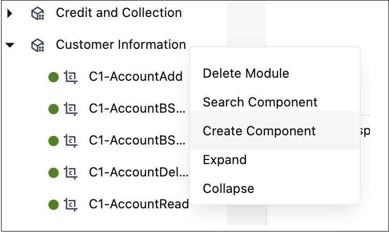

To create a web service based component manually:
1. Navigate to the component tree where the component has to be created.
2. Right-click the feature (release/product/module) in the component tree.
Note: Create a new feature folder if it is not found in the delivered tree structure.
3. Select Create Component.
Note: The component name must be prefixed with ‘CM’ and the Tags field should have a CM tag for every component. The tagging enables porting the custom components to latest Oracle Utilities Testing Accelerator release.

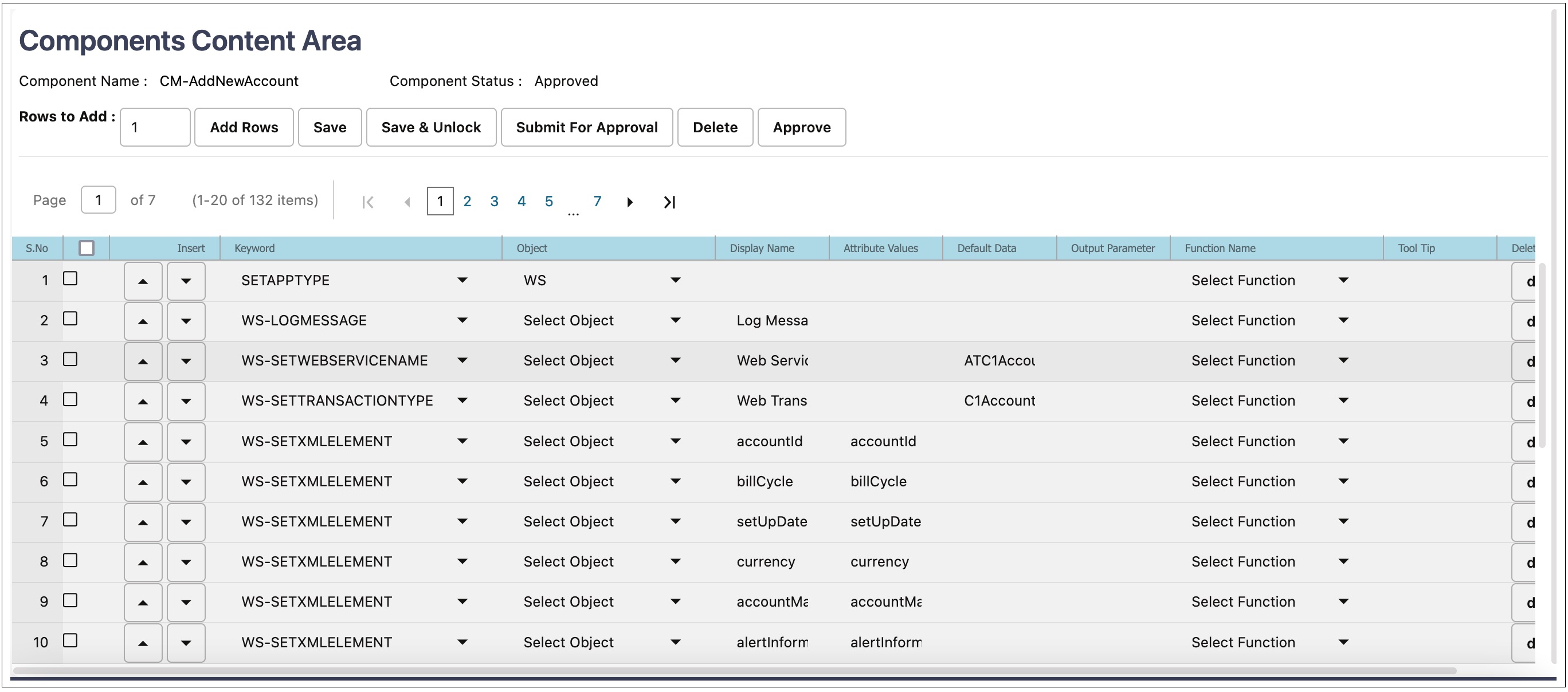

Creating a Component Definition
A component consists of several component definition lines. Each component definition line comprises a keyword, object, display name, attribute values, default data, function name, and output parameters.
The following list describes each entity in a component definition:
• Keyword: Defines the action to be performed by the component line. Example: WS-SETVARIABLEFROM RESPONSE, WS-VALIDATE, etc
• Object: The name of the function library whose functions may be used for defining a component.
• Display Name: Description of the component line that is made visible to the user while entering test data against the component line in a flow.
• Attribute Values: The xpath of the component's element as defined in the Oracle Utilities Enterprise application.
• Default Data: The default data that may be used while providing test data for a component in a flow.
• Function Name: The name of the function that is used as a plugin to perform actions such as generating randomized test data or performing validation on web service response values.
• Output Parameters: If a function returns an output, the output can be stored in a variable which is defined against the Output Parameters field. This variable can be used across components in a flow to pass test data from one component to another.
• Tooltip: The information presented as a tool tip during the flow creation.
The following figure shows the
Component page with the available component definitions.
Add the required component definition lines using the Keyword drop-down list to define the web services based component.
For a list of keywords used to define the web service based components, refer to Appendix A: Web Service Component Keywords.
The following example shows different component lines created for the CM-MobileWorker component.
1. Select SETAPPTYPE in the Keyword drop-down list to define the component type.
2. Select WS in the Object drop-down list to denote that it is a web service based component.
3. Select the WS-SETWEBSERVICENAME keyword to allow for the web service name to be set for this component in a flow.
4. Select the WS-SETTRANSACTIONTYPE keyword to allow for the transaction type of the web service call to be set for this component, in a flow.
Note: The final script of a component is web service call to create, update, and delete.
5. Select the WS-LOGMESSAGE keyword to log comments in component step as part of a flow run. This helps in better understanding of the Flow run results in which the component is used.
6. Select the WS-SETXMLELEMENT keyword to allow test data to be set against a specific element of request XML.

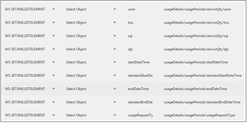

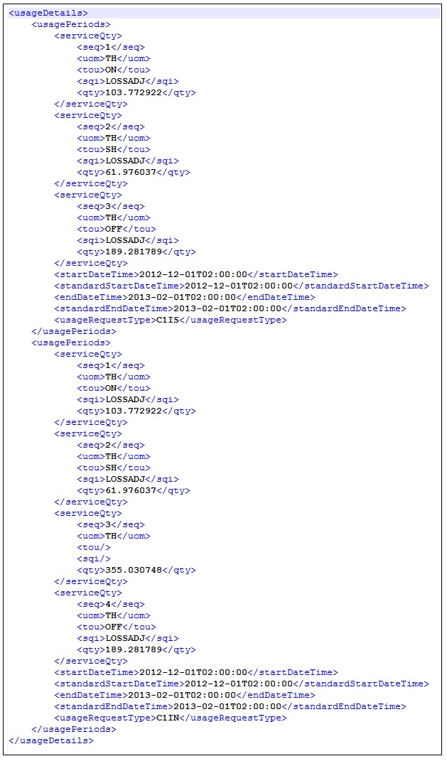

Handling the List Elements
The list elements of a schema should be defined using the keyword WS-SETXMLLISTELEMENT.
Consider the following partial schema. Note that the node usageDetails has a usagePeriods list element which in turn has another list element serviceQty and other non-list nodes (leaf nodes) (such as startDateTime, standardStartDateTime, endDateTime, etc.,). The list node serviceQty has non-list nodes such as seq, UOM, TOU, etc.
To define this schema in the component, consider the non-list nodes and enter a row for each of them, with the keyword as WS-SETXMLLISTELEMENT and Attribute value as the full xpath of the element, making sure to enter the appropriate Display names.
Note: If any of the list nodes repeat (serviceQty occurrs thrice inside usagePeriods, which in turn occurrs twice in usageDetais), do not define the elements multiple times in the component definition. The number of occurrences can be controlled in the test data (as defined in the
Providing Test Data section).

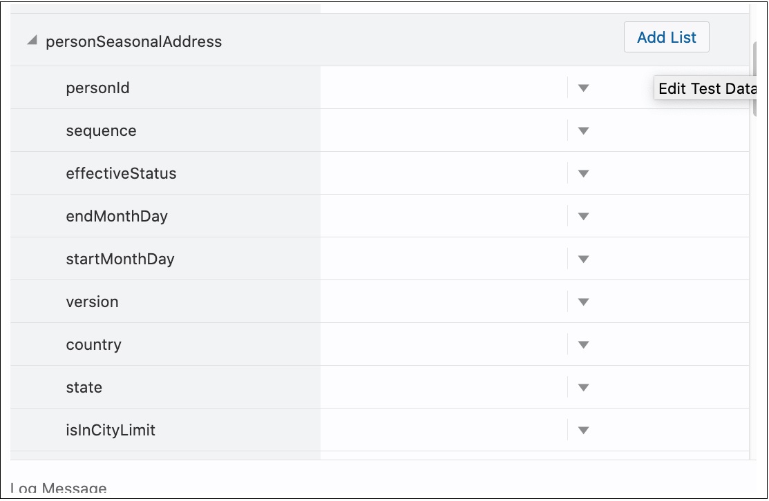

Providing Test Data
On the Test Data page, each of the list nodes (usageDetails, usagePeriods and serviceQty for example) has an Add List button next to them under the Action column and are expandable. Expand the list node to view the children of that particular node.
Example: Expand usageDetails to view usagePeriods, and expand usagePeriods to view serviceQty, startDateTime, standardStartDateTime, etc.
Initially only one instance exists for all the list nodes. To add more nodes, click Add List next to the desired element under the Action column.
Example: To have two instances of usagePeriods inside usageDetails, click Add List next to usagePeriods. There will be two usagePeriods nodes inside usageDetials, each of which will have the same content.
To view three serviceQty nodes in the first usagePeriods node and four in the second one:
1. Expand the first usagePeriods and add three serviceQty nodes.
2. Expand the second usagePeriods and add four serviceQty nodes.
The complete structure of the final schema is ready. You can add data to all the leaf nodes.

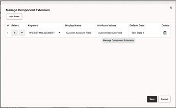

Base components that are delivered by the product in Oracle Utilities Testing Accelerator can be extended to add additional custom elements in the component definition. Custom elements can be added to the component definition through the component definition GUI. When a flow is built using this extended component, test data can be provided for both the base and extended schema elements through the same test data GUI in the Flow Definition screen. Extended elements in the component definition can be added or removed based on the requirement, across upgrades.
To add new custom elements to the component definition:
1. Login to the application.
2. Navigate to the Components menu.
3. On the left pane, navigate to the module where the new component needs to be added.
4. Right-click the component and select View Component.
5. In the
View Component screen, click
Extend Base Component.
6. In the Manage Component Extension GUI, select the “WS-SETXMLELEMENT” or “WS-SETXMLLISTELEMENT” keywords depending on whether the custom element to be added is a list or an individual element.
7. Add one or more rows based on the requirement.
8. Provide the following information for each row:
• Display Name: The description visible in the flow’s test data GUI against this custom element.
• Attribute Values: The xpath of the element or list element in the Oracle Utilities Application Framework object’s schema.
• Default Data: The data provided in this field is available as default data in the element’s
Test Data field, in the flow’s
Test Data GUI.
9. Click Save to add the custom component lines to the base component.
