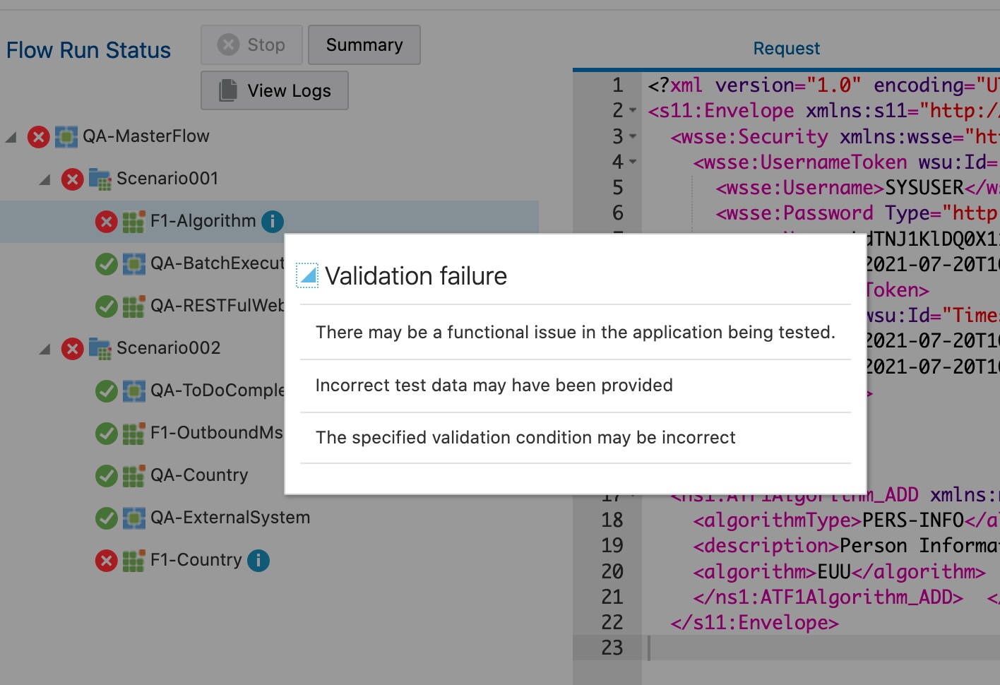

Viewing Flow Run Failure Details
If a flow run fails, the possible reasons for failure can be viewed. Click the Info icon next to the failed component step in the Flow Run Status tree structure.
To view the failure details for a flow run:
1. Login to Oracle Utilities Testing Accelerator.
2. Navigate to the Flow menu.
3. On the left pane, navigate to the flow and right-click it to view the run summary. Click View Run History.
4. Click the flow run entries to view the respective details of that run.
5. Click the Info icon next to the failed component step in the flow run. The error is displayed along with a list of possible reasons leading to the error.

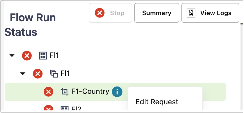

The Edit Request feature allows to:
1. Open the failed request of a component.
2. Make changes to the test data and resend the request to edge application (without running the flow multiple times).
3. Observe the response for the modified request.
4. Save the modified request as test data for the flow’s component step.
Repeat the above steps until the test data for the successful request is identified.
The Edit Request feature can be accessed from the flow structure screen/flow run interface (including from flow run history, flow set run/history, iterative run/history). User can invoke the Edit Request user interface. Right-click a component from the flow run status tree and selecting the Edit Request option.
After selecting the Edit Request option from the right-click menu, a new window is displayed and prompts to select the configuration sets to be used. Modify the request by either changing test data value of one or more elements, adding/deleting new elements in the request and click Send to send the request to the application being tested and observe the response. Continue to make modifications until the desired response is received from the edge application.
The user has below options to manage request content better:
Repopulate all schema elements. Click Refresh Schema. This helps in resetting fields that are required to make a successful request that were not present/left out in the previous/original request.
Click Settings to allow the user to control some header level information that is sent as part of the request, including username token, timestamp and whether the request should include any schema elements that do not have any test data filled in.
Choose to save the test data of the request to a flow test data set. Click Save to select the flow test data set to which the test data needs to be saved to in the dialog box.
Note: While saving the test data in the request XML in to the component step's test data, only static test data values defined in the component are replaced. The variables defined in the component's test data are not replaced with the test data in the XML request.
