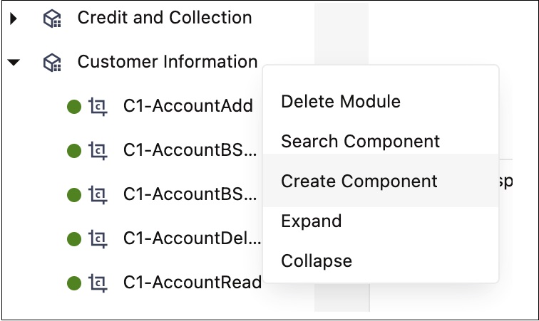

1. Navigate to the component tree where the component has to be created.
2. Right-click the feature (release/product/module) in the component tree.
Note: Create a new feature folder if it is not found in the delivered tree structure. Creating a new feature folder if it is not found in the delivered tree structure.
3. Select Create Component.
Note: The component name must be prefixed with ‘CM’ and the Tags field should have a CM tag for every component. The tagging enables porting the custom components to latest Oracle Utilities Testing Accelerator release.

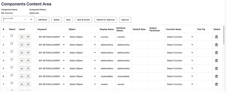

7. Click Attach Code to add the metadata. The Component window is displayed.
8. Create component definitions.
9. Click Save & Unlock to save and create the component.

The following figure shows the Component page with the available component definitions.
Add the required component definition lines using the Keyword drop-down list to define the web services based component.

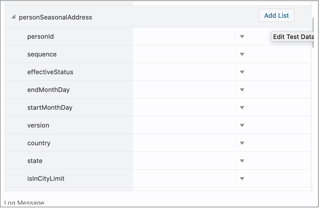

Providing Test Data
On the Test Data page, each of the list nodes (usageDetails, usagePeriods and serviceQty for example) has an Add List button next to them under the Action column and are expandable. Expand the list node to view the children of that particular node.
Example: Expand usageDetails to view usagePeriods, and expand usagePeriods to view serviceQty, startDateTime, standardStartDateTime, etc.
Initially only one instance exists for all the list nodes. To add more nodes, click Add List next to the desired element under the Action column.
Example: To have two instances of usagePeriods inside usageDetails, click Add List next to usagePeriods. There will be two usagePeriods nodes inside usageDetials, each of which will have the same content.
To view three serviceQty nodes in the first usagePeriods node and four in the second one:
1. Expand the first usagePeriods and add three serviceQty nodes.
2. Expand the second usagePeriods and add four serviceQty nodes.
The complete structure of the final schema is ready. You can add data to all the leaf nodes.Shows the Add List button in the Test Data page.

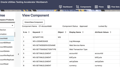

2. Navigate to the Components menu.
3. On the left pane, navigate to the module where the new component needs to be added.
4. Right-click the component and select View Component.
5. In the View Component screen, click Extend Base Component.Shows the Extend Base Component button.

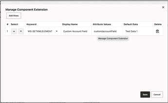

6. In the Manage Component Extension GUI, select the “WS-SETXMLELEMENT” or “WS-SETXMLLISTELEMENT” keywords depending on whether the custom element to be added is a list or an individual element.
7. Add one or more rows based on the requirement.
8. Provide the following information for each row:
• Display Name: The description visible in the flow’s test data GUI against this custom element.
• Attribute Values: The xpath of the element or list element in the Oracle Utilities Application Framework object’s schema.
• Default Data: The data provided in this field is available as default data in the element’s Test Data field, in the flow’s Test Data GUI.Shows the Manage Component Extension GUI.
9. Click Save to add the custom component lines to the base component.
