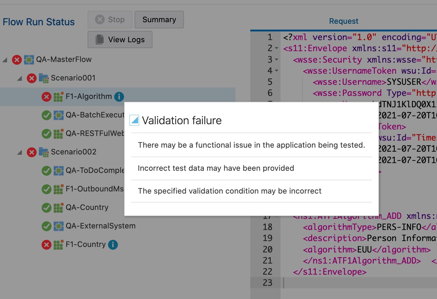

Viewing Flow Run Failure Details
If a flow run fails, the possible reasons for failure can be viewed. Click the Info icon next to the failed component step in the Flow Run Status tree structure.
To view the failure details for a flow run:
1. Login to Oracle Utilities Testing Accelerator.
2. Navigate to the Flow menu.
3. On the left pane, navigate to the flow and right-click it to view the run summary. Click View Run History.
4. Click the flow run entries to view the respective details of that run.
5. Click the Info icon next to the failed component step in the flow run. The error is displayed along with a list of possible reasons leading to the error.

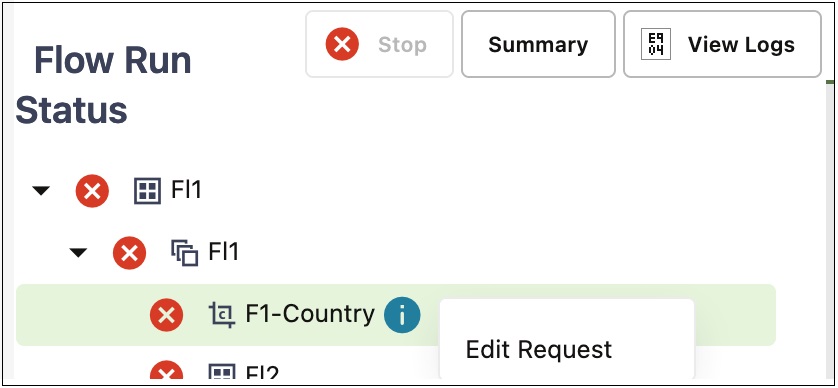

Conversational Test Data Management
As an alternative to the Edit Test Data GUI, test data can also be provided in XML format through the conversational Test Data Entry page. Before accessing this GUI, the component's test data needs to be populated by providing the web service name and the transaction type.
To navigate to the Conversational Test Data GUI, right-click the component in the flow tree structure (in flow development screen) and select Edit Request.
Note: This feature is only supported for web service components.
The Edit Request feature allows to:
1. Open the failed request of a component.
2. Make changes to the test data and resend the request to edge application (without running the flow multiple times).
3. Observe the response for the modified request.
4. Save the modified request as test data for the flow’s component step.
Repeat the above steps until the test data for the successful request is identified.
The Edit Request feature can be accessed from the flow structure screen/flow run interface (including from flow run history, flow set run/history, iterative run/history). User can invoke the Edit Request user interface. Right-click a component from the flow run status tree and selecting the Edit Request option.
After selecting the Edit Request option from the right-click menu, a new window is displayed and prompts to select the configuration sets to be used. Modify the request by either changing test data value of one or more elements, adding/deleting new elements in the request and click Send to send the request to the application being tested and observe the response. Continue to make modifications until the desired response is received from the edge application.

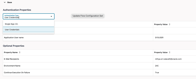

The following properties are available by default:
• Base Category: Lists the properties that are common for SOAP and REST based web services. This category is further divided into the following:
• Authentication Properties
• Application URL: The common web service’s end point URL of the application that is being tested needs to be specified against this property.
Note that for Oracle Utilities Testing Accelerator that is available as part of Oracle Utilities Enterprise cloud services, the corresponding environment's URL is predefined within Oracle Utilities Testing Accelerator. Users need not provide the Application URL for the same. However, users can provide the user name and password for authentication.
• Authentication Type: Select User Credentials based authentication from the Authentication Properties drop-down list to provide the Application User Name and Application User Password. This option uses basic authentication for web service authentication with the application being tested.
If the Authentication Type is set as “Single Sign-On”, then the username and password need not be provided. The Single Sign-On federated authentication is used for web service authentication with the application being tested. Selecting the Single Sign-On option automatically removes the username and password from the view and sets the SSO Federated Login to “true”.
This parameter can be set to “Single Sign-On” only in Oracle Utilities Testing Accelerator that is available as part of Oracle Utilities Enterprise cloud services. For Oracle Utilities Testing Accelerator on-premises installations, this option cannot be used.
Shows the Authentication Type options available.
• Application User Name: The user name for authentication of the web services of the application being tested needs to be specified here, if the Authentication Type is “User Credentials”.
• Application User Password: The password corresponding to the above application user name for authentication of the web services of the application being tested needs to be specified here, if the Authentication Type is “User Credentials”.
• SSO Federated Login: In the flow configuration set or the user configuration set, the Single Sign On Federated Login parameter can be set to “true”, in which case, the web service request from Oracle Utilities Testing Accelerator to the corresponding Oracle Utilities cloud service will use the current user’s Single Sign On authentication, implicitly. This is automatically set to “true” if the Authentication Type is set to “Single Sign On”.

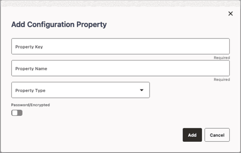

To create a custom property:
1. Click Add Property in the Update Flow Configuration Set or Update User Configuration Set section.
2. Enter the following details:
• Property Key: An unique identifier for the property.
• Property Name: A descriptive name for the property.
• Property Type: Choose between “Text” and “Boolean” based on the type of property that is being added. Selecting “Boolean” as the property type will limit the user input in the flow and user configuration sets to just “true” or “false” that can be selected from a drop down.
• Password/Encrypted: Enable this flag to specify if the custom property needs to be encrypted. Enabling this flag will automatically encrypt any user input against the property in the flow and user configuration sets.
3. Click Add to create the configuration property.

Editing a Flow Configuration Set
1. Login to the application.
2. Navigate to the Tools menu.
3. On the left pane, click Flow Configuration Sets.
4. On the Manage Flow Configuration Sets page, search for the flow configuration set to be edited, and click Edit.
5. On the Update Flow Configuration Set page, click Add Property to either enter a value for the existing property or choose to create a new property.
Important! It is required that sensitive information (such as passwords) be encrypted.
Editing a User Configuration Set
3. On the left pane, click User Configuration Sets.
4. On the Manage User Configuration Sets page, search for the user configuration set to be edited, and click Edit.
5. On the Update User Configuration Sets page, click Add Property to either enter a value for the existing property or choose to create a new property.
Important! It is recommended that sensitive information (such as passwords) be encrypted.
