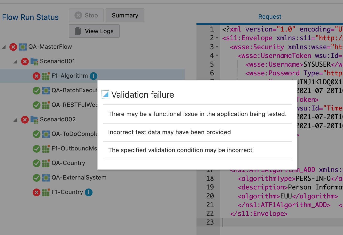

5. Click the info icon next to the failed component step in the flow run. The appropriate error is displayed along with a list of possible reasons leading to the error.
Viewing Flow Run Failure Details
If a flow run fails, the possible reasons for failure can be viewed. Click the Info icon next to the failed component step in the Flow Run Status tree structure.

5. Click the Info icon next to the failed component step in the flow run. The error is displayed along with a list of possible reasons leading to the error.

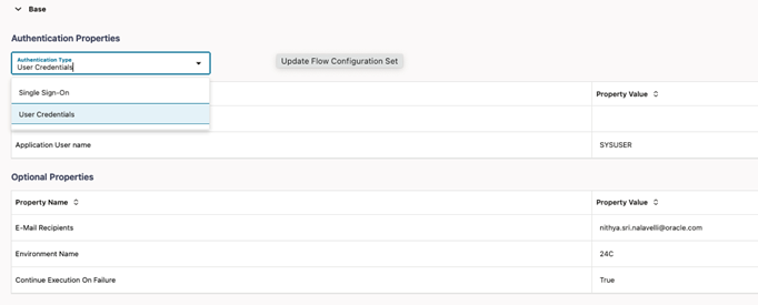

• Authentication Type: Select User Credentials based authentication from the Authentication Properties drop-down list to provide the Application User Name and Application User Password. This option uses basic authentication for web service authentication with the application being tested.
If the Authentication Type is set as “Single Sign-On”, then the username and password need not be provided. The Single Sign-On federated authentication is used for web service authentication with the application being tested. Selecting the Single Sign-On option automatically removes the username and password from the view and sets the SSO Federated Login to “true”.
This parameter can be set to “Single Sign-On” only in Oracle Utilities Testing Accelerator that is available as part of Oracle Utilities Enterprise cloud services. For Oracle Utilities Testing Accelerator on-premises installations, this option cannot be used.
Shows the Authentication Type options available.
• Application User Name: The user name for authentication of the web services of the application being tested needs to be specified here, if the Authentication Type is “User Credentials”.
• Application User Password: The password corresponding to the above application user name for authentication of the web services of the application being tested needs to be specified here, if the Authentication Type is “User Credentials”.

• Other Properties (Optional)
• Continue Execution on Failure: Setting this flag to “true” will cause a flow run to execute all the components defined in the flow, even if one or more of the component steps fail. Setting this flag to “false” will ensure that the flow execution stops at the first component step that has failed, during a flow run.
• Environment Name: A custom free text environment name can be provided to denote the environment against which the flows are/will be run. This name appears in the summary report so users reviewing the report know the environment the flow/flows were run against.
• Email Recipients: The summary report is automatically emailed to the email addresses specified against this property. Multiple email addresses can be provided, separated by a “;”(semi-colon).

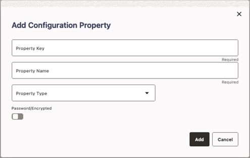

• Custom Category: Lists all custom properties that have been added to the configuration set.
To create a custom property:
1. Click Add Property in the Update Flow Configuration Set or Update User Configuration Set section.
2. Enter the following details:
• Property Key: An unique identifier for the property.
• Property Name: A descriptive name for the property.
• Property Type: Choose between “Text” and “Boolean” based on the type of property that is being added. Selecting “Boolean” as the property type will limit the user input in the flow and user configuration sets to just “true” or “false” that can be selected from a drop down.
• Password/Encrypted: Enable this flag to specify if the custom property needs to be encrypted. Enabling this flag will automatically encrypt any user input against the property in the flow and user configuration sets.
3. Click Add to create the configuration property.

4. On the Manage Flow Configuration Sets page, search for the flow configuration set to be edited, and click Edit.
5. On the Update Flow Configuration Set page, click Add Property to either enter a value for the existing property or choose to create a new property.
Important! It is required that sensitive information (such as passwords) be encrypted.
