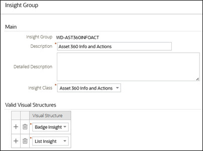

Insight Group
An insight group is required to display the Asset Info and Actions, Asset Criticality badge, and Asset Risk badge.
Create a new insight group for the Asset 360 Info and Actions:
- Insight Class: Asset 360 Info and Actions
Valid Visual Structures:
- Badge Insight
- List Insight
| Sequence | Insight Type |
| 10 | Asset Location Criticality Insight |
| 20 | Asset 360 Risk |
| 30 | Asset 360 Info and Actions |
