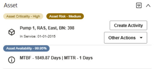

The Asset zone displays the common actions that can be taken for the asset, asset and location information, and insights for Asset Criticality, Asset Risk, and Asset Availability.
Insight Group
An insight group is required to display Asset Info and Actions, an Asset Criticality badge, an Asset Risk badge and an Asset Availability insight, including the Mean Time Between Failure (MTBF) and Mean Time To Restore (MTTR) information.

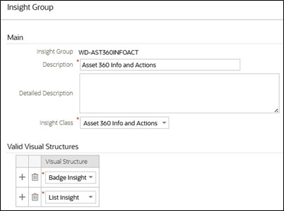

Create a new insight group for the Asset 360 Info and Actions:
- Insight Class: Asset 360 Info and Actions
Valid Visual Structures:
- Badge Insight
- List Insight
| Sequence | Insight Type |
| 10 | Asset Location Criticality Insight |
| 20 | Asset 360 Risk |
| 30 | Asset 360 Info and Actions |
| 40 | Asset 360 Availability |
| 50 | Asset 360 Availability List |

Asset Availability Insight
The Asset Availability insight is a pair of insight types to display both a badge and a list. It displays the percentage the asset has been operational (up and running) during the Inservice/Installed life of the asset. It also displays the Mean Time Between Failure and Mean Time To Restore information.

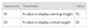

- If the asset availability is 75% and over, a blue badge (defined as the default insight color) is displayed.
- If the asset availability is between 51% and 74%, an orange badge (override severity value = 20) is displayed.
- If the asset availability is 50% and below, a red badge (override severity value = 30) is displayed.
Update the Asset 360 Availability (W1ASTAVLB) algorithm to override the default behavior above.
