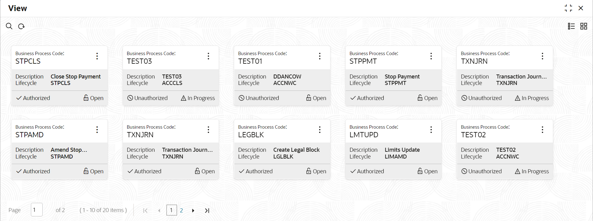

    The Configurations pane displays.
  3. Under Configurations, select Business Process and click View.
    The View screen displays.
  4. Alternatively, you can search the configuration via Menu Item Search field. Specify the configuration name Business Process and select Corporate DDA-->Configurations-->Business Process-->View.
    Figure 1-26 View Business Process
    Table 1-30 View Business Process - Field Description
    Field Description
    Business Process Code Displays the business process code.
    Description Displays the description for the business process code.
    Lifecycle Displays the lifecycle code.
    Status Displays the status of the record.
