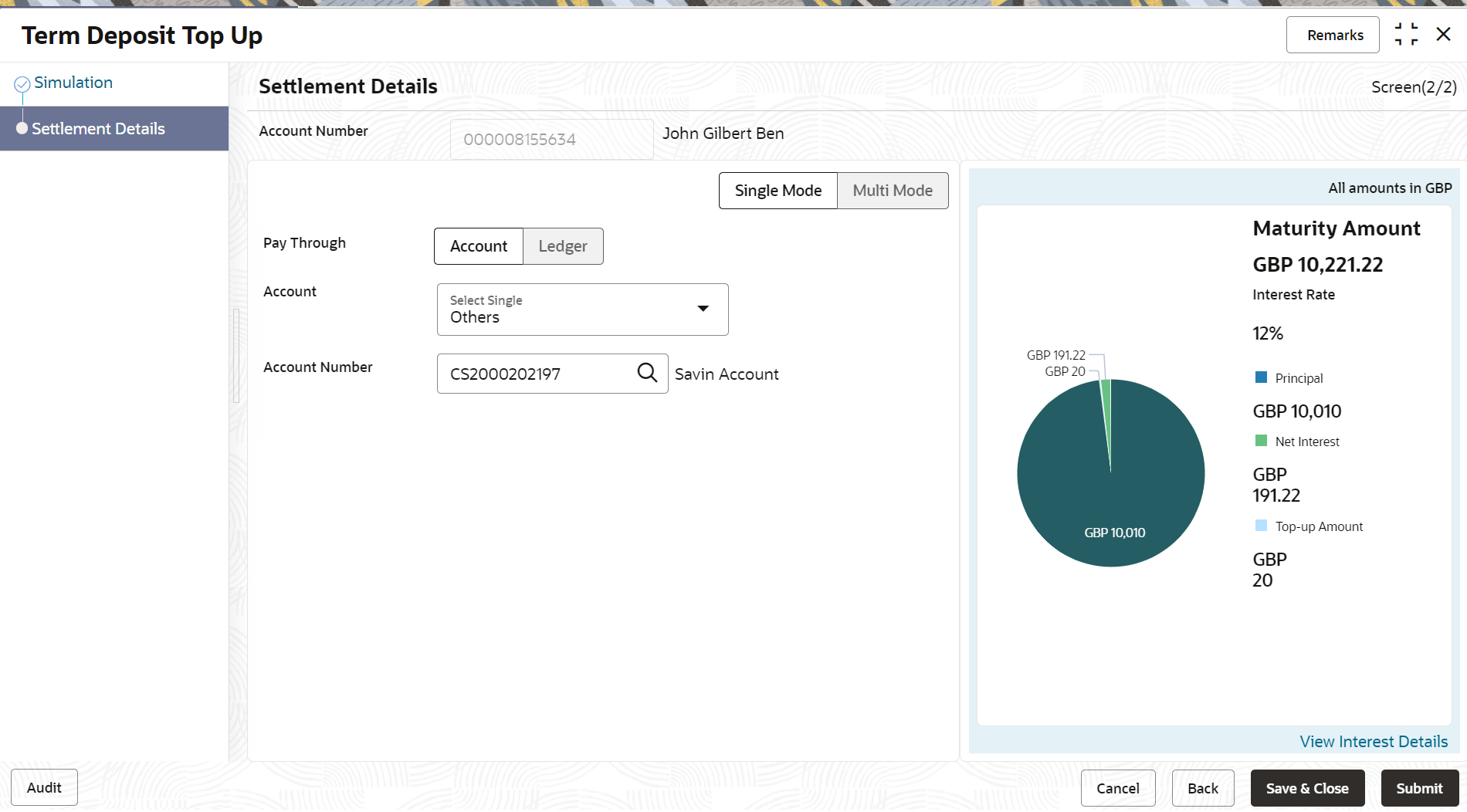

- Pay through Account - Own Account
- Select Account from Pay
Through field.The fields related to Account are displayed.
Figure 2-24 Pay through Account - Own Account
Description of "Figure 2-24 Pay through Account - Own Account" - Perform the required action for own account. For more information on fields, refer to the field description
table.
Table 2-19 Pay through Account - Own Account – Field Description
Field Description Pay Through Select the Account option to perform the settlement. Account Select the own account. Note:
For information if you select Others option, refer Pay through Account - Others.
- Pay through Account - Others
table.
Table 2-20 Pay through Account - Others – Field Description
Field Description Pay Through Select the Account option to perform the settlement. Account Select the Others option. Note:
For information if you select own account option, refer Pay through Account - Own Account.
Account Number Specify the account from which the payin to be done. Note:
The account name will be displayed adjacent to this field, upon entering Account Number.Account Amount Displays the account debit amount in account currency. Note:
This field is displayed, only if the TD currency and CASA currency are different.Exchange Rate Displays the exchange rate. Note:
This field is displayed only if there is cross currency transaction.

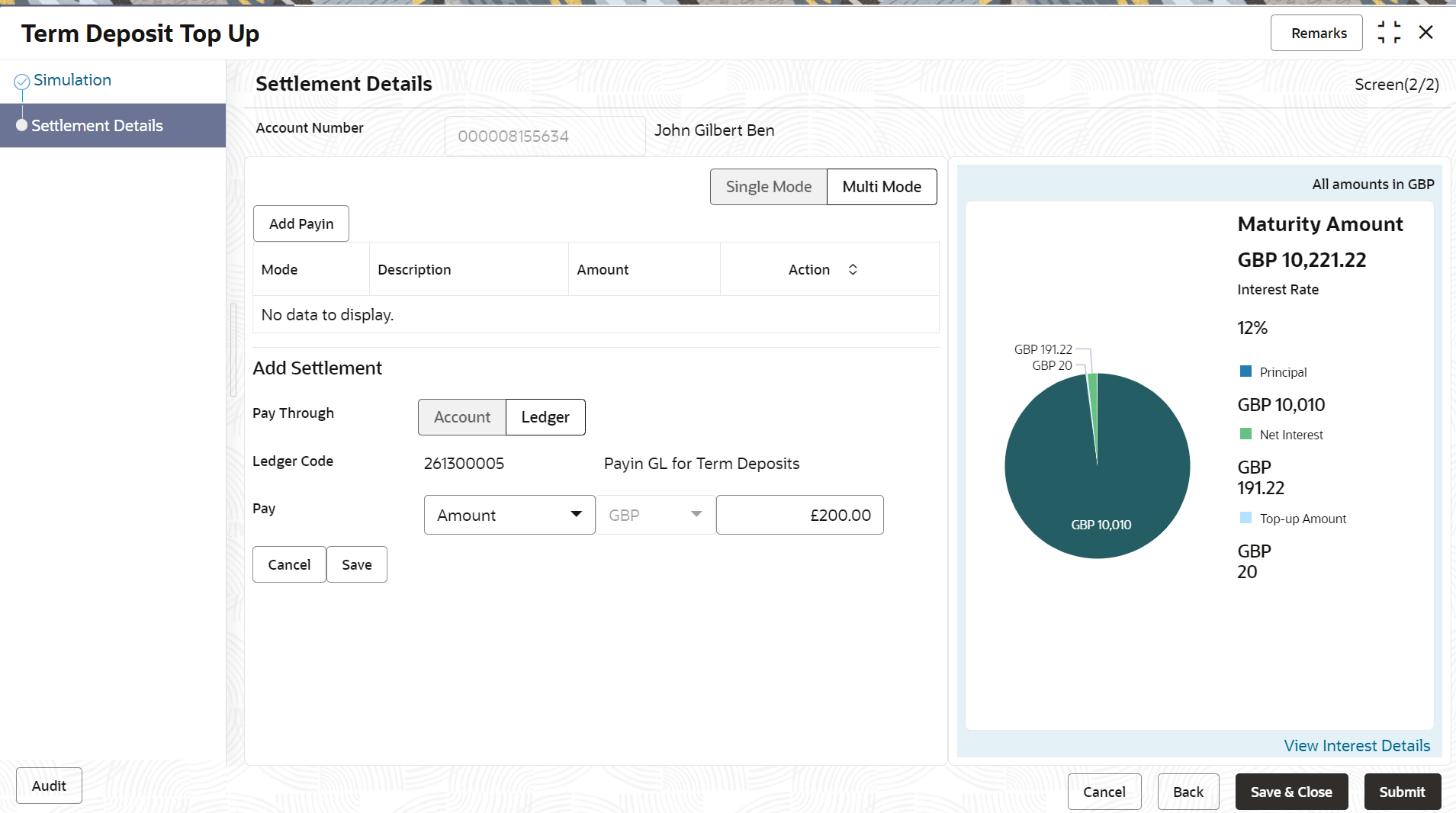

- Pay through Multi Mode Settlement
- In the Payin Details tab, click Multi
Mode.The fields to perform multi mode settlement are displayed.
Figure 2-27 Pay through Multi Mode Settlement Options
Description of "Figure 2-27 Pay through Multi Mode Settlement Options" - Click Add Payin, to add settlement modes.The Add Settlement section is displayed.
Only the Pay field is an additional field displayed in this section, remaining all fields are same as displayed in the Pay through Account - Own Account, Pay through Account - Others, and Pay through Ledger.
- Select the appropriate option from the Pay
field.
- If you select Amount option, then the currency is displayed and you need to specify the amount in the field displayed adjacent to this field.
- If you select Percentage option, then specify the percentage in adjacent field.
- Click Save.The settlement is added in the table above.
- You can edit or delete the settlement entry if required. For more information on fields, refer to the field description
table.
Table 2-22 Multi Mode Settlement Options – Field Description
Field Description Mode Displays the settlement mode. Description Displays the details available for the settlement modes. Amount Displays the amount available in the specific settlement mode. Action Click the Edit icon to edit the amount.
Click the Delete icon to delete the settlement mode.
Total Displays the total of the settlement amount. - To go back to the single mode option, click Single Mode.
