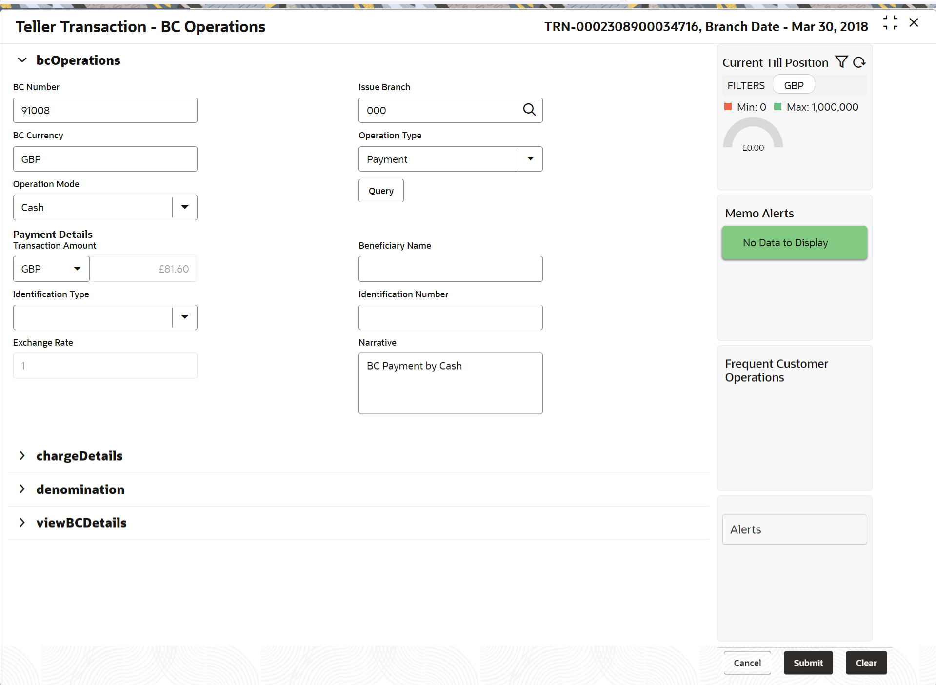

  1. On the Homepage, from Teller mega menu, under Remittances, click BC Operations or specify BC Operations in the search icon bar and select the screen.
    The BC Operations screen is displayed.
    Figure 5-11 BC Operations - Payment by Cash
  2. On the BC Operations screen, specify the fields. For more information on fields, refer to the field description table.
    The fields marked as Required are mandatory.

  3. Specify the charge details. For information on the fields in the Charge Details segment, refer to bc-payment-cash.html.
  4. Specify the denomination details. For information on the fields in the Denomination segment, refer to bc-payment-cash.html.
  5. Click on the View BC Details data segment to view the additional details of the BC.
    This data segment is non-editable.
  6. Click Submit.
    A teller sequence number is generated, and the Transaction Completed Successfully information message is displayed.
    The transaction is moved to authorization in case of any warning raised when the transaction saves.
