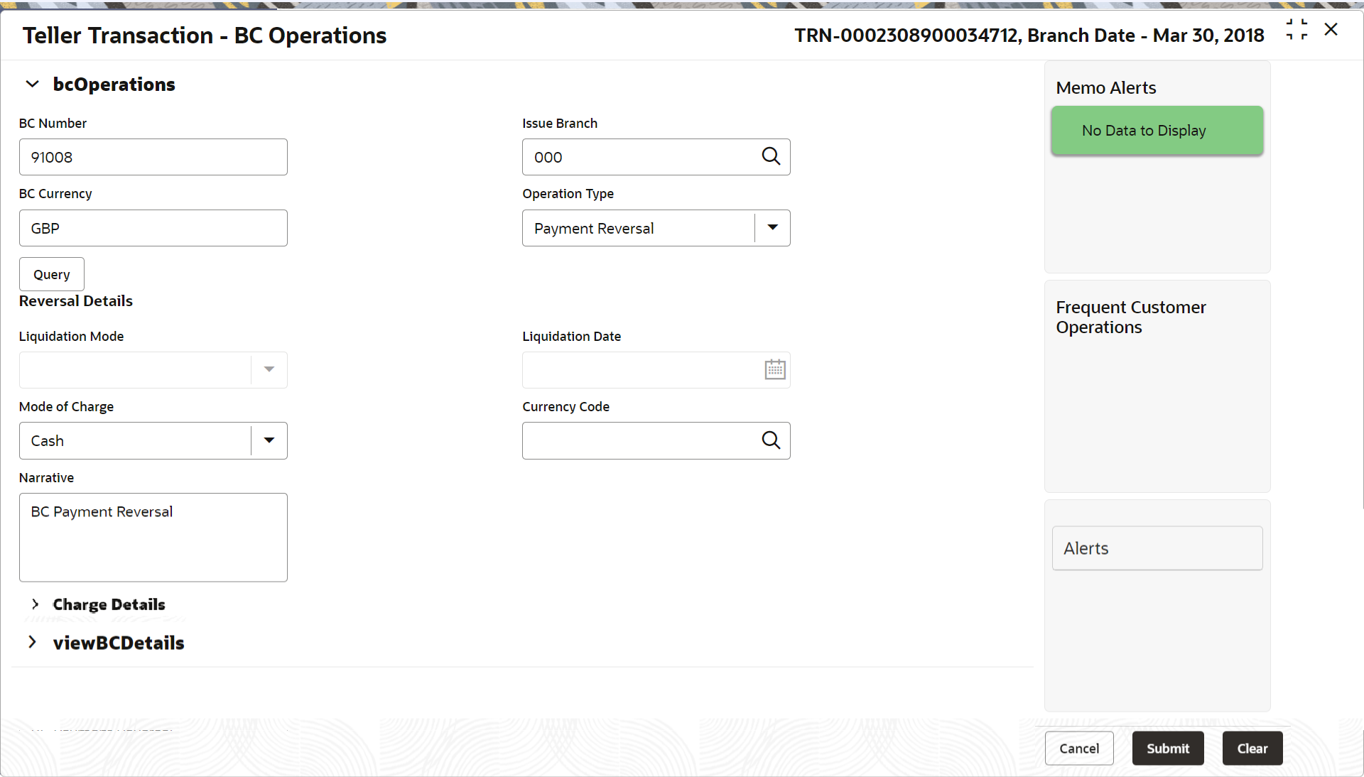

  1. On the Homepage, from Teller mega menu, under Remittances, click BC Operations or specify BC Operations in the search icon bar and select the screen.
    The BC Operations screen is displayed.
    Figure 5-13 BC Operations - Payment Reversal
  2. On the BC Operations screen, specify the fields. For more information on fields, refer to the field description table.
    The fields marked as Required are mandatory.

    BC No
    Specify the BC number of the instrument.
    Issue Branch
    Select the branch code where the instrument is issued from the LOV.
    Operation Type
    Select the type Payment Reversal from the drop-down list.
    Reversal Details
    Specify the details under this segment.
    Liquidation Mode
    Select the liquidation mode from the drop-down values.
    Liquidation Date
    Select the liquidation date.
    Narrative
    Displays the default narrative as BC Payment Reversal, and it can be modified.

  4. Click on the View BC Details data segment to view the additional details of the BC.
    This data segment is non-editable.
  5. Click Submit.
    A teller sequence number is generated, and the Transaction Completed Successfully information message is displayed.
    The transaction is moved to authorization in case of any warning raised when the transaction saves.
    On transaction submission, the system will hand off the details to the payments product processor (Oracle Banking Payments) for processing. When you get a success notification from Oracle Banking Payments, the system will update the transaction status as Success and mark for charges accounting hand off. In case of reject notification from the Oracle Banking Payments, the system will discard the transaction.
