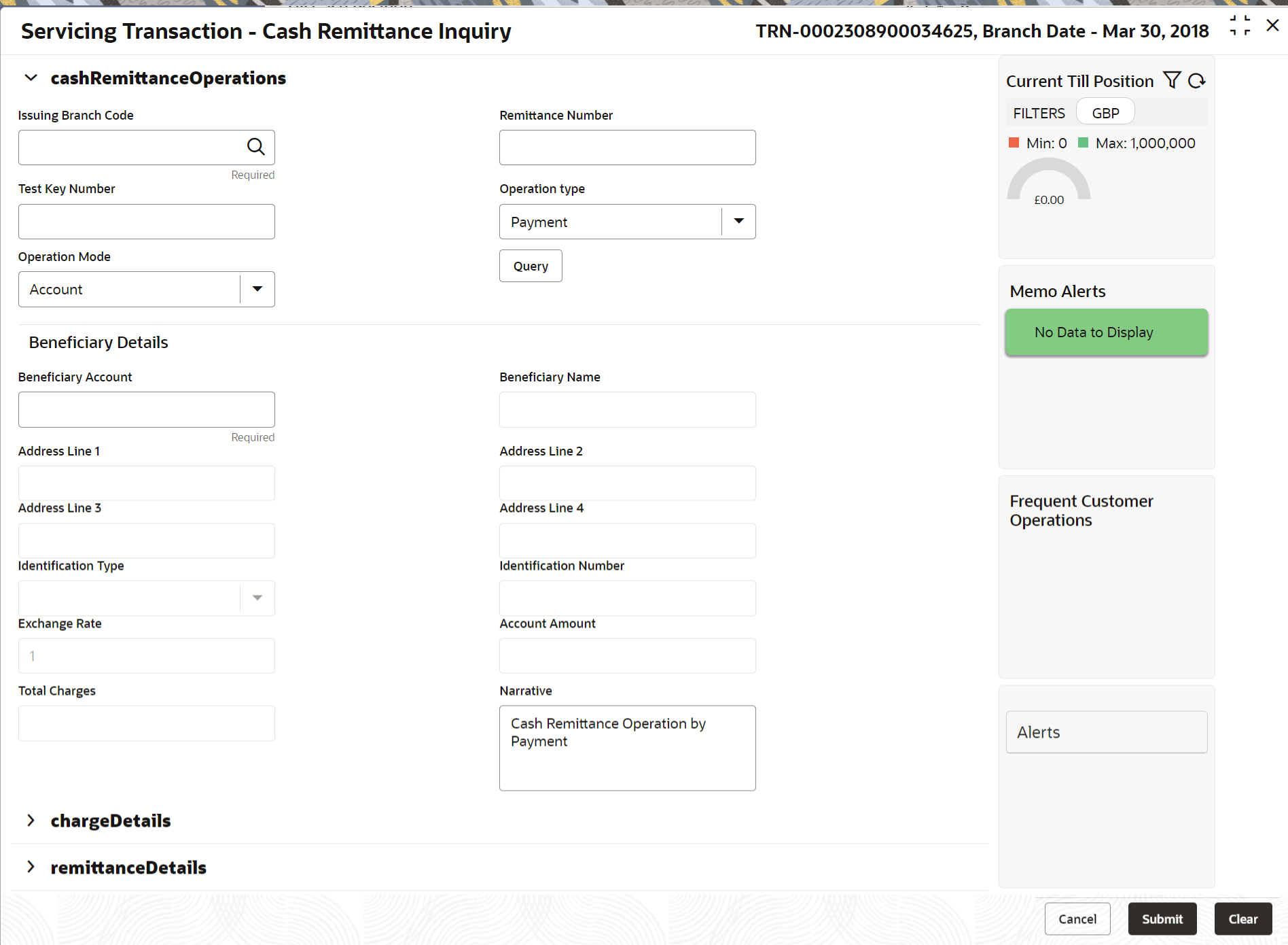

    Figure 5-49 Cash Remittance Operations (Payment by Account)
  2. On the Cash Remittance Operations screen, specify the fields. For more information on fields, refer to the field description table.
    The fields marked as Required are mandatory.
    Table 5-47 Cash Remittance Operations (Payment by Account) - Field Description
    Field Description
    Issue Branch Code
    Select the branch code where the remittance is issued from the LOV.
    Remittance No
    Specify the remittance number.
    Test Key No
    Specify the test key number.
    Operation Type
    Select the type Payment from the drop-down list.
    Operation Mode
    Select the operation mode as Account from the drop-down values.
    Query
    Click Query to fetch the remittance details.
    When you click this icon, after you specify the Issue Branch Code and Remittance No, the system will make a service call to Oracle Banking Payments and fetch the remittance details.
    Beneficiary Details
    Specify the details under this segment.
    Beneficiary Account
    Specify the beneficiary account number.
    Beneficiary Name
    Specify the beneficiary's name.
    Address Line 1 to Address Line 4
    Specify the address of the beneficiary.
    Identification Type
    Select the identification type of the beneficiary from the drop-down values.
    Identification Number
    Specify the identification number of the beneficiary.
    Exchange Rate
    Displays the exchange rate, and it can be modified.
    If the transaction currency is the same as the account currency, the system will display the exchange rate as 1. This field is displayed only if Multi-Currency Configuration at the Function Code Indicator level is set as Y.
    Account Amount
    Displays the account amount.
    Total Charge Amount
    Displays the total charge amount.
    This field is displayed only if Total Charges Configuration at the Function Code Indicator level is set as Y.
    Narrative
    Displays the default narrative as Cash Remittance Operation by Payment, and it can be modified.
