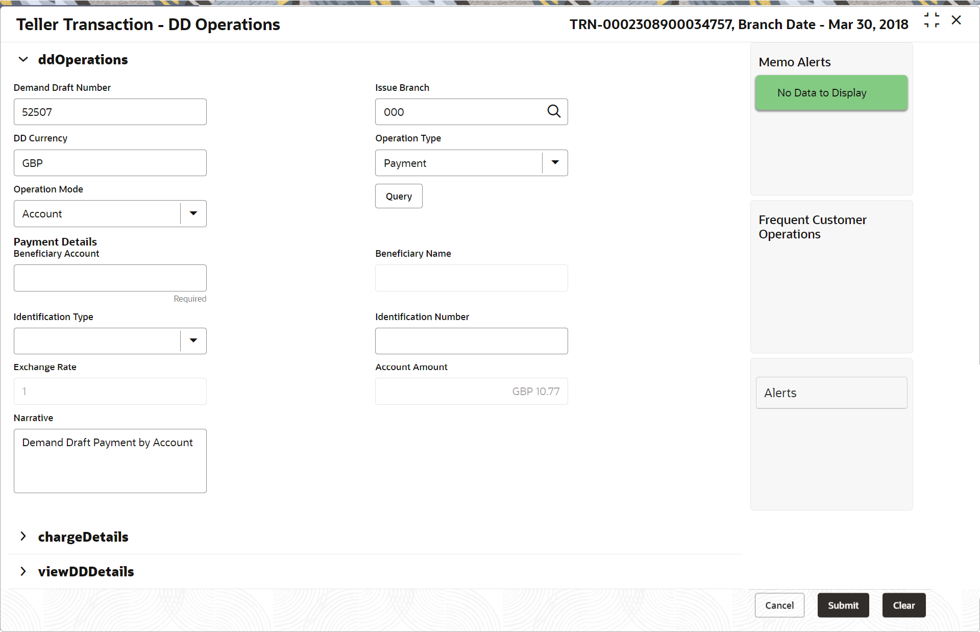

The Teller can use the DD Operations screen to make payment against a DD.
The DD payment is credited to the beneficiary customer account when the operation mode is Account.
To make payment against a DD:
  1. On the Homepage, from Teller mega menu, under Remittances, click DD Operations or specify DD Operations in the search icon bar and select the screen.
    The DD Operations screen is displayed.
    Figure 5-32 DD Operations - Payment by Account
  2. On the DD Operations screen, specify the fields. For more information on fields, refer to the field description table.

    Table 5-32 DD Operations (Payment by Account) - Field Description
    Field Description
    Operation Type
    Select the type Payment from the drop-down list.
    Demand Draft No
    Specify the DD number of the instrument.
    Issue Branch
    Select the branch code where the instrument is issued from the LOV.
    Operation Mode
    Select the operation mode as Account from the drop-down values.
    Payment Details
    Specify the details under this segment.
    Beneficiary Account
    Specify the beneficiary account number.
    Beneficiary Name
    Specify the beneficiary name.
    Identification Type
    Select the identification type of the beneficiary from the drop-down values.
    Identification Number
    Specify the identification number of the beneficiary.
    Exchange Rate
    Displays the exchange rate, and it can be modified.
    If the transaction currency is the same as the account currency, the system will display the exchange rate as 1. This field is displayed only if Multi-Currency Configuration at the Function Code Indicator level is set as Y.
    Account Amount
    Displays the account amount.
    Total Charge Amount
    Displays the total charge amount.
    This field is displayed only if Total Charges Configuration at the Function Code Indicator level is set as Y.
    Narrative
    Displays the default narrative as DD Operations, and it can be modified.
