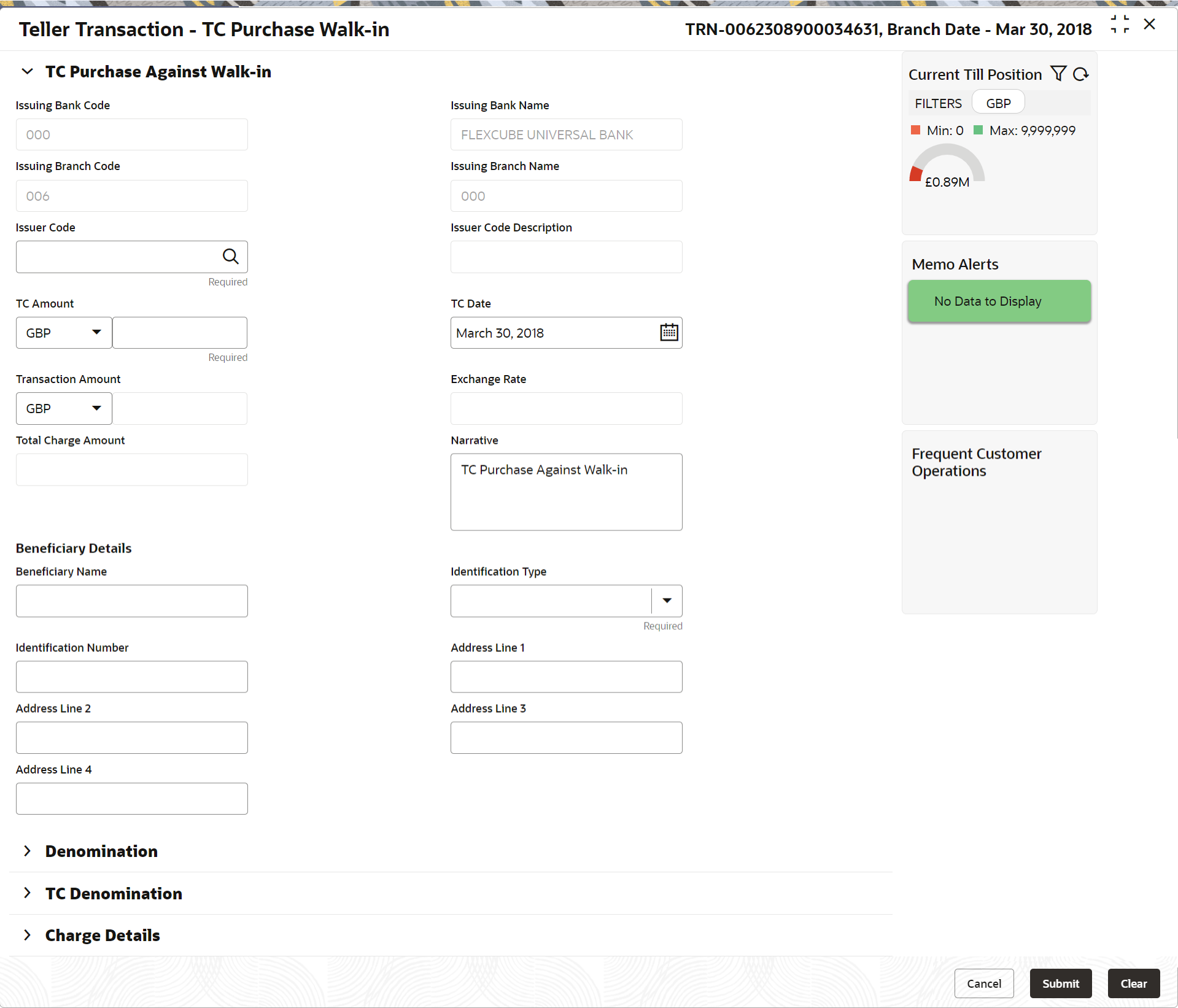

5.4.4 TC Purchase Against Walk-in
The Teller can use the TC Purchase Against Walk-in screen to purchase TC from a walk-in customer and pay out the equivalent amount in cash.
To purchase TC from a walk-in customer:
  1. On the Homepage, from Teller mega menu, under Remittances, click TC Purchase Against Walk-in or specify TC Purchase Against Walk-in in the search icon bar and select the screen.
    The TC Purchase Against Walk-in screen is displayed.
    Figure 5-63 TC Purchase Against Walk-in
  2. On the TC Purchase Against Walk-in screen, specify the fields. For more information on fields, refer to the field description table.
    The fields marked as Required are mandatory.

  3. Specify the denomination details. For information on the fields in the Denomination segment, refer to tc-purchase-against-walk.html.
  4. Specify the TC denomination details. For information on the fields in the TC Denominations segment, refer to tc-purchase-against-walk.html.
  5. Specify the charge details. For information on the fields in the Charge Details segment, refer to tc-purchase-against-walk.html.
  6. Click Submit.
    A teller sequence number is generated, and the Transaction Completed Successfully information message is displayed.
    The transaction is moved to authorization in case of any approval warning raised when the transaction saves.
