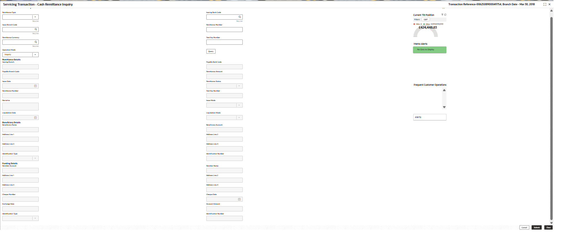

5.3.2.1 Cash Remittance Inquiry
The Teller can use the Cash Remittance Operations screen to inquire about the details of the issued cash remittance.
When you select the operation mode as Inquiry, the fields related to cash remittance inquiry will be displayed.
To inquire about the details of cash remittance:
- On the Homepage, from Teller mega menu, under
Remittances, click Cash Remittance
Operations or specify Cash Remittance
Operations in the search icon bar and select the screen.The Cash Remittance Operations screen is displayed.
- On the Cash Remittance Operations screen, specify the
fields. For more information on fields, refer to the field description
table.
The fields marked as Required are mandatory.Table 5-43 Cash Remittance Operations (Inquiry) - Field Description
Field Description Remittance Type Select the Remittance Type from the drop-down list.
RI = Remittance-Inward
RO = Remittance-Outward
Issuing Bank Code Specify the code of the issuing bank.
Issue Branch Code
Select the branch code where the cash remittance is issued from the LOV.
Operation Mode
Select the type Inquiry from the drop-down list.
Remittance No
Specify the cash remittance number.
Test Key No
Specify the test key number.Note:
This field is applicable only for the inter bank remittances.Query
Click this icon to fetch the cash remittance details.Note:
When you click this icon, after you specify the Issue Branch Code and Cash Remittance No, the system will make a service call to the Oracle Banking Payments and fetch the cash remittance details.Remittance Details
Displays the details of cash remittance under this segment.
Issue Branch
Displays the logged-in branch code.
Payable Bank Code
Displays the payable bank code for the cash remittance.
Payable Branch Code
Displays the payable branch code for the cash remittance.
Remittance Amount
Displays the currency and the amount of the cash remittance.
Issue Date
Displays the issue date mentioned in the cash remittance.
Remittance Status
Displays the status of the cash remittance.
Remittance No
Displays the cash remittance number.
Test Key No
Displays the test key number.
Narrative
Displays the default narrative as Cash Remittance Inquiry, and it can be modified.
Issue Mode
Displays the issue mode of the Cash Remittance.
Liquidation Date
Displays the liquidation date of Cash Remittance.
Liquidation Mode
Displays the liquidation mode of Cash Remittance.
Beneficiary Details
Specify the fields.
Beneficiary Name
Displays the beneficiary's name.
Beneficiary Account
Displays the beneficiary account number.
Address Line 1 to Address Line 4
Displays the address of the beneficiary.
Identification Type
Displays the identification type of the beneficiary.
Identification Number
Displays the identification number of the beneficiary.
Funding Details
Funding details are displayed under this segment.
Remitter Account
Displays the account number of the remitter.
Remitter Name
Displays the remitter name.
Cheque Number
Displays the cheque number.
Cheque Date
Displays the date mentioned in the cheque.
Exchange Rate
Displays the exchange rate.
Account Amount
Displays the amount that needs to be debited from the remitter account.
Identification Type
Displays the identification type of the remitter.
Displays the identification number of the remitter.
