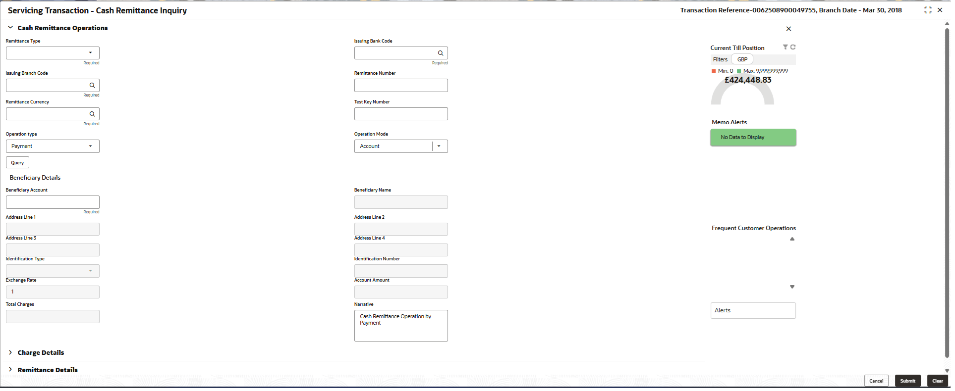

Figure 5-46 Cash Remittance Operations (Payment by Account)
- On the Cash Remittance Operations screen, specify the
fields. For more information on fields, refer to the field description
table.
The fields marked as Required are mandatory.Table 5-44 Cash Remittance Operations (Payment by Account) - Field Description
