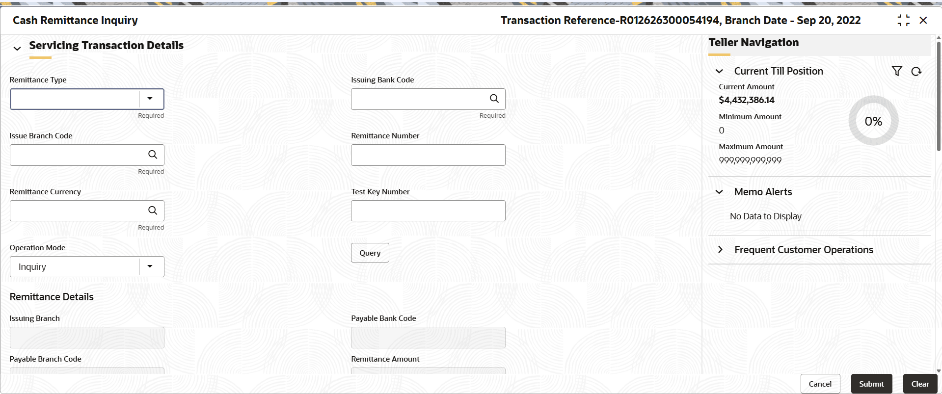

The Teller can use the Cash Remittance Operations screen to inquire about the details of the issued cash remittance.
When user select the operation mode as Inquiry, the fields related to cash remittance inquiry will be displayed.
To inquire about the details of cash remittance:
  1. On the Home page, from Teller mega menu, under Remittances, click Cash Remittance Operations or specify Cash Remittance Operations in the search bar and select the screen.
    The Cash Remittance Operations screen is displayed.
    Figure 5-52 Cash Remittance Inquiry
  2. On the Cash Remittance Operations screen, specify the fields. For more information on fields, refer to the field description table.
    The fields marked as Required are mandatory.
    Table 5-50 Cash Remittance Operations (Inquiry) - Field Description
    Field Description
    Remittance Type
    Select the Remittance Type from the drop-down list.
    RI = Remittance-Inward
    RO = Remittance-Outward
    Issuing Bank Code
    Specify the code of the issuing bank.
    Issue Branch Code
    Select the branch code where the cash remittance is issued from the LOV.
    Operation Mode
    Select the type Inquiry from the drop-down list.
    Remittance No
    Specify the cash remittance number.
    Test Key No
    Specify the test key number.
    Note: This field is applicable only for the inter bank remittances.
    Query
    Click Query button to fetch the cash remittance details.
    Note: When you click this icon, after user specify the Issue Branch Code and Cash Remittance No, the system will make a service call to the Oracle Banking Payments and fetch the cash remittance details.
    Remittance Details
    Displays the details of cash remittance under this segment.
    Issue Branch
    Displays the logged-in branch code.
    Payable Bank Code
    Displays the payable bank code for the cash remittance.
    Payable Branch Code
    Displays the payable branch code for the cash remittance.
    Remittance Amount
    Displays the currency and the amount of the cash remittance.
    Issue Date
    Displays the issue date mentioned in the cash remittance.
    Remittance Status
    Displays the status of the cash remittance.
    Remittance No
    Displays the cash remittance number.
    Test Key No
    Displays the test key number.
    Narrative
    Displays the default narrative as Cash Remittance Inquiry, and it can be modified.
    Issue Mode
    Displays the issue mode of the Cash Remittance.
    Liquidation Date
    Displays the liquidation date of Cash Remittance.
    Liquidation Mode
    Displays the liquidation mode of Cash Remittance.
    Beneficiary Details
    Specify the fields.
    Beneficiary Name
    Displays the beneficiary's name.
    Beneficiary Account
    Displays the beneficiary account number.
    Address Line 1 to Address Line 4
    Displays the address of the beneficiary.
    Identification Type
    Displays the identification type of the beneficiary.
    Identification Number
    Displays the identification number of the beneficiary.
    Funding Details
    Funding details are displayed under this segment.
    Remitter Account
    Displays the account number of the remitter.
    Remitter Name
    Displays the remitter name.
    Check Number
    Displays the Check number.
    Check Date
    Displays the date mentioned in the Check.
    Exchange Rate
    Displays the exchange rate.
    Account Amount
    Displays the amount that needs to be debited from the remitter account.
    Identification Type
    Displays the identification type of the remitter.
    Displays the identification number of the remitter.
