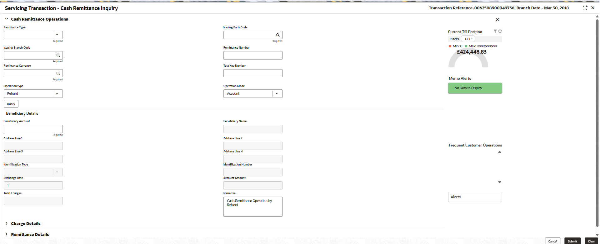

    Figure 5-53 Cash Remittance Operations (Refund by Account)
  2. On the Cash Remittance Operations screen, specify the fields. For more information on fields, refer to the field description table.
    The fields marked as Required are mandatory.
