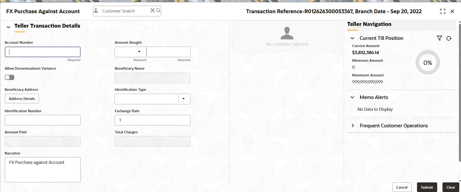

  1. On the Home screen, from Teller mega menu, under Customer TransactionForex Transactions, click FX Purchase - Account or specify FX Purchase - Account in the search icon bar and select the screen.
    The FX Purchase Against Account screen is displayed.
    Figure 7-10 FX Purchase Against Account
  2. On the FX Purchase Against Account screen, specify the fields. For more information on fields, refer to the field description table.

  3. Specify the charge details. For information on the fields in the Charge Details segment, refer to Charge Details.
  4. Specify the FX In Denomination details. For information on the fields in the Denomination Details segment, refer to Add Denomination Details.
  5. Click Submit.
    A teller sequence number is generated, and the Transaction Completed Successfully information message is displayed.
    The transaction is moved to authorization in case of any approval warning raised when the transaction saves. On transaction completion, the teller's cash position gets incremented based on the amount bought.
    In addition, the corresponding foreign currency cash is deposited for an equivalent amount of credit in the customer's account. For more information on transaction submission and validations, refer to Step 5 in Cash Deposit.
