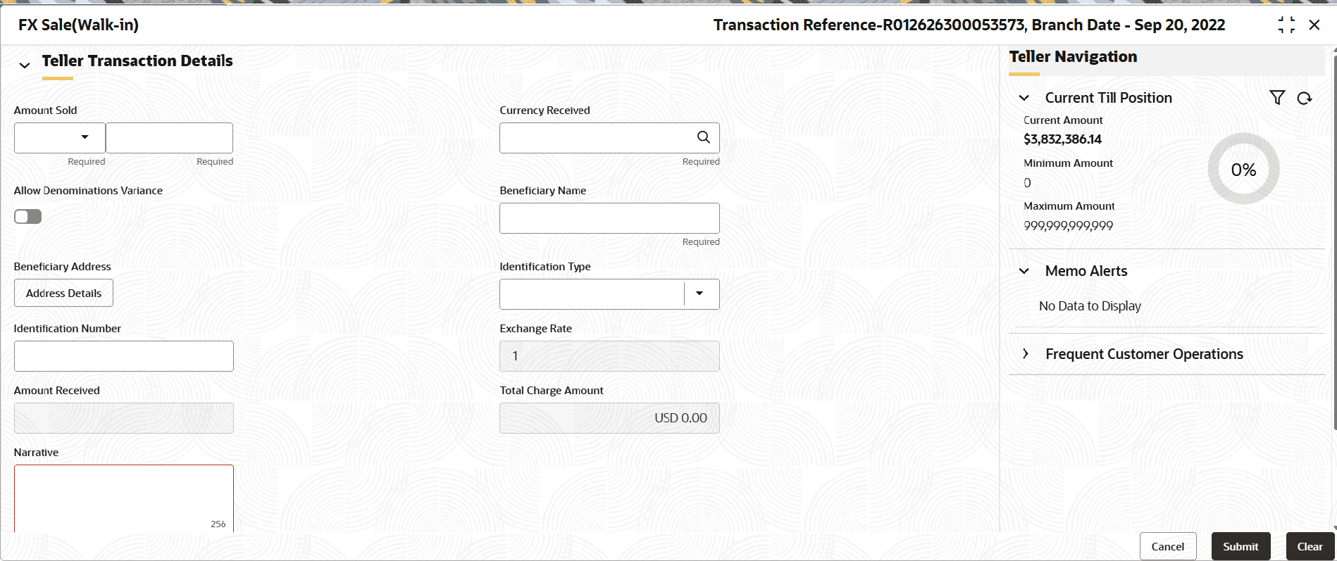

The FX Sale Against Walk-in screen is used to sell a foreign currency to a walk-in customer in return for the equivalent amount received in any other currency.
To sell a foreign currency to the walk-in customer:
  1. On the Home screen, from Teller mega menu, under Customer TransactionForex Transactions, click FX Sale - Walk-in or specify FX Sale - Walk-in in the search bar and select the screen.
    The FX Sale Against Walk-in screen is displayed.
    Figure 7-9 FX Sale Against Walk-in
  2. On the FX Sale Against Walk-in screen, specify the fields. For more information on fields, refer to the field description table.
    Table 7-7 FX Sale Against Walk-in - Field Description
    Field Description
    Amount Sold
    Select the applicable currency from the drop-down list and specify the amount that needs to be sold to the walk-in customer.
    Currency Received
    Select the currency that you have received from the customer in return for the currency sold. You can select the appropriate code from the adjoining option list that displays all the currency codes maintained in the system.
    Allow Denom Variance
    Select if the denomination-wise variance needs to be applied for the transaction.
    If the parameter at function code indicator is set as Y, this option will be selected by default, and it can be modified. If the parameter at the function code indicator is set as N, then this option will be disabled.
    Beneficiary Name
    Specify the name of the beneficiary customer.
    Beneficiary Address
    Click Address Details button to view customer address.
    For the field-level description of the customer address, see Address Details.
    Identification Type
    Select the type of identification provided by the customer from the drop-down list.
    Identification Number
    Specify the identification number provided by the customer.
    Exchange Rate
    Displays the exchange rate used to convert the transaction currency into account currency, and it can be modified.
    This field is displayed only if Multi-Currency Configuration at Function Code Indicator level is set as Y.
    Negotiated Exchange Rate
    Specify the negotiated exchange rate that should be used for foreign currency transactions between the treasury and the branch.
    This field is applicable only if the transaction involves cross currency and only if cross currency enabled and Negotiated_Rate_Enabled Configuration at Function Code Indicator level is set as Y.
    Negotiated Reference Number
    Specify the unique reference number that should be used for negotiation of cost rate, in foreign currency transaction. If you have specified the negotiated cost rate, then you need to specify the negotiated reference number also.
    Accounting system books the online revaluation entries based on the difference in exchange rate between the negotiated exchange rate and transaction rate.
    Amount Received
    Displays the amount received and currency from the customer. The received amount includes charges.
    The currency of the amount received will be defaulted from Currency Received. The amount received will be calculated based on the Amount Sold and the Exchange Rate. This field is displayed only if Multi-Currency Configuration at Function Code Indicator level is set as Y.
    Total Charges
    Displays the total charge amount, which is computed by the system in the local currency of the branch.
    This field is displayed only if Total Charges Configuration at Function Code Indicator level is set as Y.
    Narrative
    Displays the default narrative as FX Sale (Walk-in), and it can be modified.
