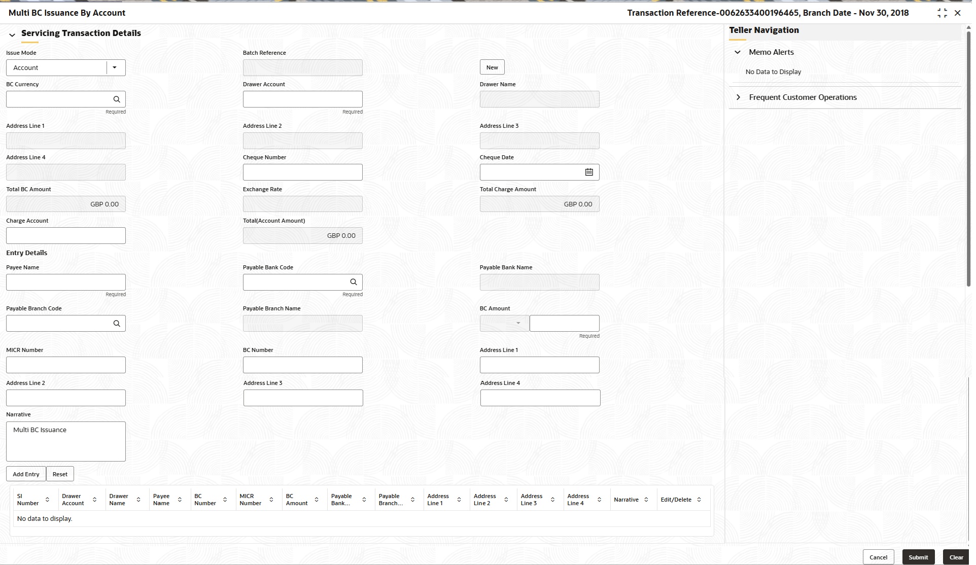

5.1.6.1 Multi BC Issuance Against Account
The Teller can use the Multi BC Issuance screen to issue BCs against multiple beneficiaries for a single remitter account.
To issue BC against multiple beneficiaries:
  1. On the Homepage, from Teller mega menu, under Remittances, click Multi BC Issuance or specify Multi BC Issuance in the search icon bar and select the screen.
    The Multi BC Issuance Account screen is displayed.
    Figure 5-20 Multi BC Issuance - Account
  2. On the Multi BC Issuance Account screen, specify the fields. For more information on fields, refer to the field description table.
    The fields marked as Required are mandatory.
