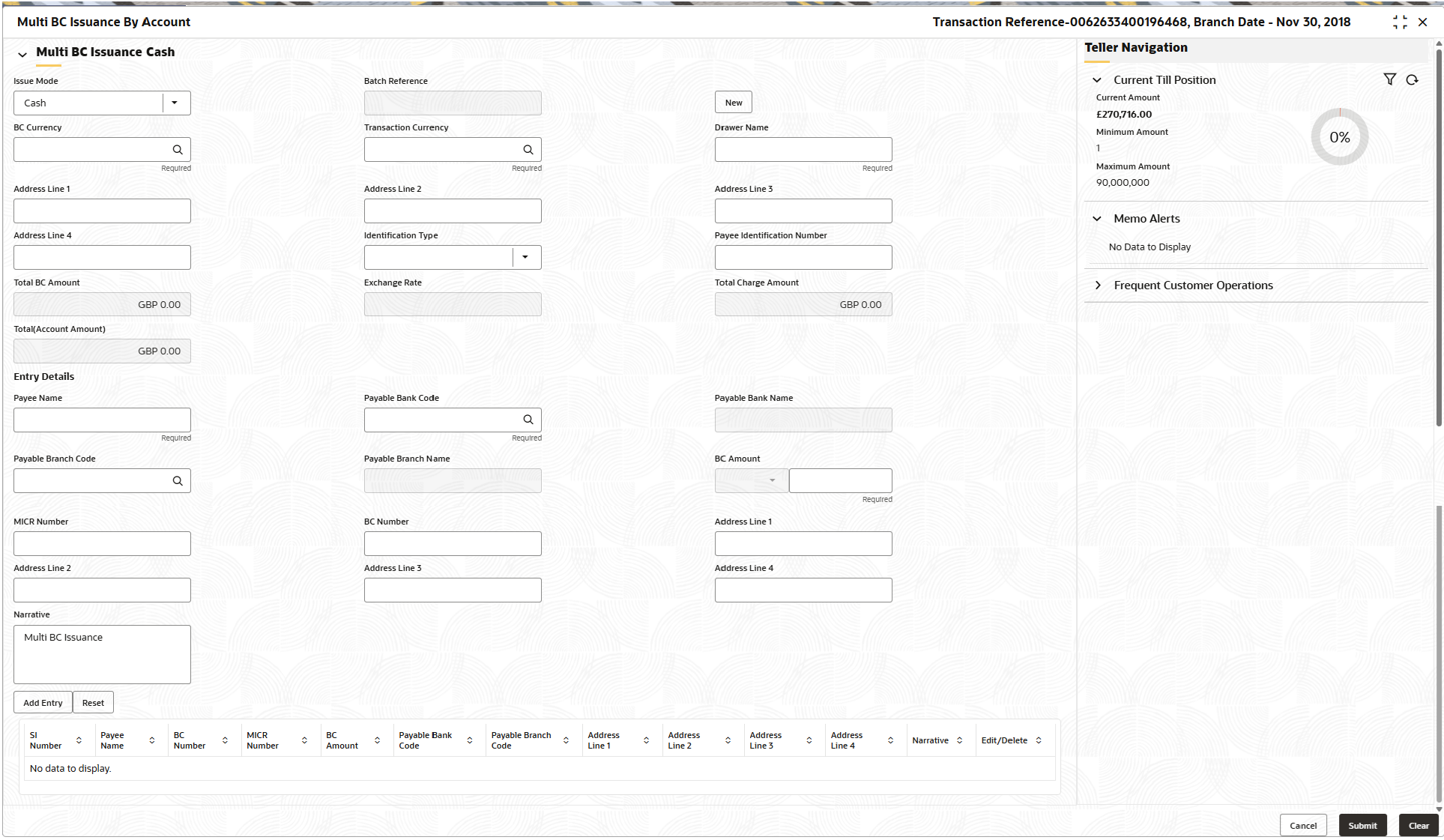

    The Multi BC Issuance Cash screen is displayed.
    Figure 5-21 Multi BC Issuance Cash
  2. On the Multi BC Issuance Cash screen, specify the fields. For more information on fields, refer to the field description table.
    The fields marked as Required are mandatory.
    Table 5-21 Multi BC Issuance Cash - Field Description
    Field Description
    New
    Click New to generate a batch reference number.
    Batch Reference
    Displays the auto-generated batch reference number.
    BC Currency
    Select the BC currency from the list of values.
    Issue Mode
    Select the issue mode as Cash from the drop-down values.
    Transaction Currency
    Select the transaction currency from the list of values.
    Drawer Name
    Specify the name of the drawer.
    Address Line 1 to Address Line 4
    Specify the address of the drawer.
    Identification Type
    Select the identification type from the drop-down values.
    Payee Identification Number
    Specify the identification number of the Payee.
    Total BC Amount
    Displays the total sum of the multiple BC amount inputs, which is computed by the system.
    Exchange Rate
    Displays the exchange rate, and it can be modified.
    If the transaction currency is the same as the account currency, the system will display the exchange rate as 1. This field is displayed only if Multi-Currency Configuration at Function Code Indicator level is set as Y.
    Total Charge Amount
    Displays the total charge amount.
    This field is displayed only if Total Charges Configuration at Function Code Indicator level is set as Y.
    Total (Account Amount)
    Displays the total amount available in the specified charge account.
    Entry Details
    Specify the fields.
    Payee Name
    Specify the payee name.
    Payable Bank Code
    Select the payable bank code from the list of values.
    Payable Bank Name
    Displays the bank name of the specified payable bank code.
    Payable Branch Code
    Select the payable branch code from the list of values.
    Payable Branch Name
    Displays the bank name of the specified payable branch code.
    BC Amount
    Specify the BC amount and currency.
    MICR Number
    Specify the MICR number.
    BC Number
    Specify the BC number.
    Specify the address of the payee.
    Narrative
    Displays the default narrative as Multi BC Issuance, and it can be modified.
    Add Entry
    After filling the necessary fields, click Add Entry to add a new entry.
    Reset
    Click Reset to reset the added entries.
