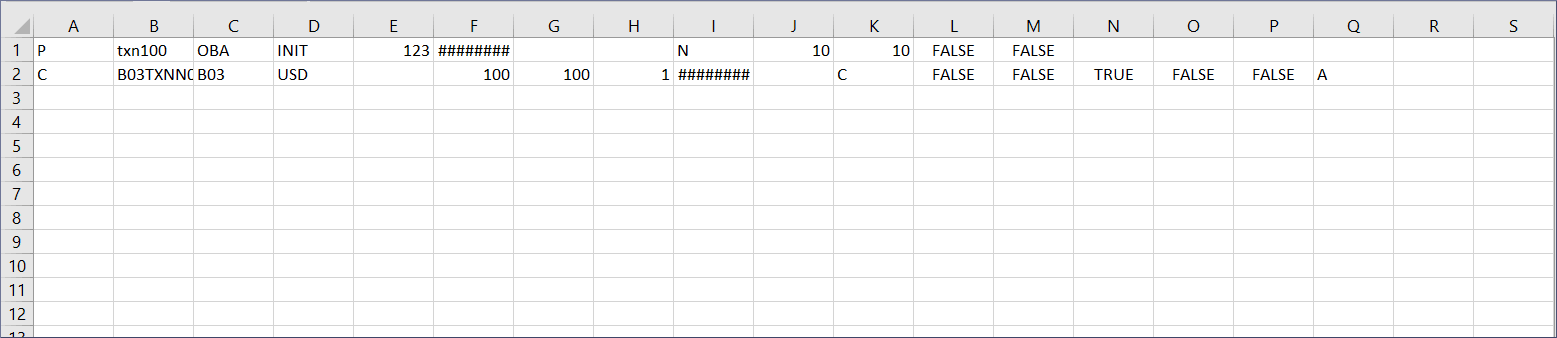

    The following image shows a sample CSV file with a parent and child record.

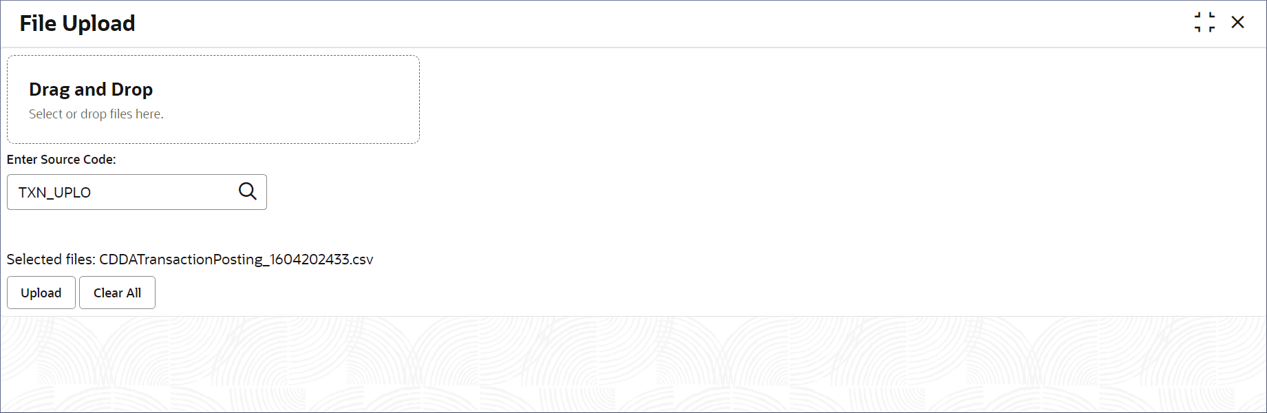

  3. Validate the file and then upload it, by following the steps below:
    1. Click File Management, and under File Management, click File Upload.
      The File Upload page displays.
      Figure 5-26 Transaction File Upload
    2. Drag and drop the required CSV file(s) into the Drag and Drop field. Alternatively, click the field, and navigate to and open the selected file(s).
      The message Selected files: <filename.csv> displays above the Upload button.
    3. Click Enter Source Code field and select TXN_UPLOAD from the list of values.
      For more information, see Upload Source in the Oracle Banking Common Core User Guide.
    4. Click Upload.
      The File Upload Status dialog displays the file upload initiation message.
      At this point the uploaded file(s) and the transaction records in them are not processed.
    5. Click Clear ALL.
      The system clears the uploaded file and Source Code fields, and the page is ready to upload more files.
