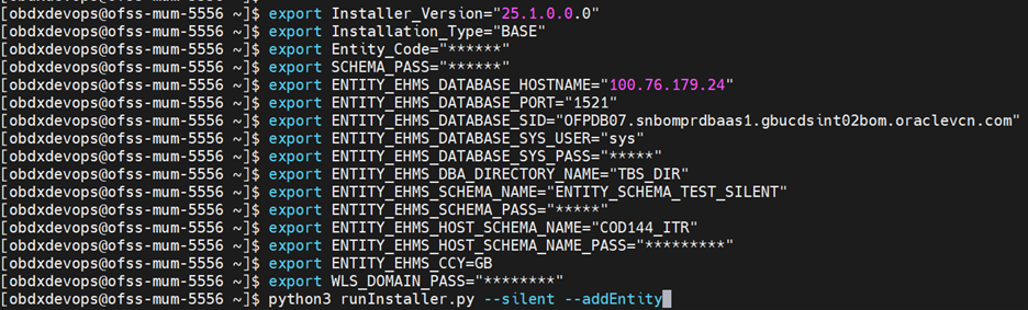

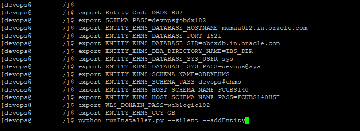

- Set the environment variables, as shown below.
Below parameters should be set in environment variables
Environment variables Parameter Description Example Environment variables to set for flavor:
FCORE UBS (14.6.0.0.0 release)
OBPM (14.6.0.0.0 release)
Entity_Code
Entity code which has been entered from screen export Entity_Code=OBDX_BU7
SCHEMA_PASS
Password for existing OBAPI schema export SCHEMA_PASS=devops#obapi182
ENTITY_EHMS_DATABASE_HOSTNAME
Hostname of the EHMS HOST database host server export ENTITY_EHMS_DATABASE_HOSTNAME=xx.xx.xx.xx
ENTITY_EHMS_DATABASE_PORT
Port of the EHMS HOST database host server export ENTITY_EHMS_DATABASE_PORT=1521
ENTITY_EHMS_DATABASE_SID
EHMS Host database Service Name ENTITY_EHMS_DBA_DIRECTORY_NAME
Oracle Directory name in which you want the EHMS (HostInterface) schema datafile (dbf). Enter only the name and NOT the path export ENTITY_EHMS_DBA_DIRECTORY_NAME=TBS_DIR
ENTITY_EHMS_DATABASE_SYS_USER
Username with 'sys' privileges export ENTITY_EHMS_DATABASE_SYS_USER=sys
ENTITY_EHMS_DATABASE_SYS_PASS
Password for EHMS sys user export ENTITY_EHMS_DATABASE_SYS_PASS=devops@sys
ENTITY_EHMS_SCHEMA_NAME
Complete EHMS (HostInterface) schema name you want installer to create as new schema. export ENTITY_EHMS_SCHEMA_NAME=OBAPIEHMS
ENTITY_EHMS_SCHEMA_PASS
Password for new EHMS schema on EHMS HOST database export ENTITY_EHMS_SCHEMA_PASS=devops#ehms
ENTITY_EHMS_HOST_SCHEMA_NAME
EXISTING EHMS Host schema name export ENTITY_EHMS_HOST_SCHEMA_NAME=EHMSHOST
ENTITY_EHMS_HOST_SCHEMA_NAME_PASS
**This parameter is only required for UBS & OBPM HostPassword of existing HOST EHMS schema (Existing) export ENTITY_EHMS_HOST_SCHEMA_NAME_PASS=ehmshst
WLS_DOMAIN_PASS
Password for Weblogic admin console export WLS_DOMAIN_PASS=weblogic182
ENTITY_EHMS_CCY
**This parameter is only required for UBS & OBPM HostCountry Code for new or additional entity home branch export ENTITY_EHMS_CCY=GB
ENTITY_EHMS_FCORE_FCUBS_SCHEMA_NAME
**This parameter is only required for FCOREFCORE-FCUBS HOST schema name export ENTITY_EHMS_FCORE_FCUBS_SCHEMA_NAME=FCRUBSHOST
OBAPI (Third-party HOST)Entity_Code
Entity code which has been entered from screen export Entity_Code=OBDX_BU1
SCHEMA_PASS
Password for existing OBAPI schema export SCHEMA_PASS=welcome1
- Run the runInstaller.py file with ‘--silent ’ argument along
with ‘--addEntity’.

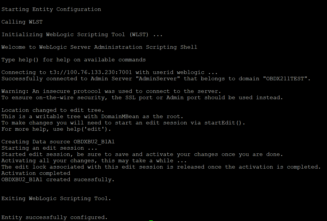

Installation Status in case of Oracle FLEXCUBE Core Banking, Oracle FLEXCUBE Universal Banking, Oracle FLEXCUBE Universal Banking with Oracle Banking Payments
After entering all required details, the status is displayed (as shown below) on the terminal to indicate the progress of the installation.
When the installation completes, the below message is displayed

- Installation Status in case of other hosts as Add Entity
