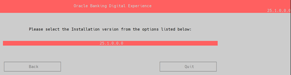

From your terminal navigate to <OBAPI INSTALLER DIR>
Enter the following command
python3 runInstaller.py

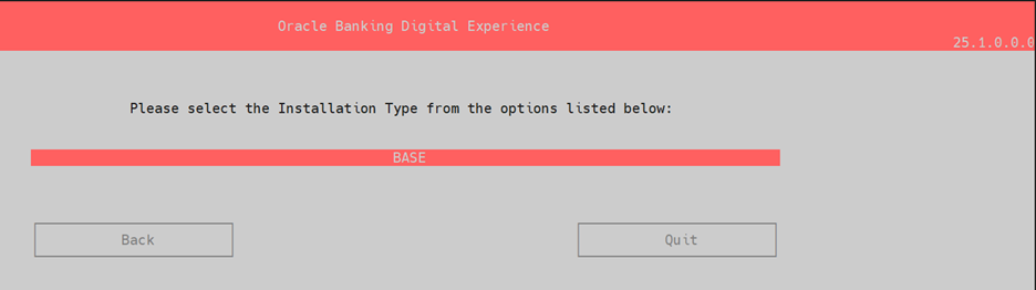

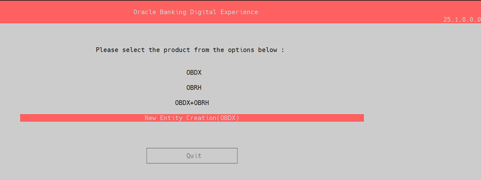

Select installation type as ‘New Entity Creation’.
Below screen will appear after selecting add entity.

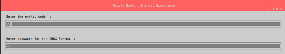

Enter below information:
  • Entity code which has been added from screen
  • OBAPI schema password

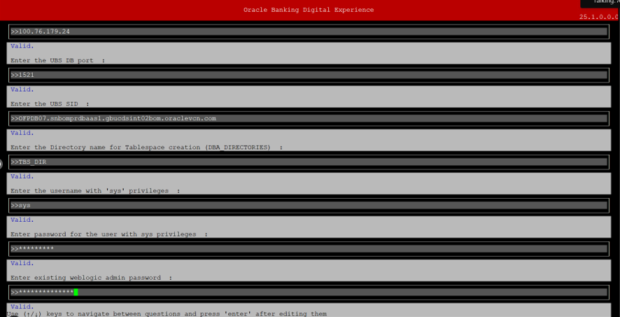

If an entity code belongs to UBS / OBPM host following screen (below screenshot are for OBPM ; for UBS same input are required) will appear:
Enter below details:
  • Hostname of the database host server
  • Port of the database host server
  • Host database Service Name
  • Oracle directory name in which you want the database datafile (dbf) to be created. Enter only the name NOT the path.
  • Username with 'sys' privileges
  • SYS privilege user password where UBS schema would be created
  • Weblogic console administrator user password

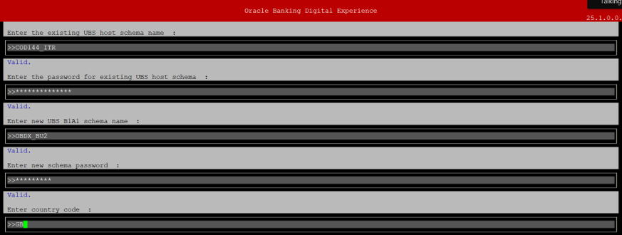

  • EXISTING Host schema name
  • Password for EXISTING schema
  • Complete EHMS (HostInterface) schema name you want installer to create as new schema
  • Password for New schema
  • Country Code of entity branch

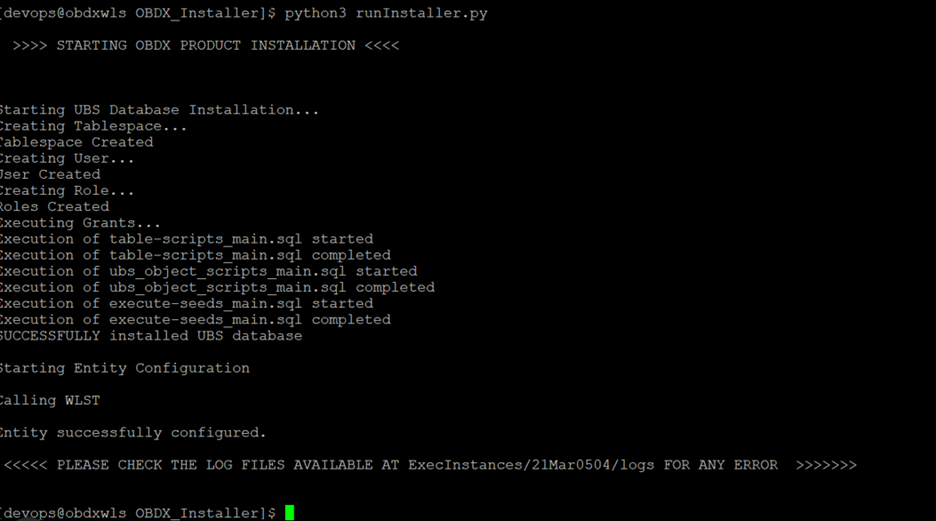

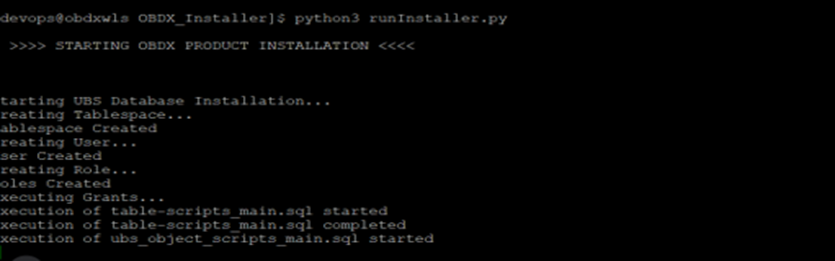

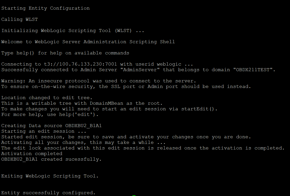

Installation Status in case of UBS / OBPM
After entering all required details, the status is displayed (as shown below) on the terminal to indicate the progress of the installation.
When the installation completes, the below message is displayed
Post successful installation refer to Section 8: Post Installation steps for manual steps to be performed for UBS additional entity (sub-section : Oracle FLEXCUBE Universal Banking (OBAPI with UBS)).
No additional steps/ configuration are required.
