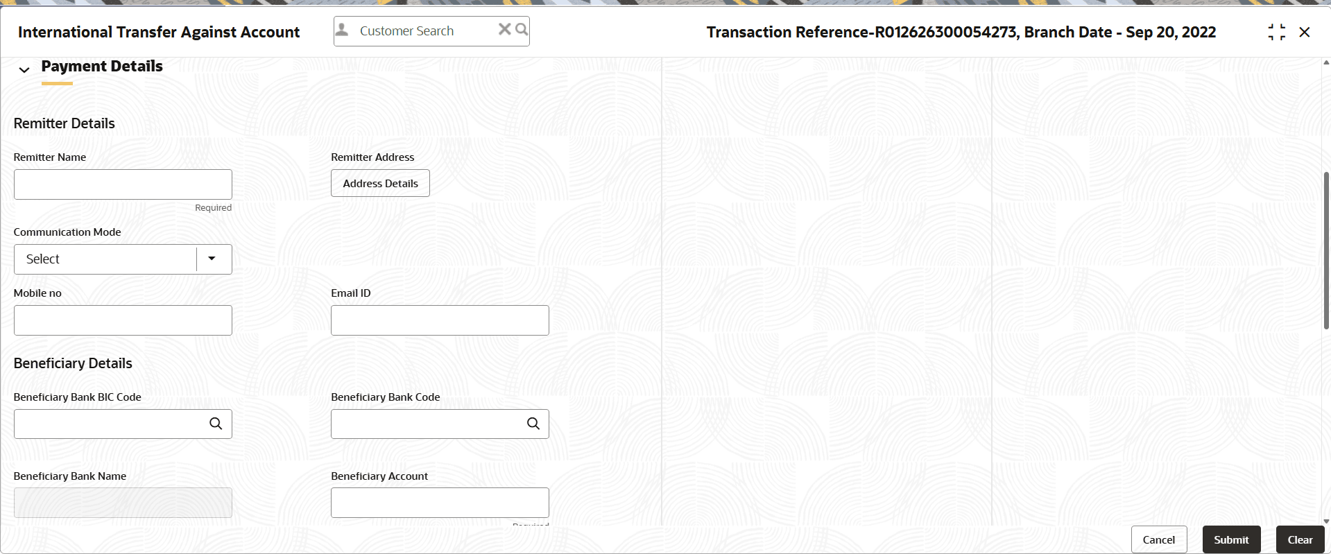

3.5.1 Add Payment Details for International Transfer
User can add the payment details for the international transfer in the Payment Details data segment.
Make sure that the transaction details are added to the screen.
To add the payment details:
On the Payment Details data segment, specify the fields. For more information on fields, refer to the field description table.
The fields marked as Required are mandatory.

Remitter Details
Specify the fields.
Remitter Name
Displays the remitter description based on the remitter account number specified.
Remitter Address
Click Address Details button to view the customer address details.
For the field-level description of the customer address, see Address Details.
