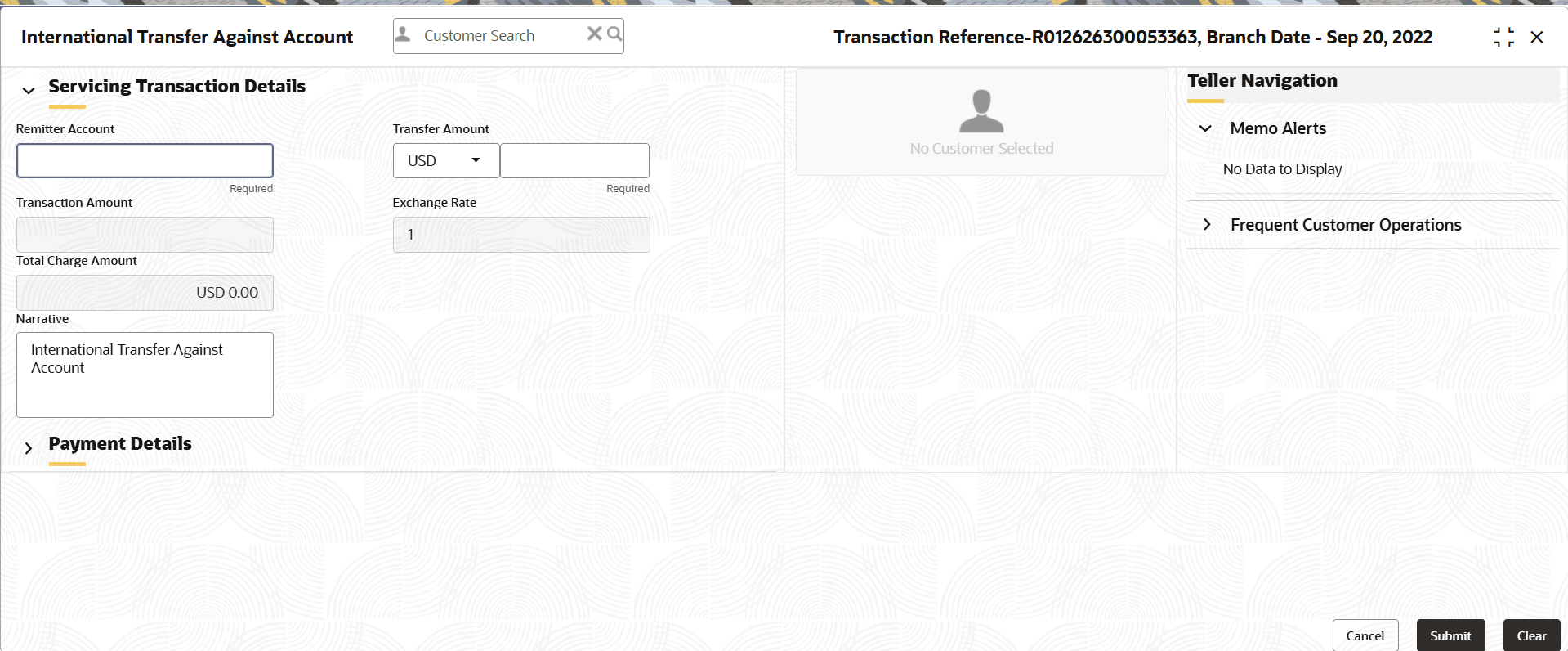

    Figure 3-6 International Transfer Against Account
  2. On the International Transfer Against Account screen, specify the fields. For more information on fields, refer to the field description table.

    Table 3-6 International Transfer Against Account - Field Description
    Field Description
    Remitter Account
    Specify the customer account from which the funds need to be debited.
    Transfer Amount
    Specify the transfer account currency and the transfer amount that needs to be debited from the customer account.
    Transaction Amount
    Displays the remitter account currency based on the account number selected and the transaction amount based on the exchange rate.
    Note: This field is displayed only if Multi-Currency Configuration at the Function Code Indicator level is set as Y.
    Exchange Rate
    Displays the exchange rate used to convert the transfer account currency into credit account currency, and it can be modified.
    Note: If the transfer currency is the same as the account currency, the system displays the exchange rate as 1. This field is displayed only if Multi-Currency Configuration at the Function Code Indicator level is set as Y.
    Negotiated Exchange Rate
    Specify the negotiated exchange rate that should be used for foreign currency transactions between the treasury and the branch. User need to specify the negotiated exchange rate only when the currencies involved in the transaction are different.
    Note: This field is applicable only if the transaction involves cross currency and only if cross currency enabled and Negotiated_Rate_Enabled Configuration at Function Code Indicator level is set as Y.
    Negotiated Reference Number
    Specify the unique reference number that should be used for negotiation of cost rate, in foreign currency transaction. If user have specified the negotiated cost rate, then user need to specify the negotiated reference number also.
    Note: Accounting system books the online revaluation entries based on the difference in exchange rate between the negotiated exchange rate and transaction rate.
    Total Charge Amount
    Displays the total charge amount, which is computed by the system.
    Note: This field is displayed only if Total Charges Configuration at the Function Code Indicator level is set as Y.
    Narrative
    Displays the default narrative as International Transfer Against Account, and it can be modified.
