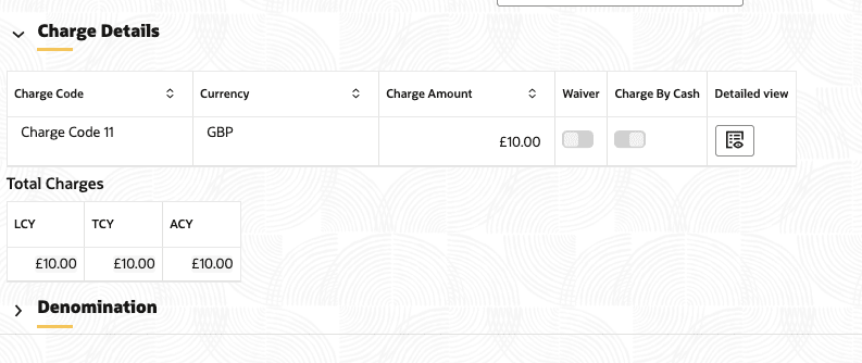

7.1.1 Charge Details
The Charge Details segment is used to view the computed charge details based on the charge maintenance defined for the function code.
Make sure that the charge details data segment are added to the transaction screen.
This segment is applicable for all Financial Customer transactions. If no charge is maintained for the combination, then the transaction is saved without any charges.
User can view or waive the computed charges. For more information on fields, refer to the field description table.
Table 7-2 Charge Details - Field Description
Field Description
Charge Code
The system defaults the charge components applicable to the transaction.
Currency
Displays the currency in which the charge has to be deducted.
Charge Amount
Displays the charge amount that needs to be deducted for the corresponding charge component.
The charge amount can be modified only if the field is enabled in the Function Code Preferences screen. The modified charge amount will be validated against the minimum and maximum charge amount that can be configured at the Charge Maintenance screen. When an individual charge amount is modified, the system will recalculate all the dependent charges.
Waiver
If necessary, check this box against the charge component to waive a certain charge for the customer.
When the Waiver is enabled, the value under Charge Amount will be waived and no charge accounting entries will be passed. The charge waiver can be enabled at individual charge level without impacting other linked charges. The minimum charge amount configured at the charge maintenance level, will not be validated when the charge is waived.
Charge By Cash
Indicates whether the charges are to be collected by cash.
Total Charges
Displays the total charges in branch local currency (LCY) and transaction currency (TCY) and Account Currency(ACY).
Detailed View
Displays the following charge details of each charge code:
  • Charge Code
  • Currency
  • Charge Amount
  • Waiver
  • Charge By Cash
  • Charge TCY
  • Charge LCY
  • Basis
  • Min Charge
  • Max Charge
  • Price Rule Id
  • Credit Account
  • Debit Account
  • Charge ACY
On clicking the Detailed View charge icon, a panel drawer opens displaying the existing details for this icon.
