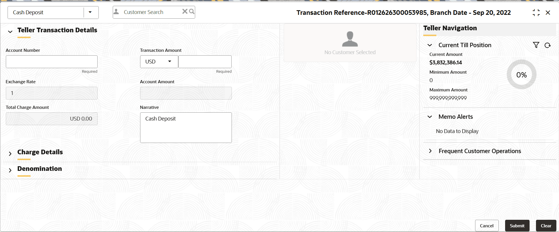

The Cash Deposit screen is used to deposit the cash in a CASA. Cash can be deposited in either account currency or any foreign currency that is allowed.
Whenever any transaction in foreign currency is posted to the account, it is converted to the account currency based on the maintained exchange rate for the transaction.

  1. On the Home screen, click Teller. On the Teller Mega Menu, under Customer Transaction, click Cash Deposit or specify the Cash Deposit in the search icon bar.
    The Cash Deposit screen is displayed.
  2. On the Cash Deposit screen, specify the fields. For more information on fields, refer to the field description table.

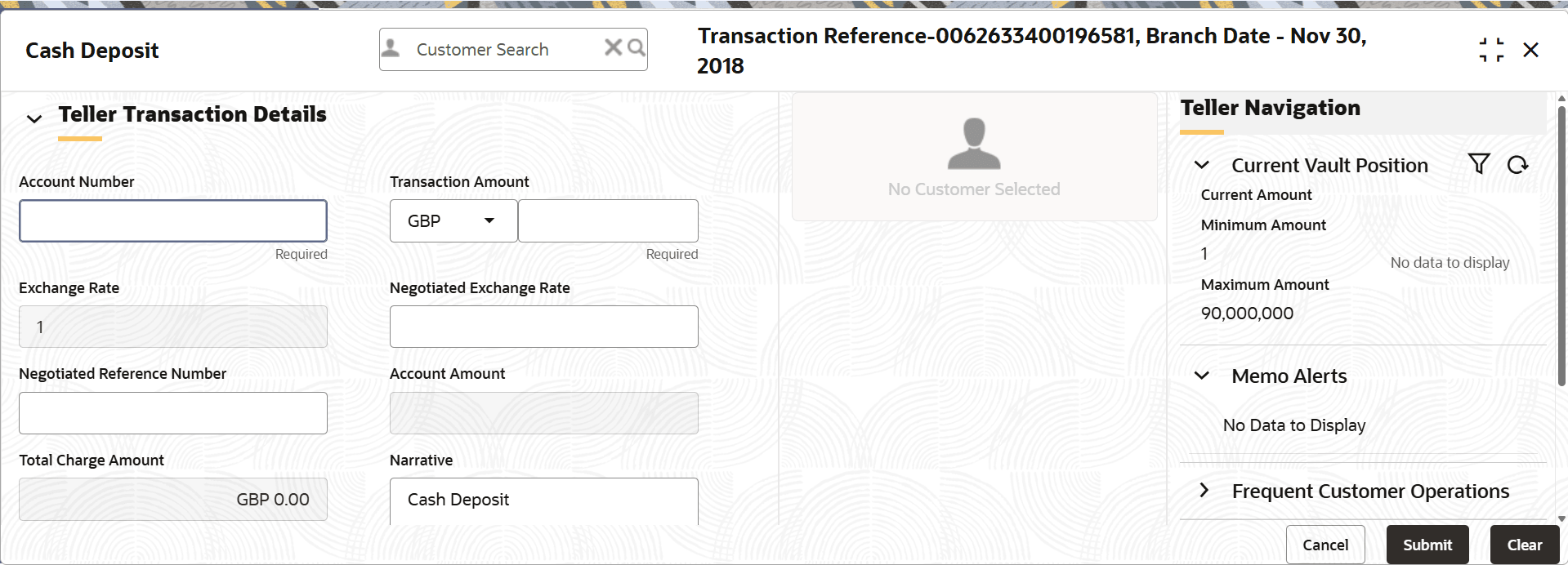

    Account Number Specify a valid account number for the customer. When you press the Tab key, the corresponding account information will be displayed in the Customer Information widget.
    The system displays an override or error message on the tab out of Account Number based on the account dormancy parameters.
    Transaction Amount
    Displays the local currency of the branch. You can also select other transaction currencies from the drop-down values.
    Specify the transaction amount that needs to be credited to the customer account.
    Exchange Rate
    Displays the exchange rate used to convert the transaction currency into account currency and it can be modified.
    If the transaction currency is the same as the account currency, the system displays the exchange rate as 1. This field is displayed only if Multi-Currency Configuration at Function Code Indicator level is set as Y.
    Negotiated Exchange Rate
    Specify the negotiated exchange rate that should be used for foreign currency transactions between the treasury and the branch. You need to specify the negotiated exchange rate only when the currencies involved in the transaction are different.
    This field is applicable only if the transaction involves cross currency and only if cross currency enabled and Negotiated_Rate_Enabled Configuration at Function Code Indicator level is set as Y.
    Negotiated Reference Number
    Specify the unique reference number that should be used for negotiation of cost rate, in foreign currency transaction. If you have specified the negotiated cost rate, then you need to specify the negotiated reference number also.
    Account Amount
    Displays the transaction amount converted in terms of account amount based on the exchange rate.
    Total Charge Amount
    Displays the total charge amount, which is computed by the system in the local currency of the branch.
    This field is displayed only if Total Charges Configuration at Function Code Indicator level is set as Y.
    Narrative Displays the default narrative as Cash Deposit, and it can be modified.
