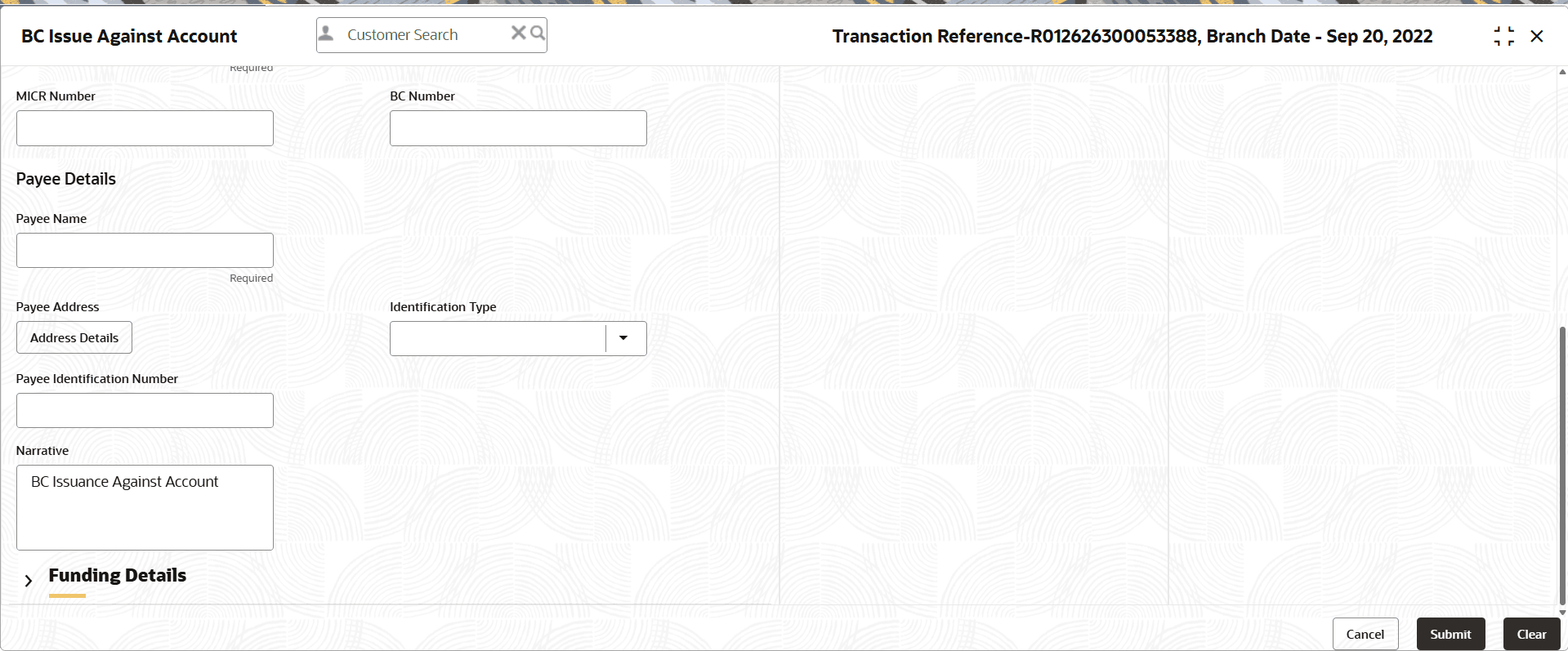

5.1.1 BC Issue Against Account
The Teller can use the BC Issue Against Account screen to issue a BC against the CASA of a customer.
To issue a BC against the savings account:
  1. On the Home page, from Teller mega menu, under Remittances, click BC Issue - Account or specify BC Issue - Account in the search bar and select the screen.
    The BC Issue Against Account screen is displayed.
    Figure 5-1 BC Issue Against Account
  2. On the BC Issue Against Account screen, specify the fields. For more information on fields, refer to the field description table.
    The fields marked as Required are mandatory.

    MICR Number Specify the MICR number and validate. If not specified, the system generates the MICR number based on the maintenance setup.
    BC Number Specify the BC number.
    Payee Details This section displays the following fields.
    Payee Name Specify the payee name on which the BC is drawn.
    Payee Address Click Address Details button to view the customer address.
    For the field-level description of the customer address, see Address Details.
    Identification Type Select the identification type of the payee from the drop-down list.
    Payee Identification Number Specify the identification number of the payee.
    Narrative Displays the default narrative as BC Issuance Account, and it can be modified.
