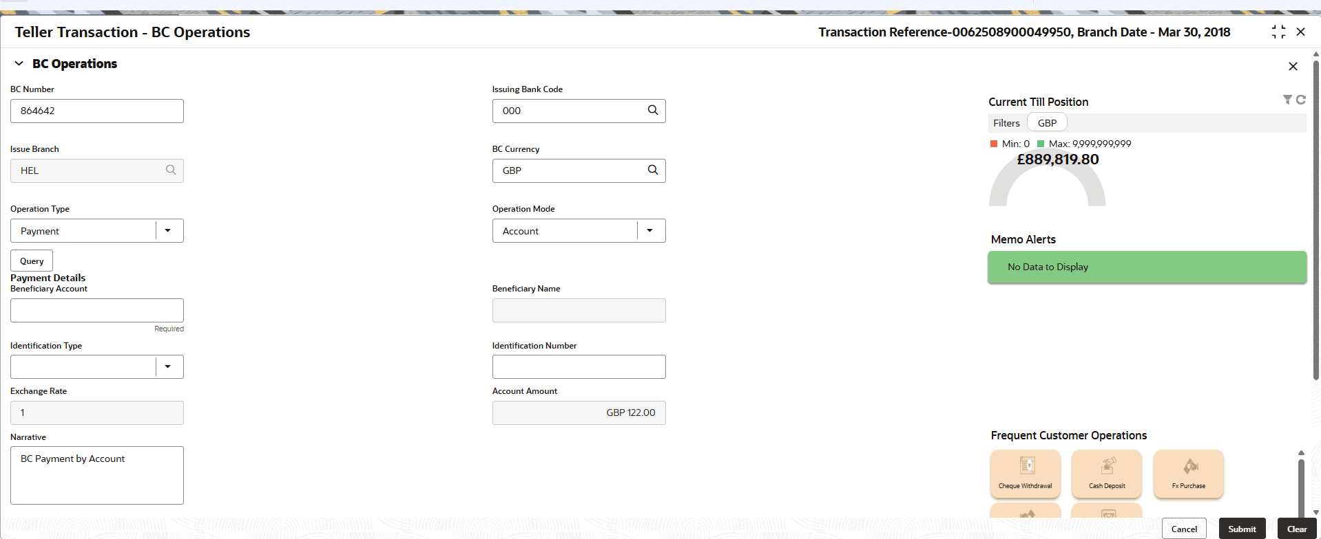

  1. On the Home page, from Teller mega menu, under Remittances, click BC Operations or specify BC Operations in the search bar and select the screen.
    The BC Operations screen is displayed.
    Figure 5-13 BC Operations - Payment by GL
  2. On the BC Operations screen, specify the fields. For more information on fields, refer to the field description table.
    The fields marked as Required are mandatory.

  3. Specify the charge details. For information on the fields in the Charge Details segment, refer to Charge Details.
  4. Click on the View BC Details data segment to view the additional details of the BC.
    This data segment is non-editable.
  5. Click Submit.
    A teller sequence number is generated, and the Transaction Completed Successfully information message is displayed.
    The transaction is moved to authorization in case of any warning raised when the transaction saves.
    On transaction submission, the system will hand off the details to the payments product processor (Oracle Banking Payments) for processing. When user get a success notification from Oracle Banking Payments, the system will update the transaction status as Success and mark for charges accounting hand off. In case of reject notification from the Oracle Banking Payments, the system will discard the transaction.
    If the payment transaction needs to be reversed then the same has to be invoked from SJ log.
