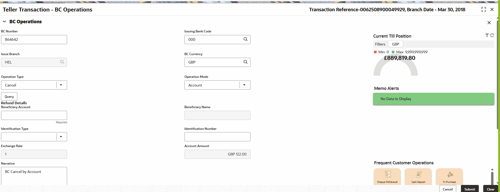

5.1.5.12 Cancel BC by GL
The Teller can use the BC Operations screen to cancel a BC.
The BC cancellation amount is credited to the GL account when the operation mode is GL.
To cancel a BC:
  1. On the Home page, from Teller mega menu, under Remittances, click BC Operations or specify BC Operations in the search bar and select the screen.
    The BC Operations screen is displayed.
    Figure 5-19 BC Operations - Cancel by GL
  2. On the BC Operations screen, specify the fields. For more information on fields, refer to the field description table.
    The fields marked as Required are mandatory.
    Table 5-19 BC Operations (Cancel by GL) - Field Description
    Field Description
    BC Number
    Specify the BC number of the instrument.
    Issuing Bank Code
    Specify the code of the issuing bank.
    Issue Branch
    Select the branch code where the instrument is issued from the LOV.
    BC Currency
    Specify BC Currency to query instrument details.
    Operation Type
    Select the type Cancel from the drop-down list.
    Operation Mode
    Select the operation mode as GL from the drop-down values.
    Cancel Details
    Specify the details under this segment.
    GL Account
    Specify the GL account number.
    GL Currency
    Displays the currency of the specified GL account.
    GL Branch
    Displays the branch code of the specified GL account.
    Exchange Rate
    Displays the exchange rate, and it can be modified.
    Note: If the transaction currency is the same as the account currency, the system will display the exchange rate as 1. This field is displayed only if Multi-Currency Configuration at the Function Code Indicator level is set as Y.
    Account Amount
    Displays the account amount.
    Note: This field is displayed only if Multi-Currency Configuration at the Function Code Indicator level is set as Y.
    Total Charge Amount
    Displays the total charge amount.
    Note: This field is displayed only if Total Charges Configuration at Function Code Indicator level is set as Y.
    Narrative
    Displays the default narrative as BC Cancel by GL, and it can be modified.
  3. Specify the charge details. For information on the fields in the Charge Details segment, refer to Charge Details.
  4. Click on the View BC Details data segment to view the additional details of the BC.
    This data segment is non-editable.
  5. Click Submit.
    A teller sequence number is generated, and the Transaction Completed Successfully information message is displayed.
    The transaction is moved to authorization in case of any warning raised when the transaction saves.
